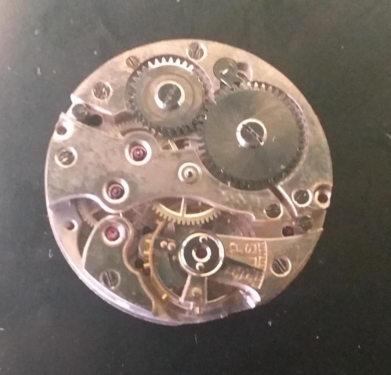

Hi i need some help to identify this movement, it has the fhf/font symbol but no number it is 10 1/2''' i am trying to find a new stem for it but appear to be going round in circles. Any help would be much appreciated. Thanks in advance

i went onto ranfft the back is different so was unsure if that made a difference to the stem.
do you mean like the back layout of the plates are a little bit different? As long as the wheels are in the right place in the watch more or less looks right it should probably be the same thing. Often times the movements get modified a little bit. Like you might have finger bridges over each the wheels or some other times it might be a much bigger bridge
oh the other thing to do is it suggested there were equal to other watches go a look up the other watches see what they look like
http://www.ranfft.de/cgi-bin/bidfun-db.cgi?10&ranfft&0&2uswk&Bulova_10AE
then here's a listing of stems compatible with yours. I don't suppose even have a partial love your original stem because if you did we could measure the dimensions and see if they compare to this stem
http://cgi.julesborel.com/cgi-bin/matcgi2?ref=V\ZDXK\[

The FHF Font 1146 obviously was produced with different bridge designs. I found this 😉
