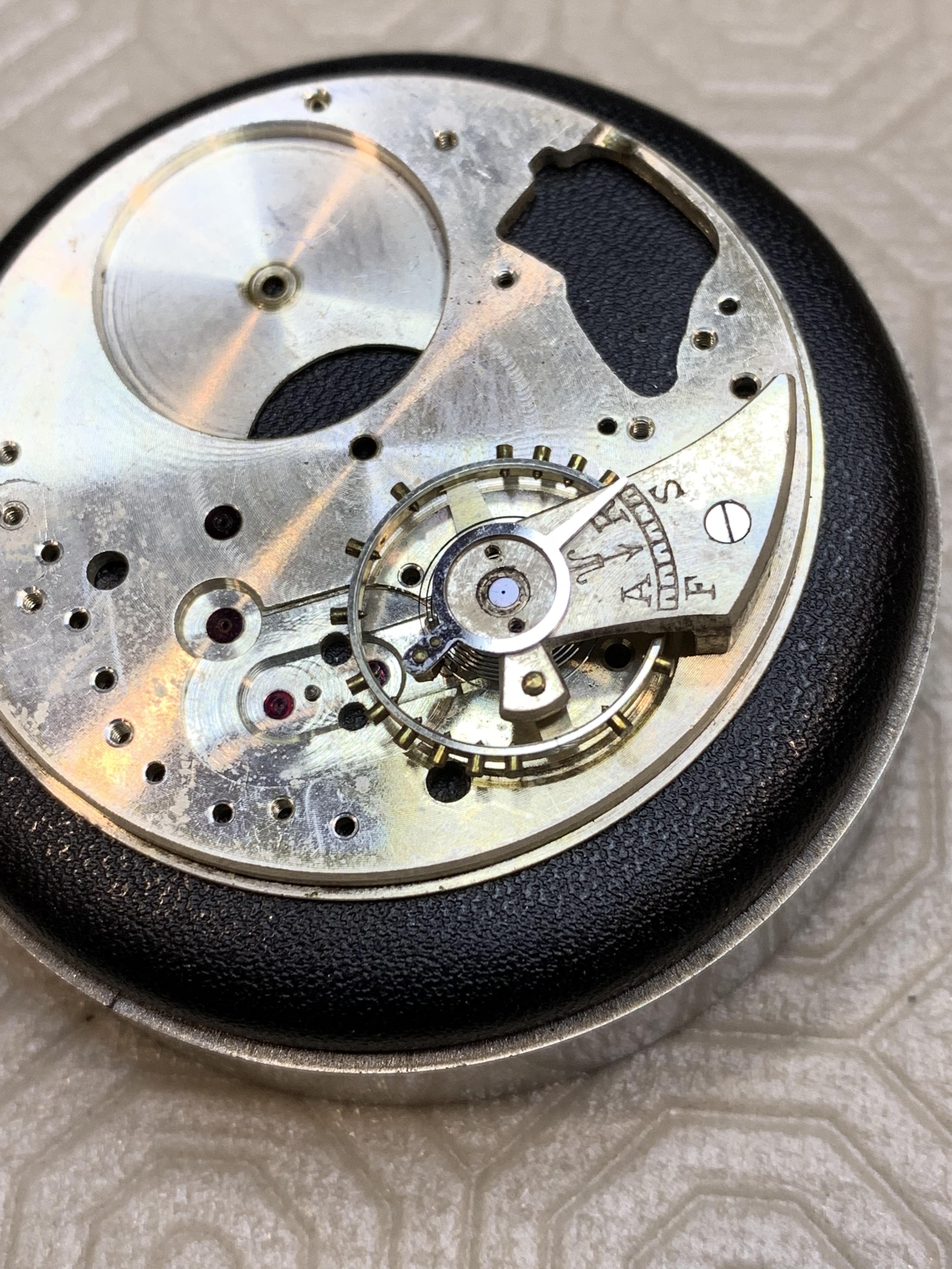

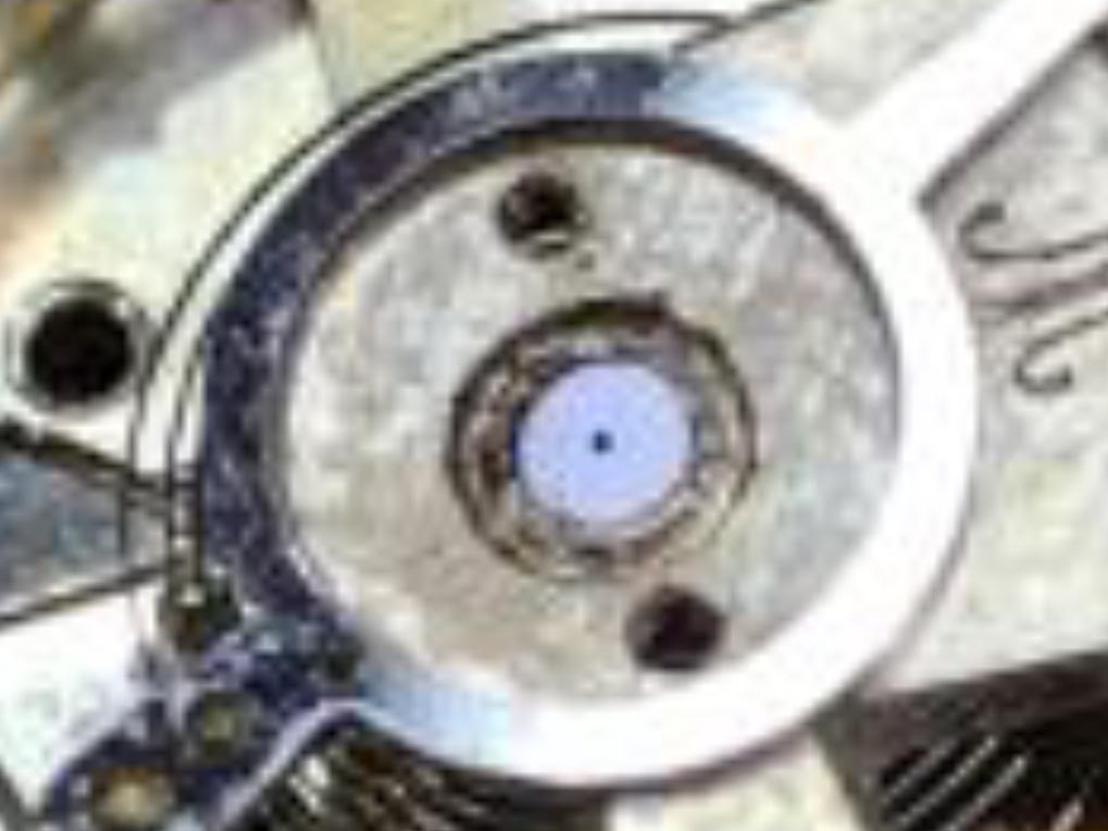

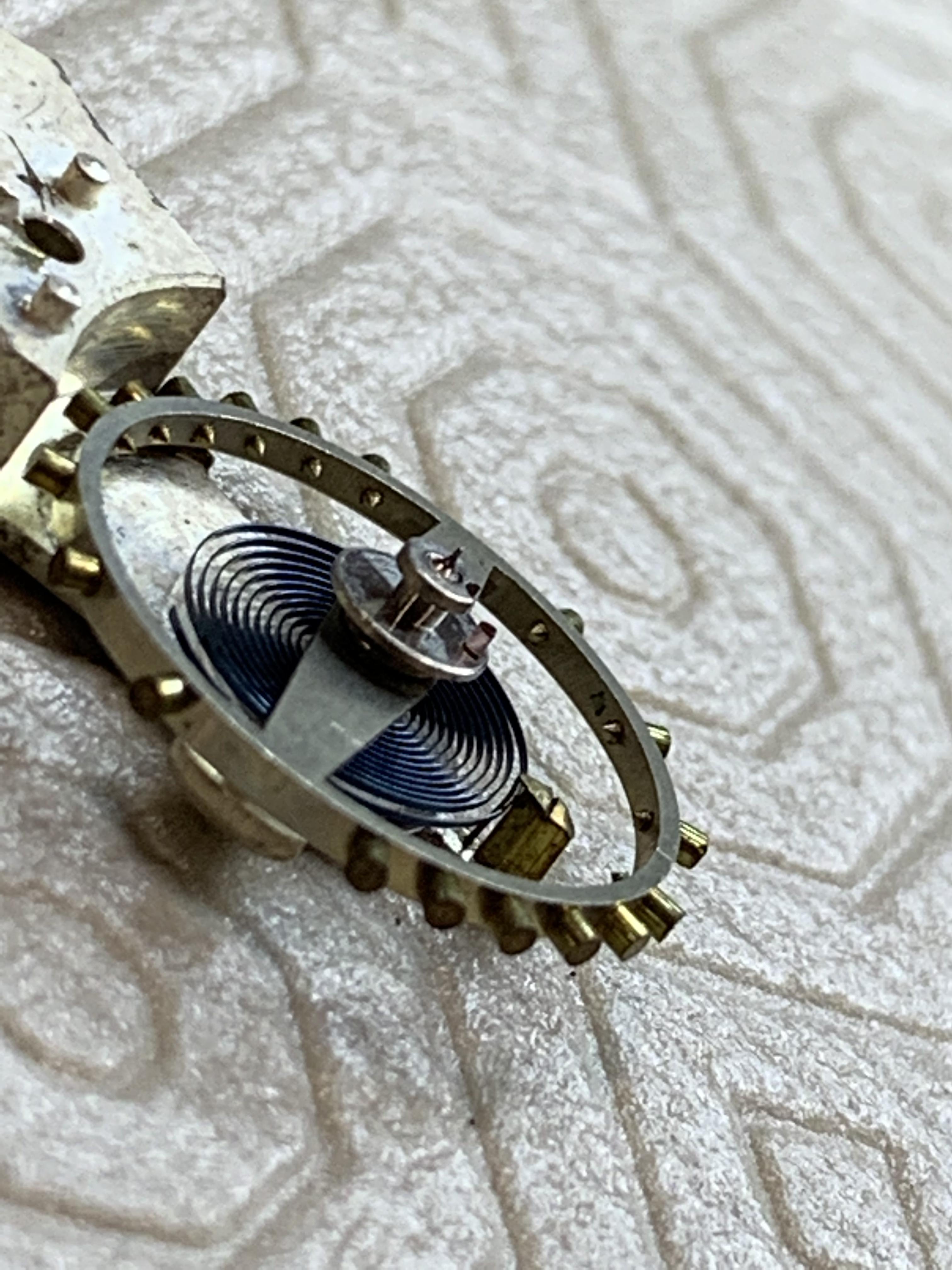

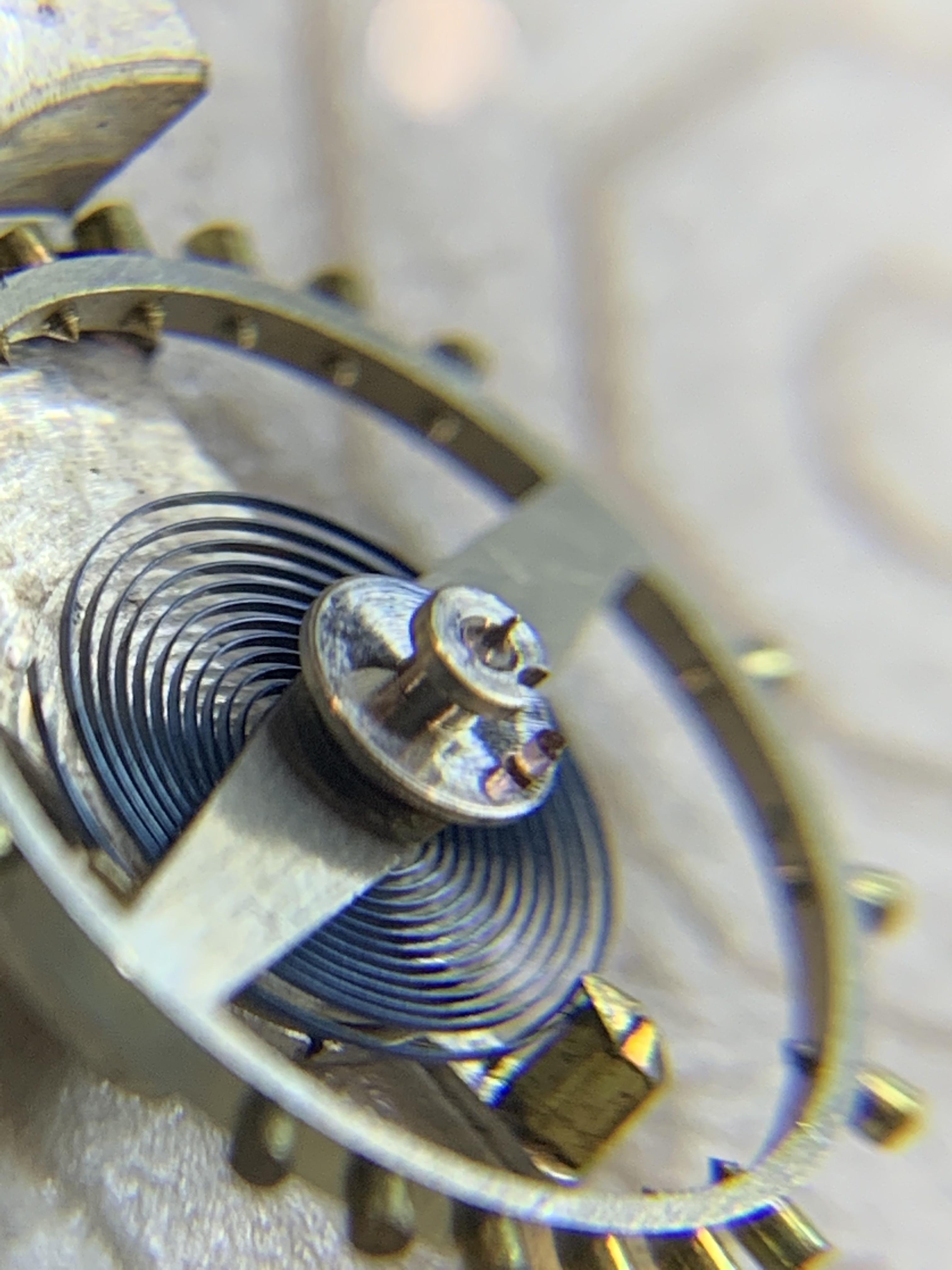

Hi all - I am I to my first ‘real’ practice movement, a pocket watch with a Swiss movement. No markings in terms of what the movement is that I can see.
I have disassembled and even at first I noticed something was off about the balance. Going to put it back into the main plate and it is ‘wobbly’ about its pivots.

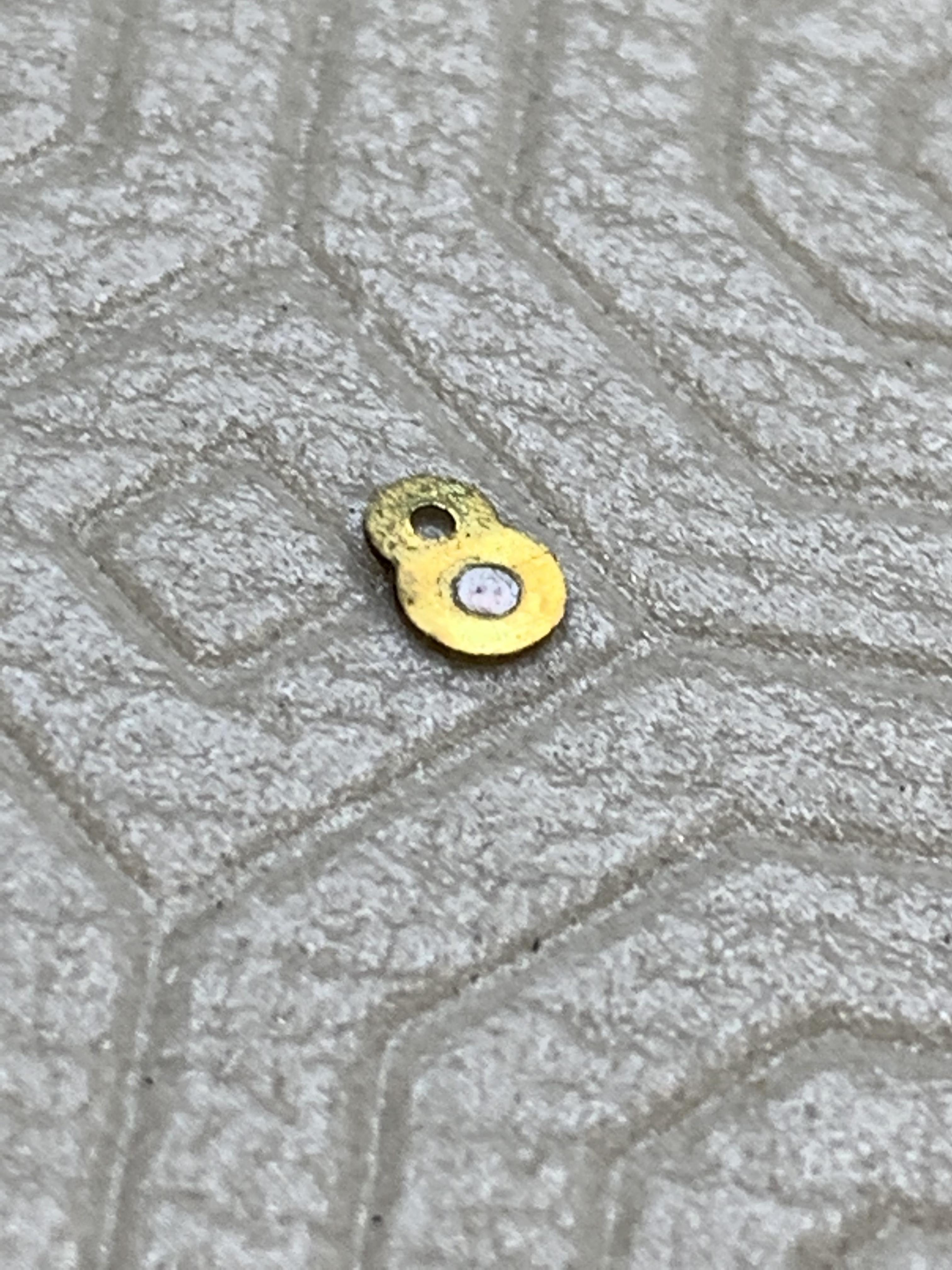

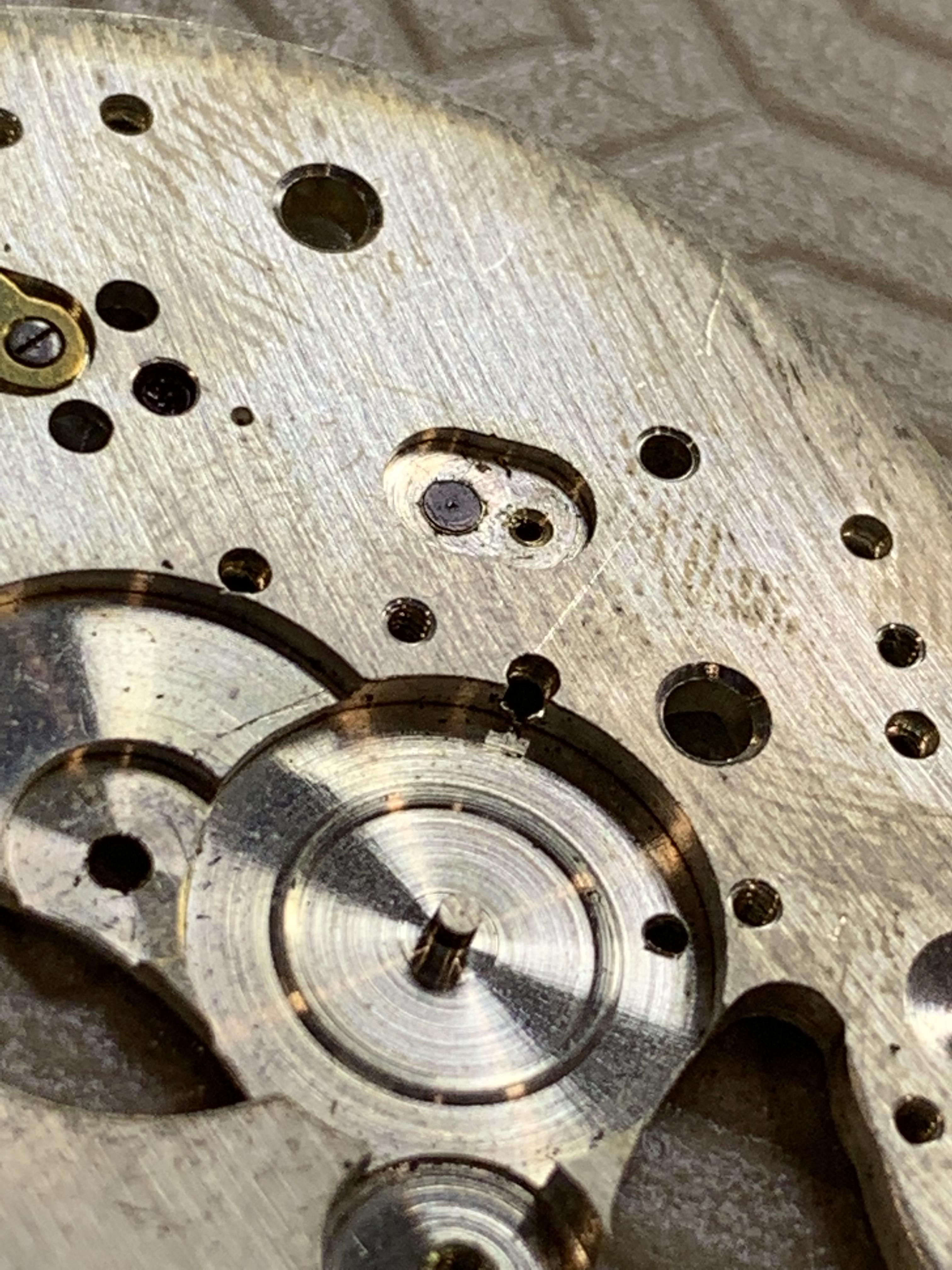

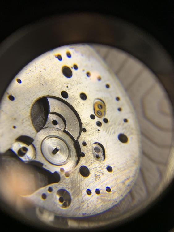

The best I have to look at the moment is a strong loupe. Pivots appear ok. In the attached photo I have removed the cap jewel to have a look under there.
With my intro knowledge so far, the only thing I can think of is that the jewel needs to be pushed in - any other suggestions? I don’t think the pivots are broken, but this is best guess based on what I can see.
Thanks!
Or, perhaps one of the pivots is broken off. Doesn’t look like this movement has shock protection.
The balance staff should have pivots at each end. The jewels (top and bottom) should have cylindrical holes and not be cracked or missing pieces. When you say wobbly, is it possible that you didn't get the pivot seated before you tightened down the balance cock screw?
your balance jewel does not look right it looks like a plate jewel. In other words it's flat versus a balance jewel that would have a curved surface.

Thanks @JohnR725and @grsnovi.
I will put the cap jewel back on and try to have a better look at the pivots again.
The wobble is the whole balance, like there is too much space between the top and bottom jewels. I will report back what I can see.
Well, to the best of my ability and the equipment I currently have, I think that both pivots look similar ie. one does not look broken off. Individually, when the balance is out and upside down, and then in and right-side up, the pivots appear to engage in their respective jewels. It is just the space between (way too much) causing the wobble.
Expand
That is a common problem. It can mean that the inside edge of the pivot jewel is worn (top and bottom) or it can mean that the jewels need to be adjusted in their setting to remove some of the end shake. It can also mean the the balance staff is worn in the radius between the pivot and he next larger diameter shaft.

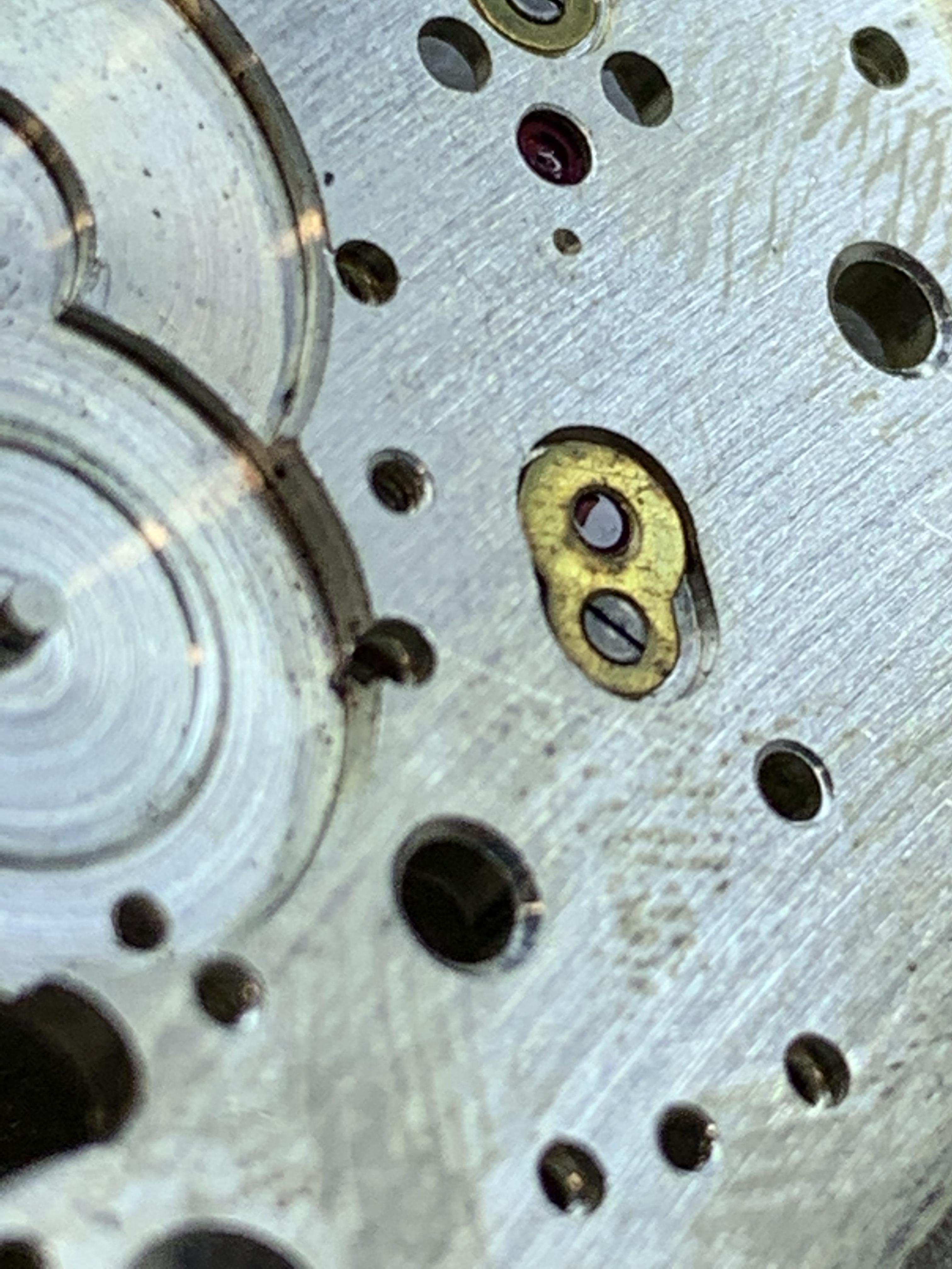

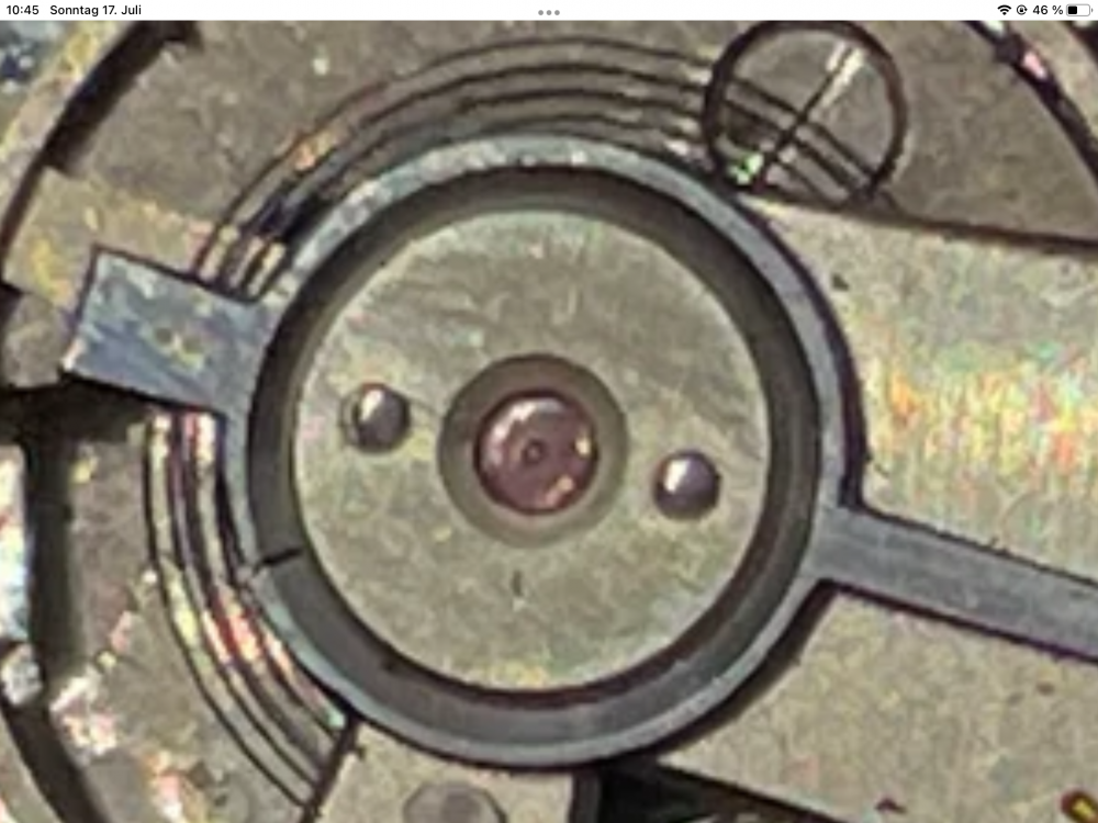

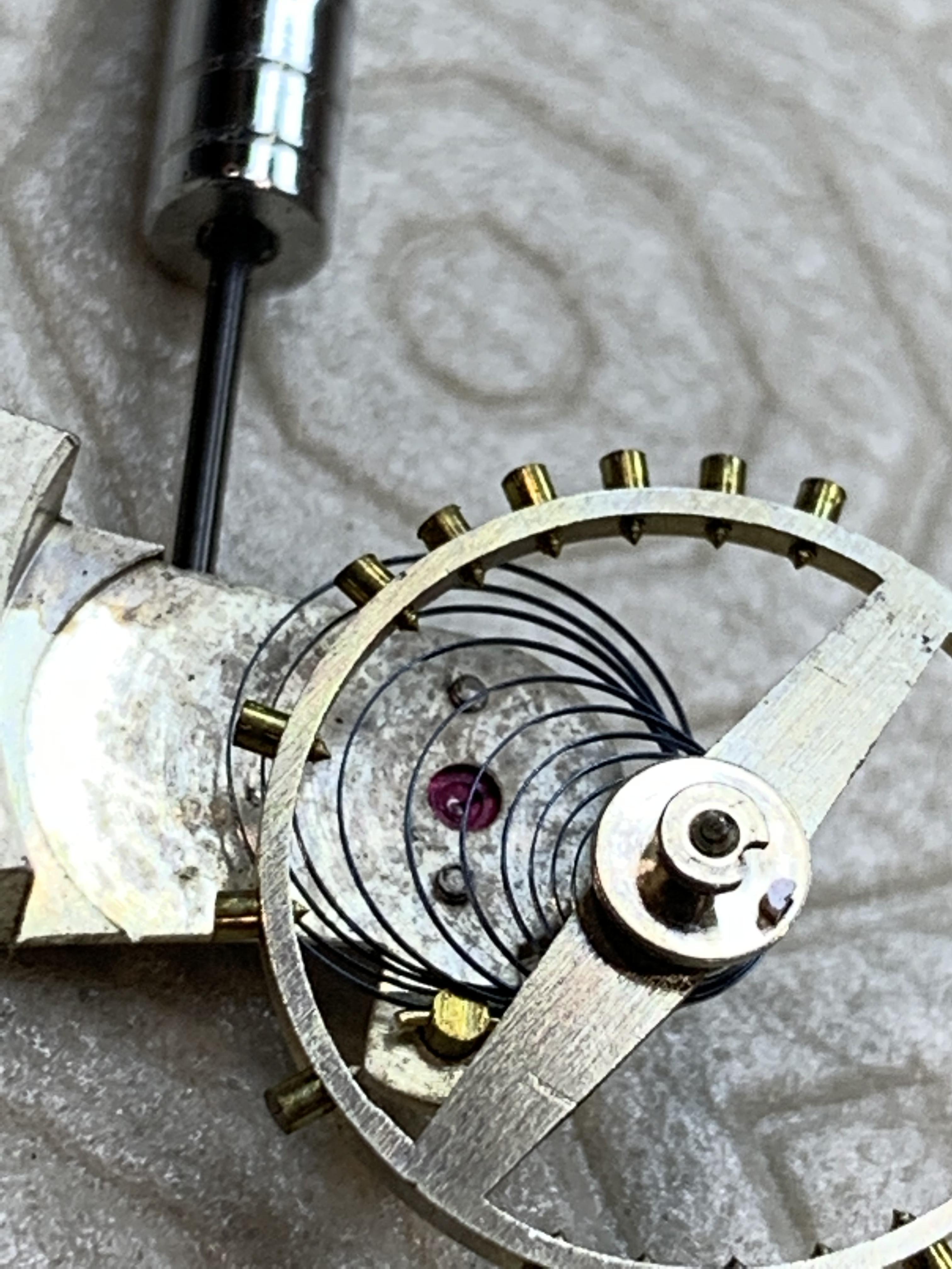

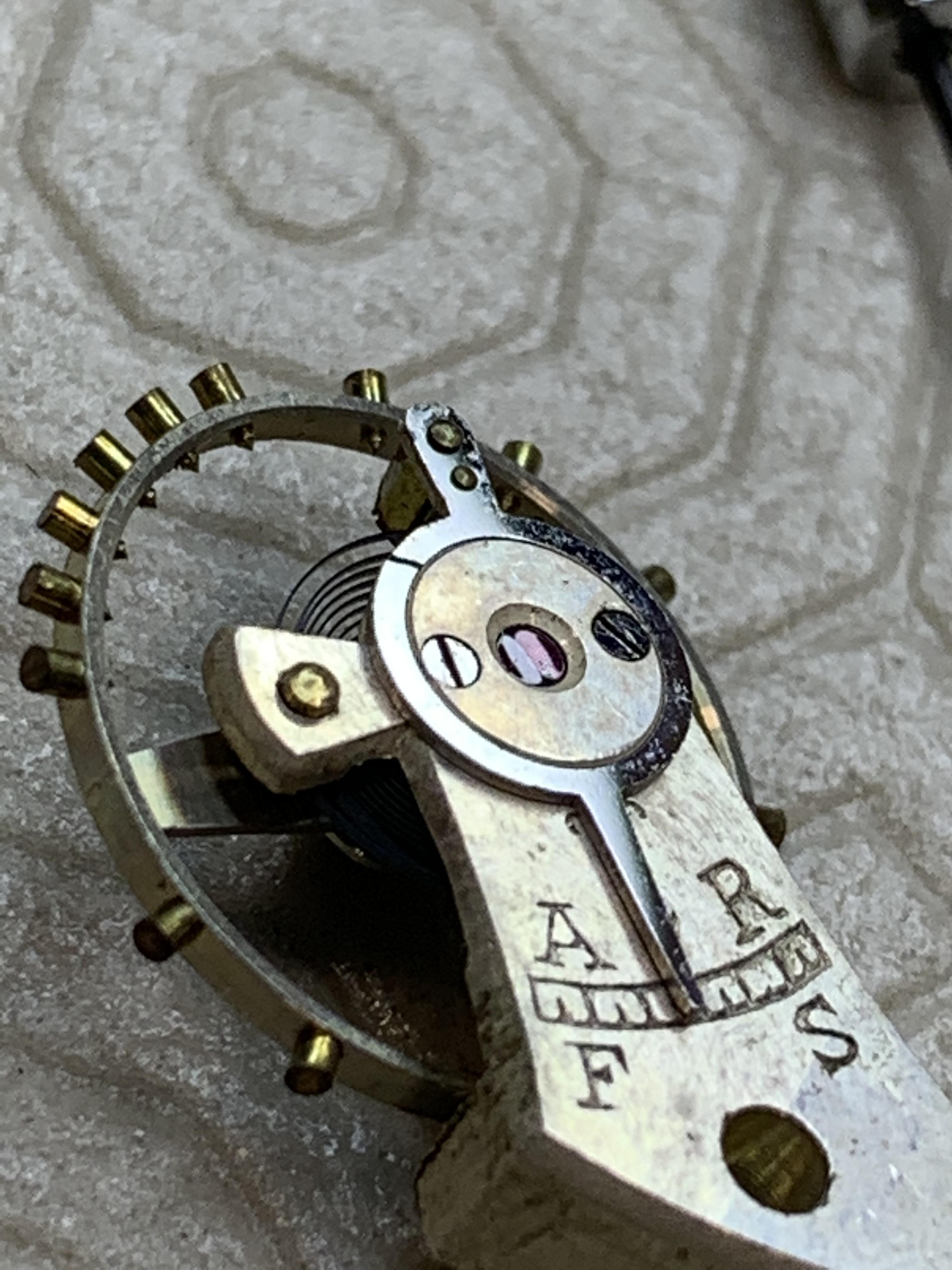

The whole setup doesn‘t look right and seems to be assembled the wrong way. The cap jewel is upside down (as John already mentioned) and the screw tips are not visible in the thread holes.
It should look like that:
Edited by Kalanag

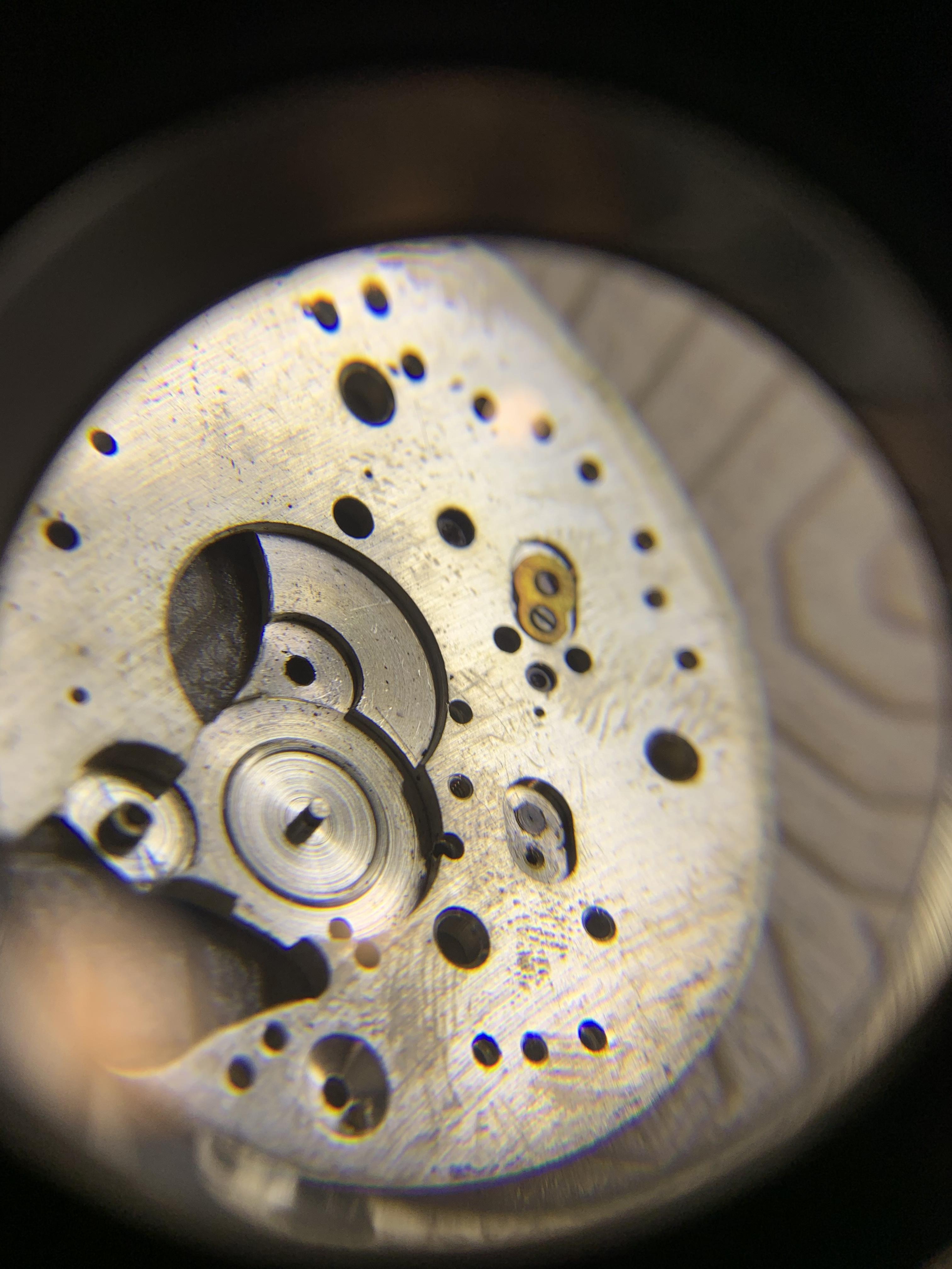

 Will you show an image of the lower jewel ( on the mainplate side).

My photo is from the top and I have the cap jewel removed. There are no screw tips to see as I have removed them, but if they were in you would be looking at their heads, the way this movement is assembled.

Thank you charette. I was waiting for you to clarify this before i commented on that. The jewel securing screws can come from either side depending on the design. You are lucky the reverse of this can be risky for a beginner to remove.  Can we see the underside of the jewel shown, and also the cap jewel please.

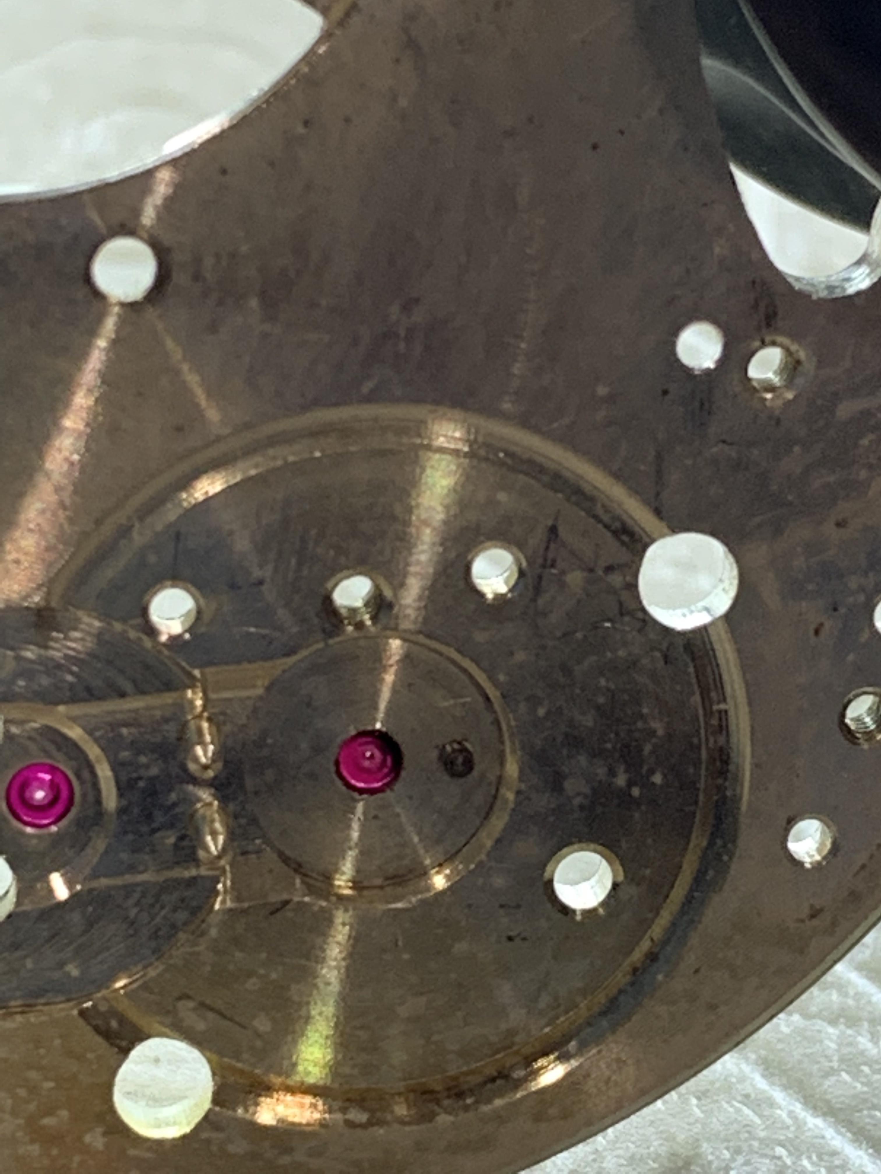

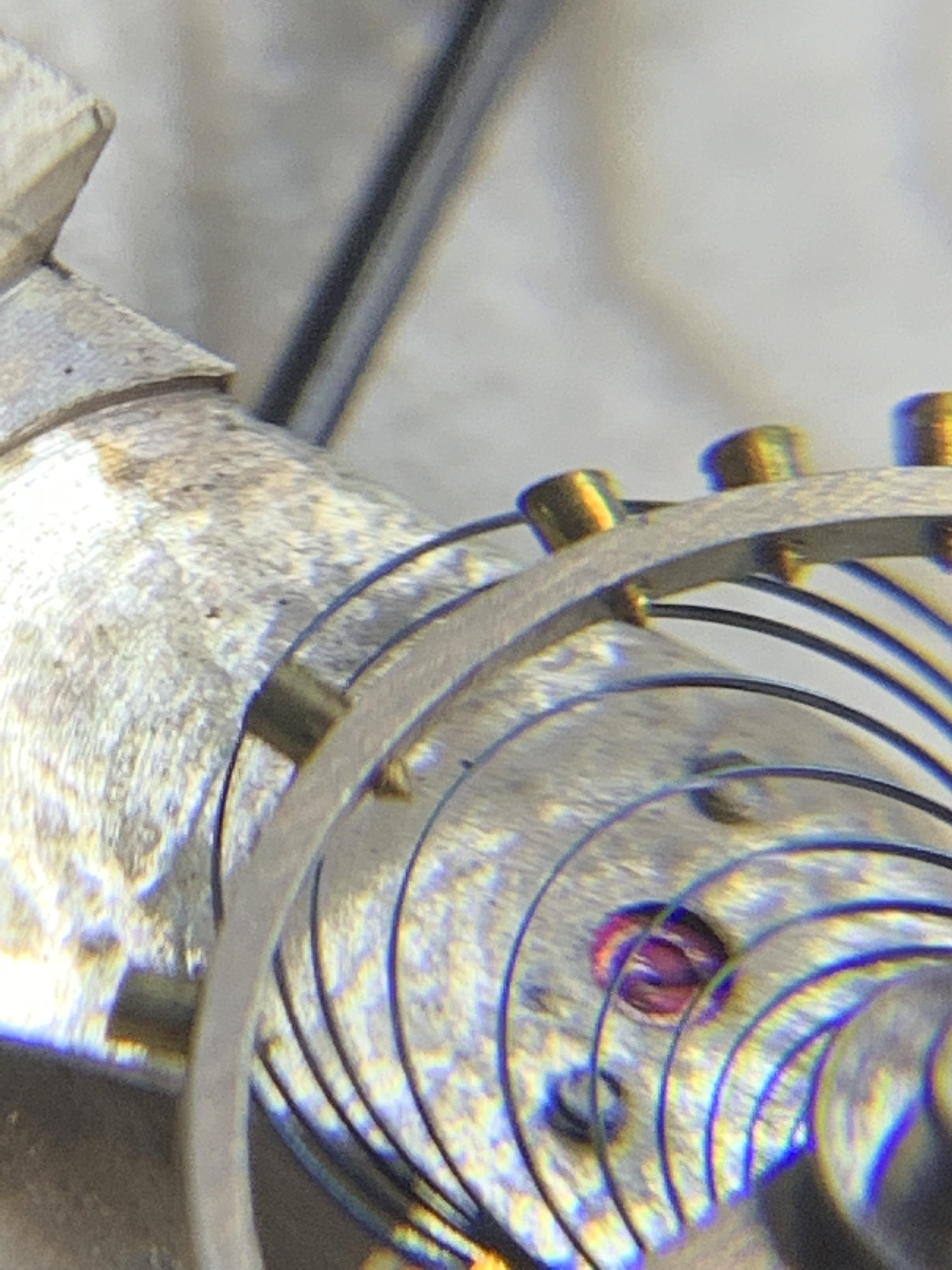

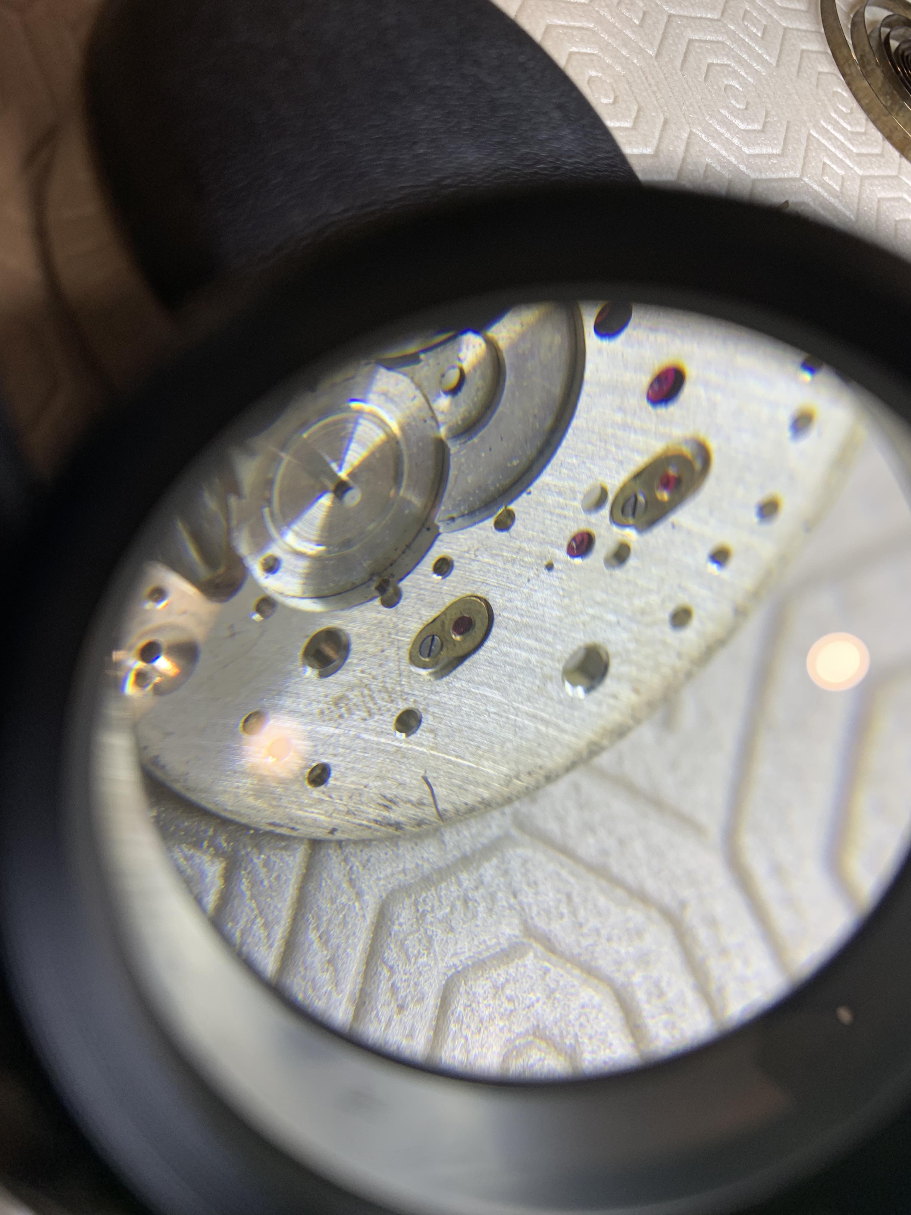

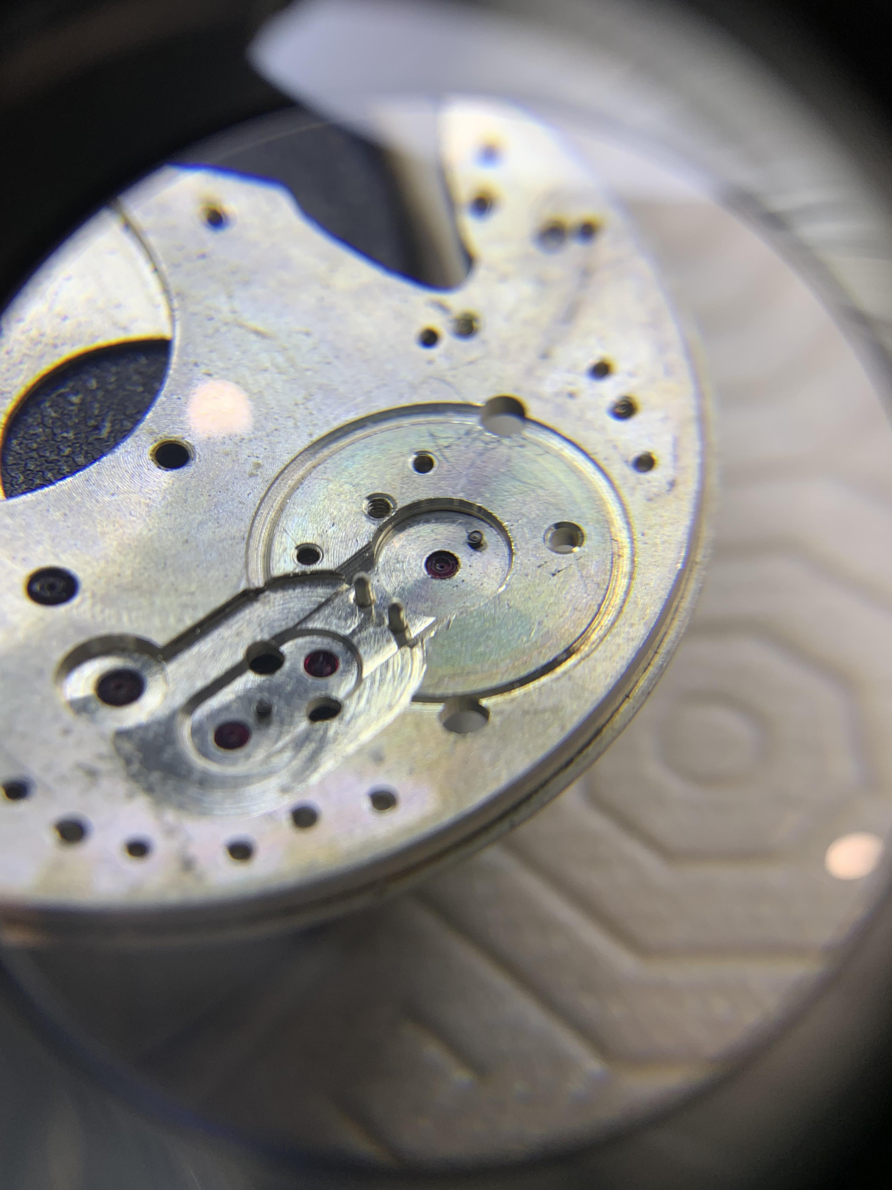

Here is what I was able to get so far. Just missing is the underside of the top cap jewel. Will have to wait until my kids next nap time.
Combination of trying to take photos through loupe as well with digital zoom on phone.

Thank you charette. Pictures 7 8  10 and 12  are the important ones. All except 12  are  a little fuzzy though. Something does look off with the top jewel on picture 10 as thought it is set too high. Difficult to see the pivot condition on 7 and 8 but also i think possibly.  Worn. Try macro setting on your phone to see if the picture improves.

and all your pictures I did not see looking sideways? In other words looking in so we can see the main plate lead see if the balance bridge is parallel to the main plate we could see the balance wheel?
