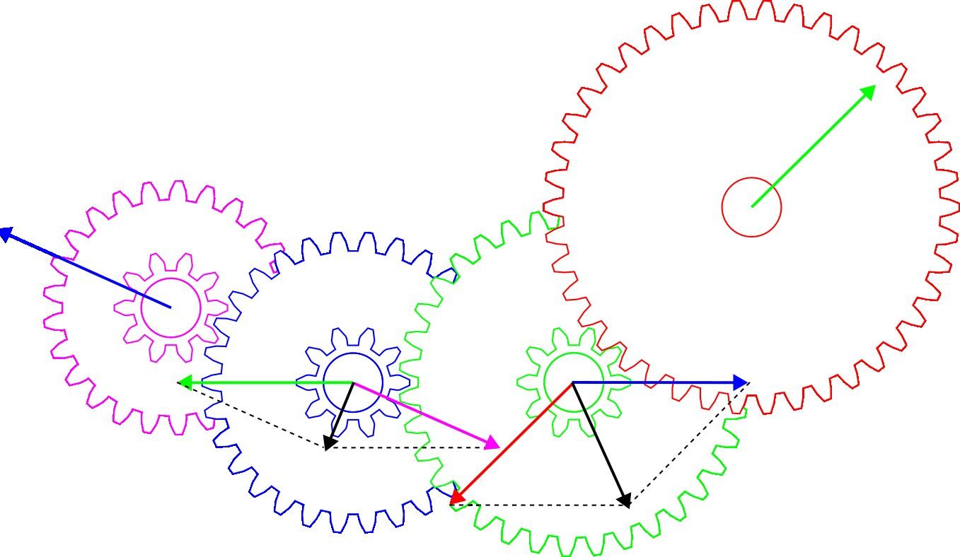

Worn pivot holes continue to be something that is causing some headache.  If a pivot is worn, it would be difficult to quickly tell which side of the "oval" is the original location.  Though I was thinking about it, and the orientation of the gears should provide some clue.  Let me know if anything here is off base.
I made this mockup of an imaginary gear train, with the red gear being the mainspring barrel.  Assuming Newton's 3rd law holds true here as it does everywhere else in the universe, then if the mainspring barrel pushes against the center wheel (red arrow), then the center wheel also pushes back on the mainspring barrel equally (top right green arrow).  This will have the effect of carving out the oval in the direction of the green arrow.
The center wheel pushes against the third wheel (left side green arrow), and the third wheel pushes back (right side blue arrow).  The combination of the force from the mainspring barrel and third wheel pushes the center wheel down and to the right (black arrow).
The same concept applies to the rest of the gear train.  Then it would seem intuitive that the original location of the pivot is wherever the opposite of the direction of the force is.  Again, please correct me if I'm wrong.
With that said, if I want to ream out a pivot to rebush or jewel it, how do I make sure that the reamer stays dead center on top of the original location?  The second that reamer touches down onto the oblong hole (sometimes exacerbated by being in a concave recess), it's going to want to walk from it's original position to the center of that oblong hole.

I‘m sorry to say that direction of forces acting in the bearings seems not to be right in your drawing. You have to start with the driving force on the two meshing teeths which is oriented perpendicular to their current contact plane. The bearing load of the barrel is exactly parallel to this force.

Ahhh, looks like I forgot about the tangential component.  Thank you!

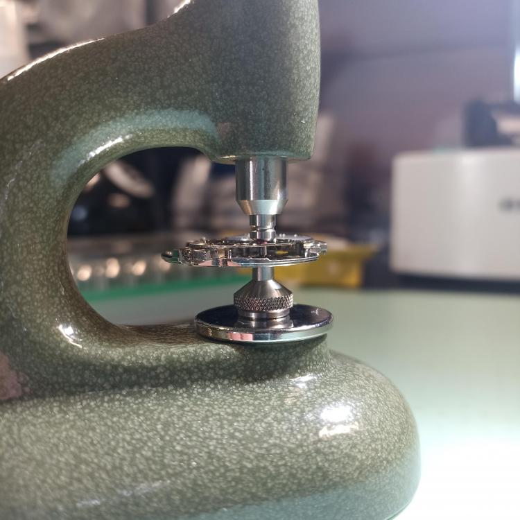

Something I do. I align the mainplate on a stump by using the train bridge as a guide. Then, while applying light pressure, I hot glue the mainplate to the stump. I use as much glue as possible.  Then I remove the train bridge and move the stump to Seitz tool to start reaming. I also glue the stump to the tool base. Of course there is a little play between the stump and the hole so it would be perfect if you could center it perfectly before gluing. I haven't reamed horribly oval holes but I believe this method might work. Hot glue is still a bit elastic but at least you don't have to hold the plate with hand while reaming. Let me know if this sounds real silly 🙂
I like this idea.  The hot glue I can see as being a bit messy and I'm not sure how you would make sure that every trace of it is removed, but in principle it's good.  I think all the jewels on the plates and bridges should be friction fit, not shellacked (someone please correct me if I'm wrong).  But with that said, you could probably use cyanoacrylate superglue to really get that thing secure.  Then you could use acetone to clear the glue.  Since nothings shellacked, there shouldn't be any risk of loosening jewels.

Hot glue is nice because it bonds pretty well with metal but also peels off really easy. I remove any visible bits and then give it a good soak in acetone and also isoprophyl alcohol. I tried some super glue but it cracked when I rotated the parts. Maybe I should have used a lot more. I have the chinese Horia clone and real Seitz. The clone is pretty nice quality for the price. The stumps fit my Seitz which is 4mm. I also use Seitz bits in the "Horia". Mainly for cannon pinion tightening.
