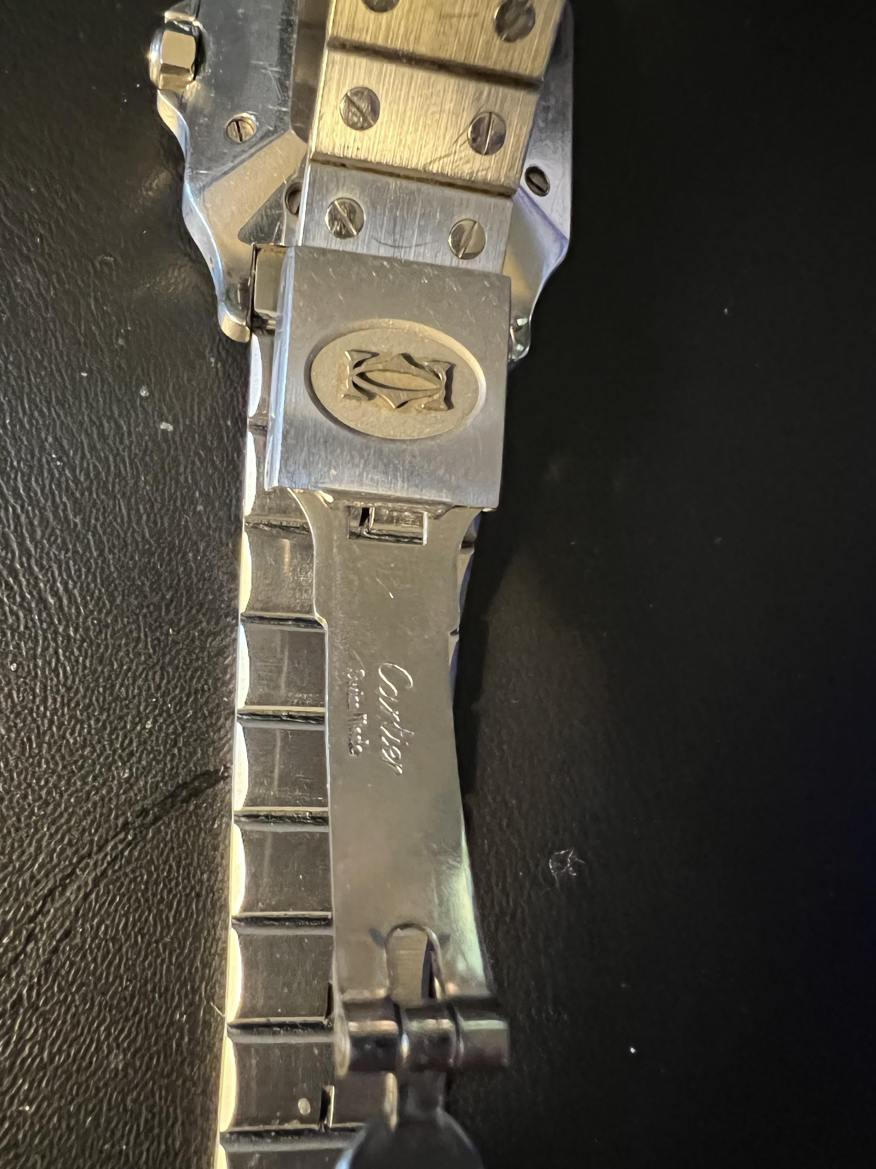

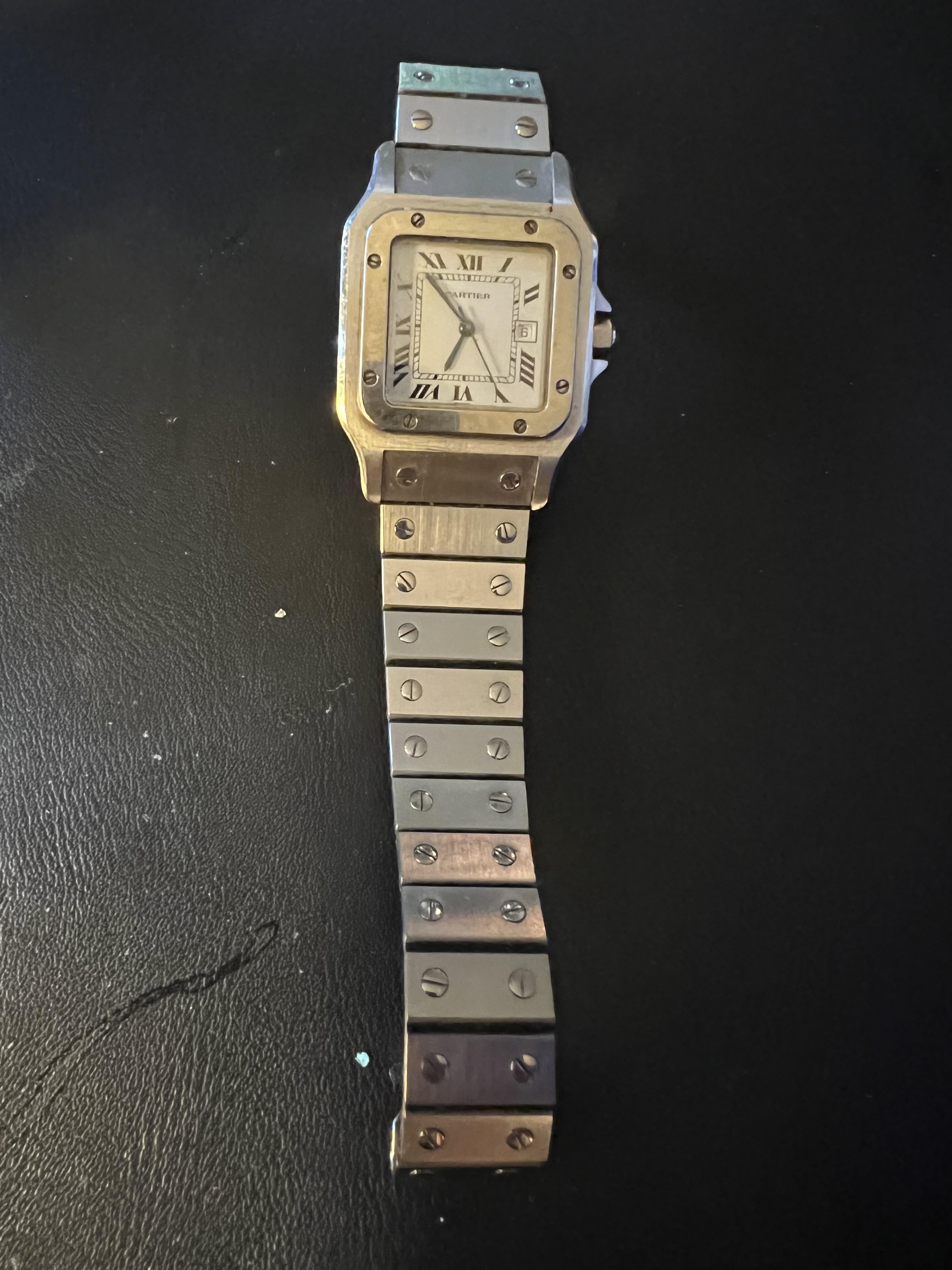

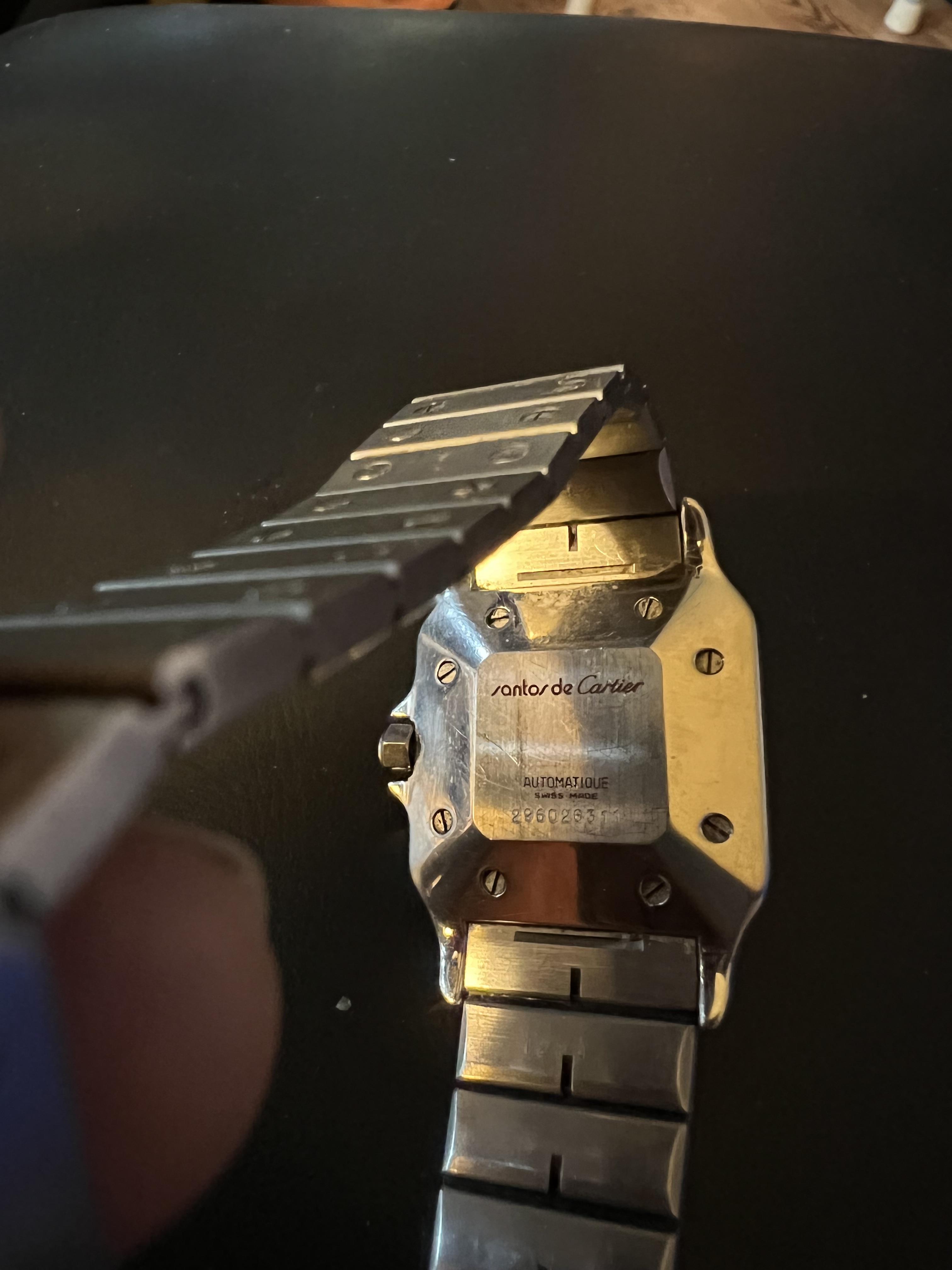

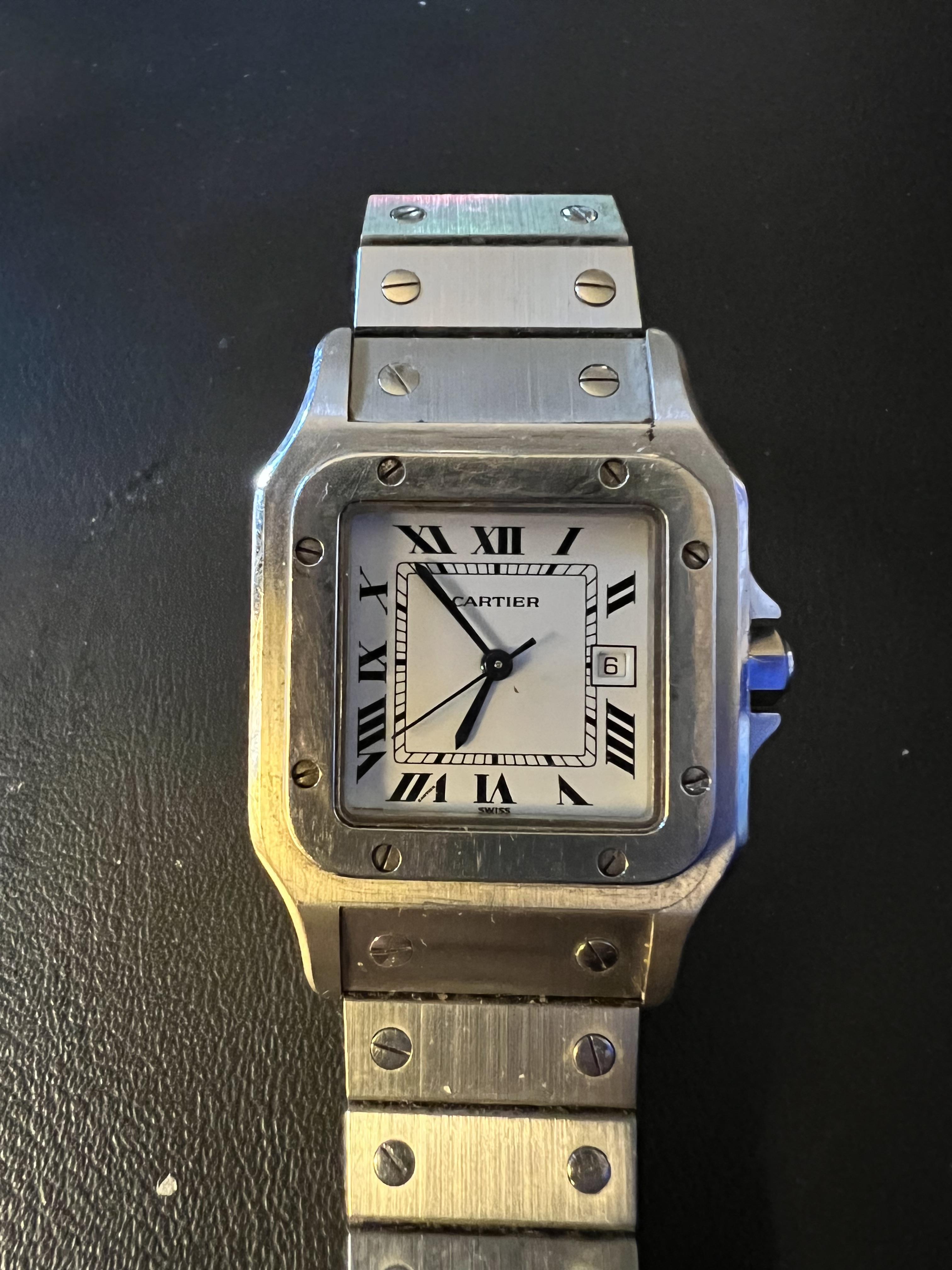

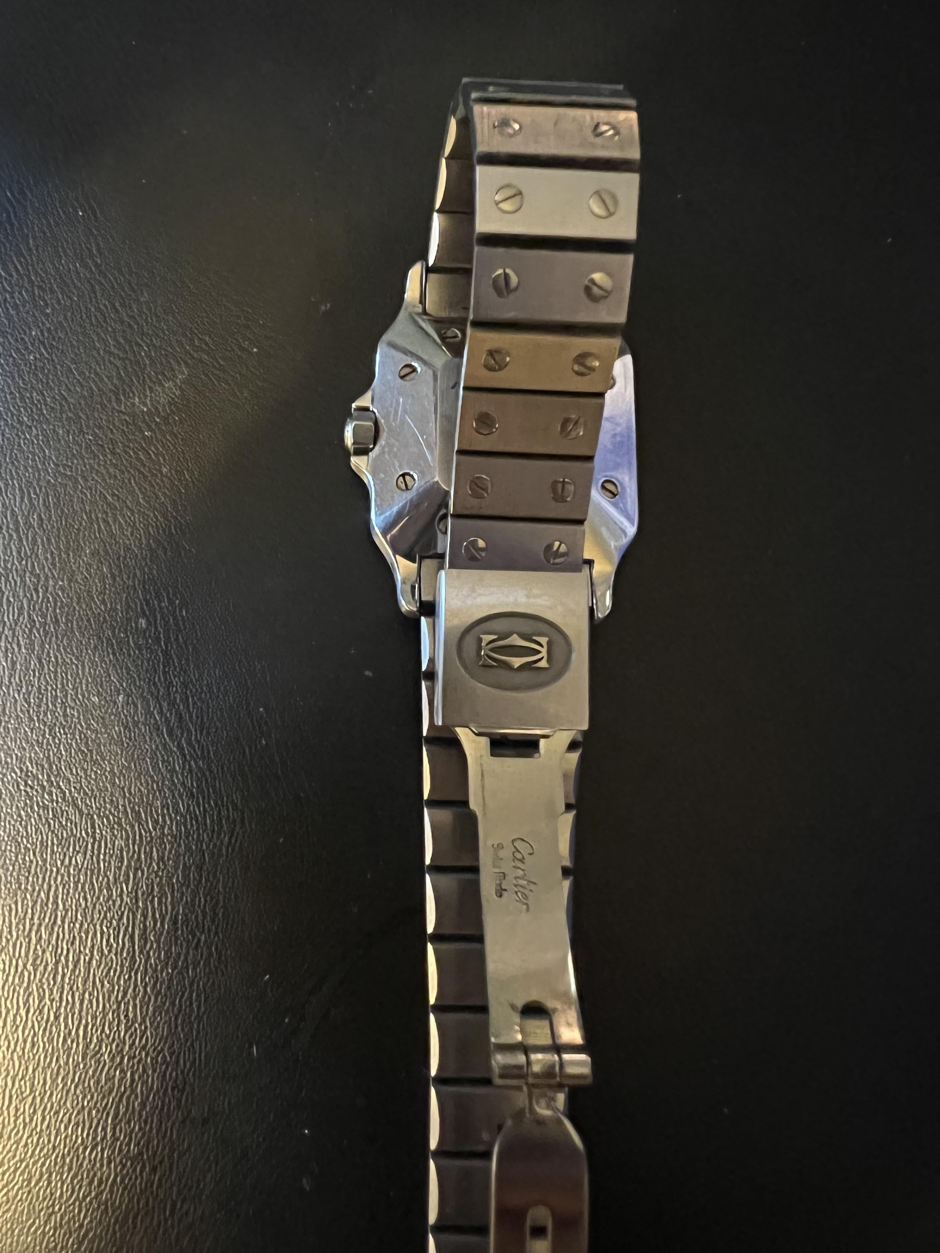

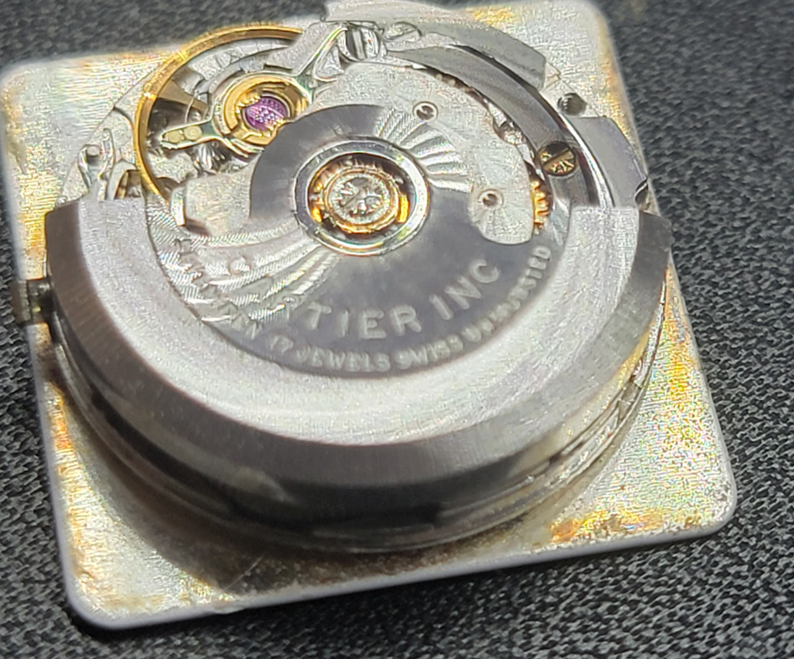

This belongs to my father-in-law and I am to inherit it.  Frankly, from what I have researched, it looks like a fake.  I cannot open it up now, but I may have the opportunity later this year, when I will know for sure.
Thoughts?
You can find both back engravings on originals: „Cartier“ and „Santos by Cartier“. The link in the above post shows an example.
Edited by Kalanag

I'm inclined to be a little suspicious too.

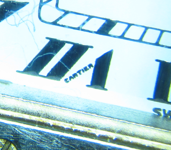

On all of the Santos dials that I have looked at one of the strokes of one of the numerals is the word "Cartier". It's not always in the same place, on yours it's on the thin arm of the V in VII, and on yours it appears to be very smudged. I can't imagine that a genuine dial would be anything other than crystal clear. Check images on the www and you'll see what I mean.

I found this comment on Chrono24 about the Cartier ETA 2671
Movement complete, for the Cartier Santos ladies Automatic. This is a complete movement, without it's hour wheel, but the caliber is unknown. As this movement needs a hour wheel, that has a reduced size, kindly check if your hour wheel replacement is available before ordering this item. How to know it is a Cartier caliber? Simple.. LOOK at the regulator portion of the balance bridge, the regulator will be left handed, ie: the reverse of all ETA 2671 calibers. This is a normal Cartier trait, to have a left handed movement, it simply cannot be replicated!
I do not understand the "left handed" comment.
