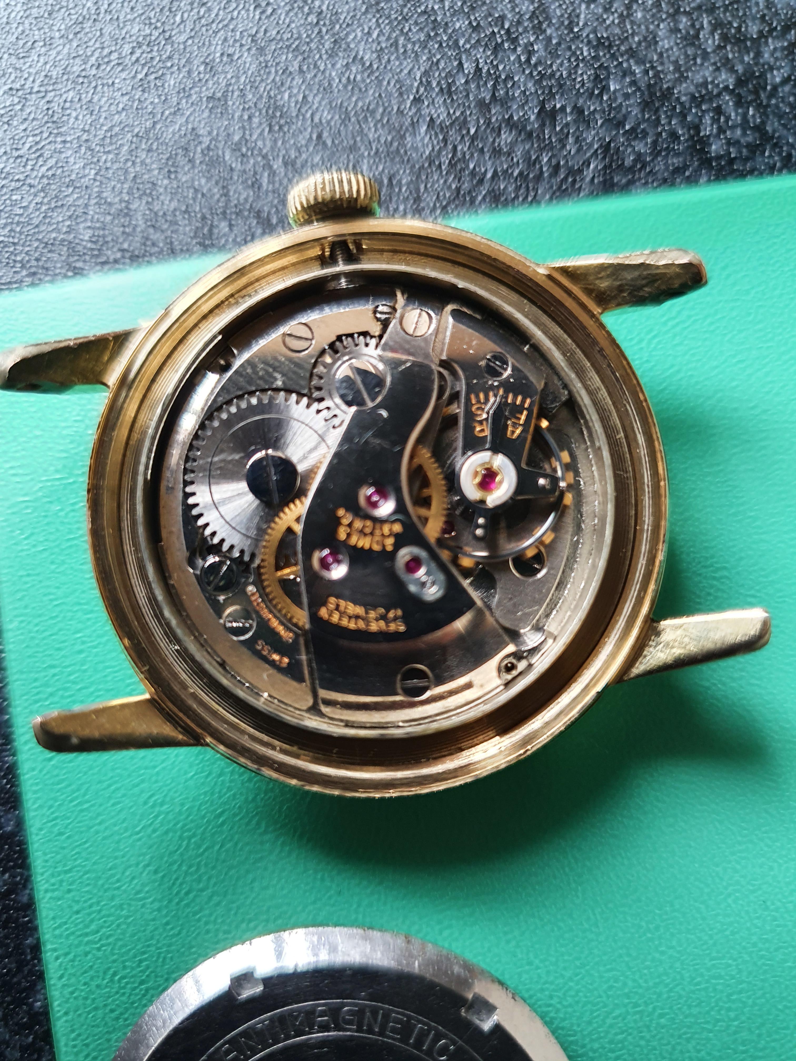

I can't find any markings on the Admes, any ideas?
I assume you looked under the balance wheel for markings? Then we need a picture of the dial side without the dial and the diameter size of the movement. Often times when you take the dial off their may be a makers mark their. Otherwise we can use the setting components and the size to figure out what it may or may not be. This is where having a copy of the bestfit book physical is really nice but PDF is also nice. Because you can use that the lookup a heck of a lot of wristwatch movements.

As most of you know I am now an expert, I have diagnosed what is wrong with the Admes. I bet even Mark would have struggled with this one, hehe.

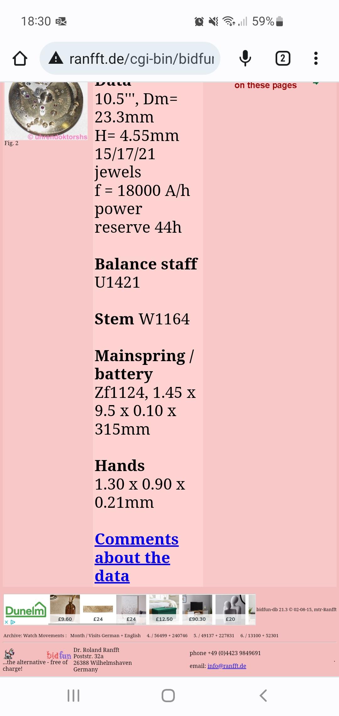

Ok, from ranfft, see screenshot and the closest from cousins, good enough match?

Yeah Rich, just in case you missed something that mainspring is broken mate. Not always easy to diagnose i know but the fact you have one piece of it and another piece of it, so in effect making two pieces of it and not the usual standard unbroken one piece of it, thats a fair clue to the fact that it is actually broken. If you need any more help or advice mate i'm always here for you. Unless it involves marriage or any kind of wierd sex stuff, in which case you're on your own mate 🙂
