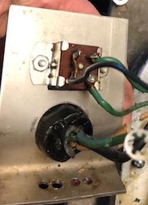

Here are some photos of the plug. the first two are the motor cable. The second pair are the switch at the machine. These are from an early machine without the ultrasonic.
Thank you for posting the pictures.

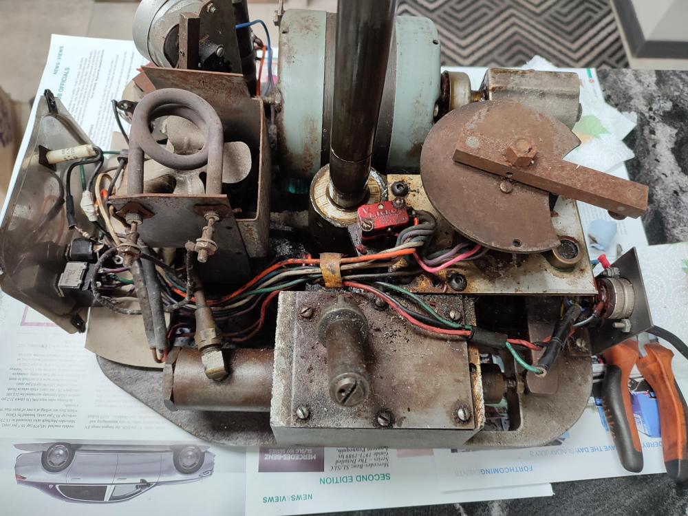

Just looking at the 2nd machine, it runs (albeit without the basket motor).
It's grounded so I'll probably run it as is, with some DIY cleaner, meanwhile, re-wiring the 1st machine and going through the mechanicals.. and saving up for the L&R solutions.
Afterwards I'll restore the 2nd machine - should be able to get going this way.
In terms of disassembly, the carrousel can be removed by removing an e-clip with needle nose pliers. It appears the induction motor and worm drive are the next things to be removed (which don't effect the timing).
It looks possible to then remove and lift aside the microswitches (keeping them fastened to each other with some tape or nuts on the screws). It appears the cam assembly might be removable in one piece with the top plate (held by screws to the column and hydraulic reservoir)..
The wiring plan will be to build up a wiring loom with new switches and wire, then drop it in as one once the chassis is clean..
