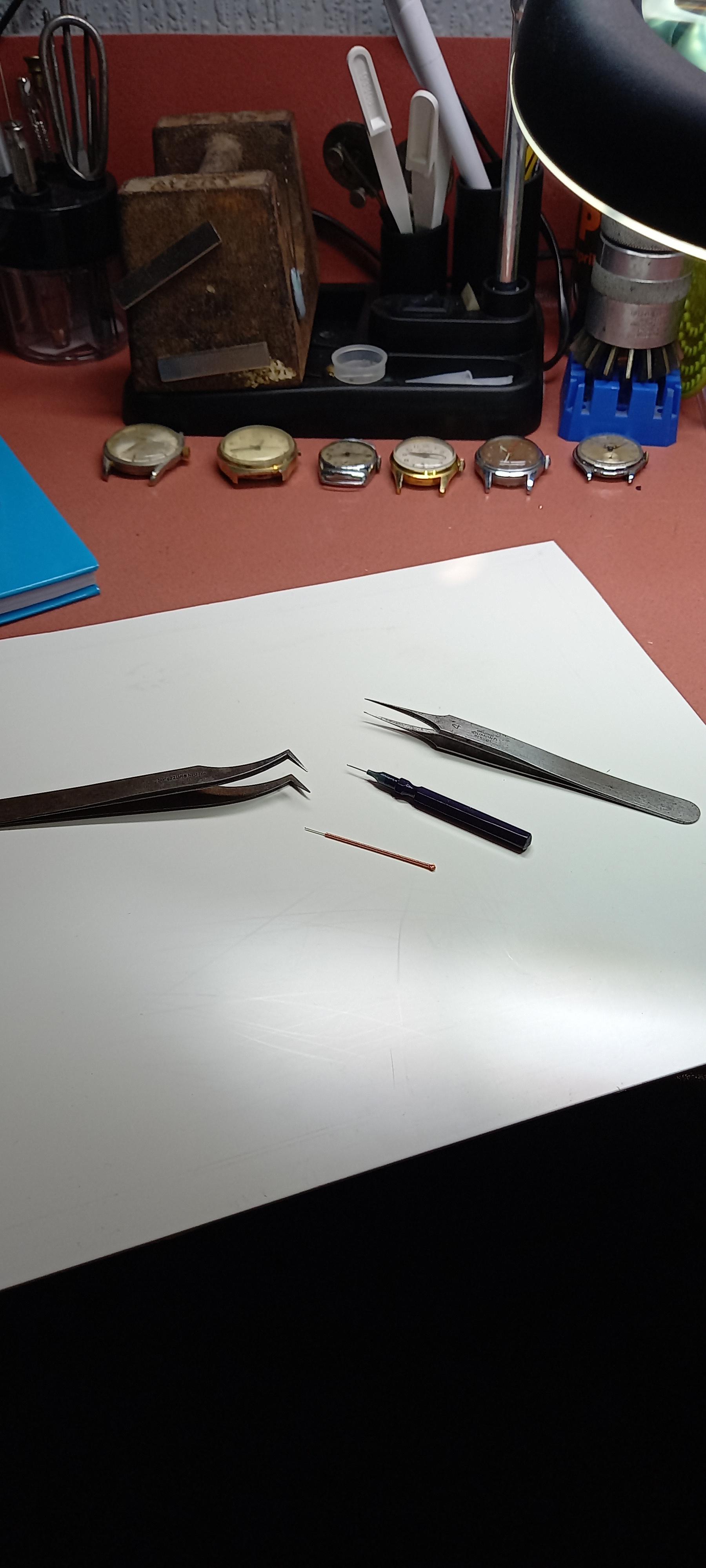

Based on your advice I have put aside the hairspring that I need to work on, to practice. I had another hairspring, from a gents wristwatch, and I have spent hours on it. The pictures show a progression of my learning, which is actually more like circular attempts to fix, worsen, and remedy. The more I try, the worse it seems to get sometimes.
So I now use a hard surface - a white ceramic tile. I had to purchase two new tweezers - Dumont, which made a huge difference.
I still find doing this with a loupe difficult.
The problem I am still not able to sort out is twisting. So still some more to work on.

You make so much sense John. Trying to explain to a beginner how difficult some of this work really is, isnt easy. I think you do a good job of putting things into perspective for them and probably save a lot of damage to their watches in the process.

Just keep practising matey, now you know why JohnR725 suggested you practise on something scrap. You did well to listen 👍, some folk do not.

I have found that very thin tweekers and a hard white surface is essential. But would you suggest any tool or holder for a hairspring, that is useful when working on one? Sometimes my hand simply shakes the hairspring in various directions.
And I find that stretching the spring downwards can sometime help in observing it and its symmetry. What do you use?

Some use a pair of these 90 degree bent for manipulation, i have tried them but find a little too big. I might dress them ond day . I normally use some very fine tweezers to hold the hs and a super fine oiler or a cut down 0.2 or 0.3 mm accupucture needle to gently press agaist them to straighten out an odd kink i may come across. And to work on either a sheet of clean white card or a sheet of white pvc  gives me clearer view of what i want to do.
