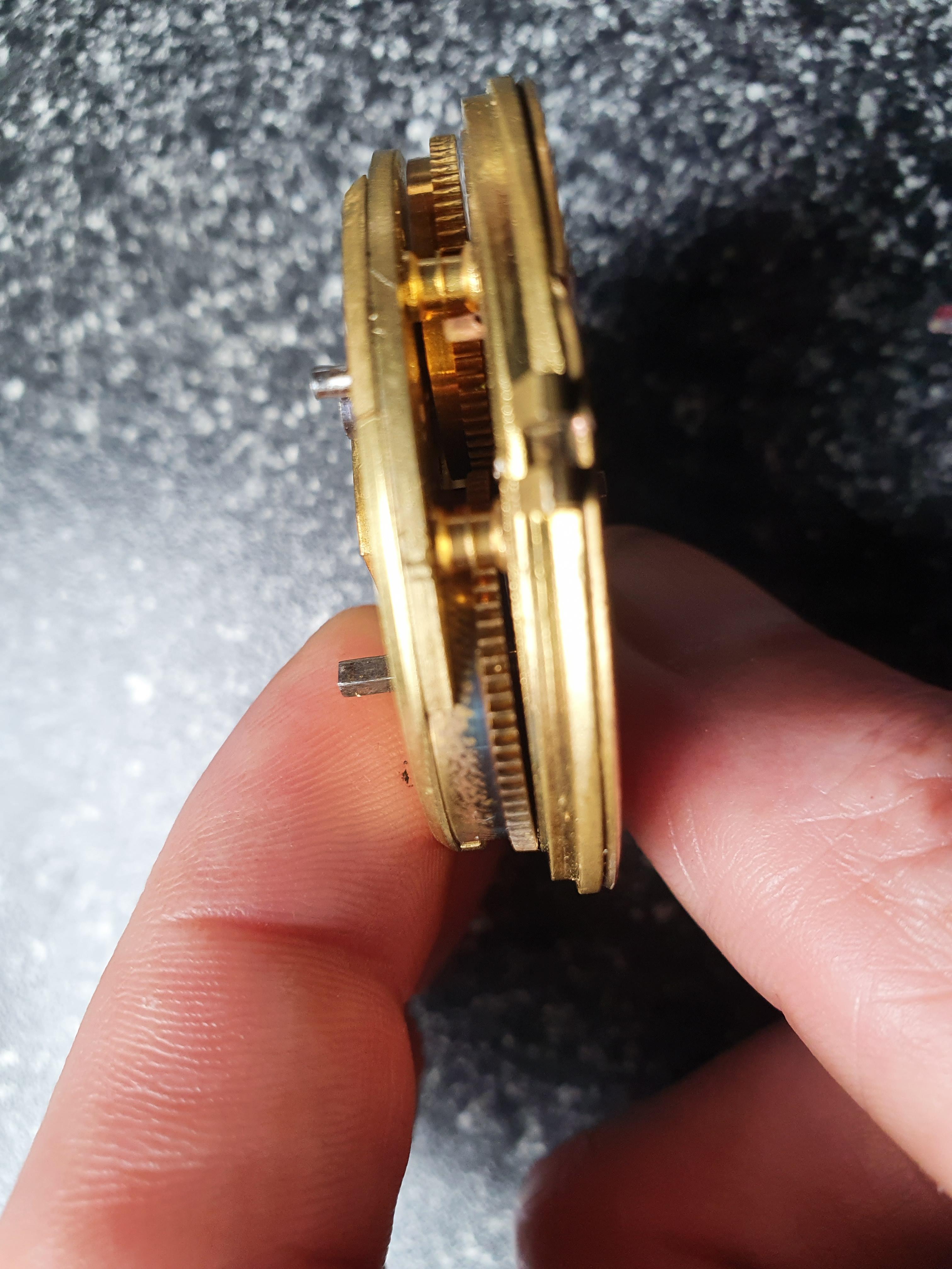

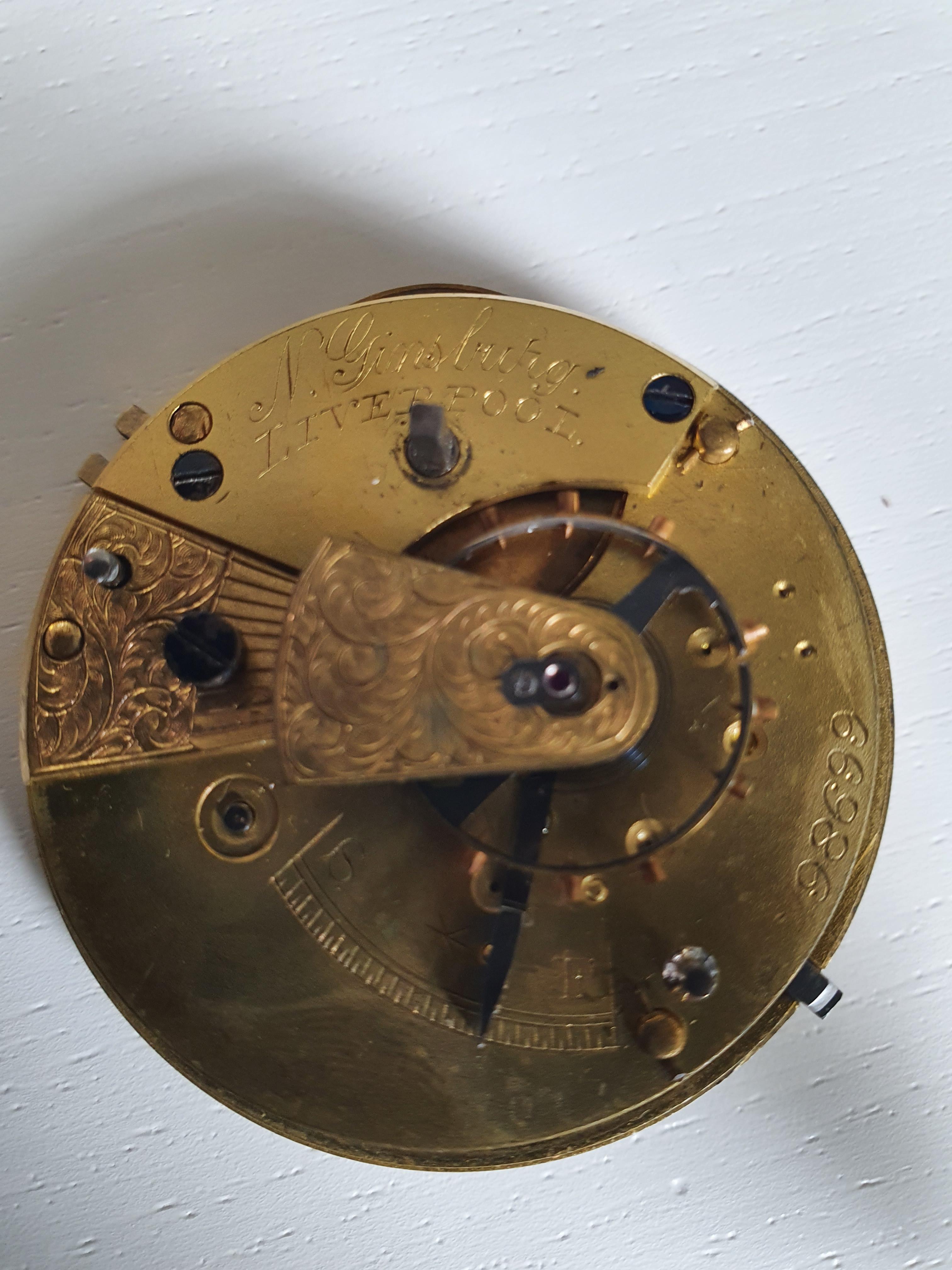

Another one to feast your eyes on.
English lever, two barrels?

Taking the place of the fuseé
 The reason the fusee was invented was because there was no way of having the same thickness in a mainspring, so when the watch was winding down the power was not constant. The invention of the fusee corrected this.
It should be better because the springs were made had the same thickness end to end, so the rotation of the balance wheel would be the same regardless of what power was driving the balance to rotate. There are other movements that have twin barrels but only one has a mainspring the other acts as an extra wheel.

I always think of these as transition movements which is not the correct technical term. Notice it's a lever escapement versus the verge. It's more tolerant to power fluctuations plus the quality of mainsprings has improved. In other words we no longer need a fusee but for unknown reasons they keep making watches the same design.  This means need something to couple the energy from the mainspring barrel which now has  teeth to the gear train which means you end up with a intermediate wheel basically that looks like a second barrel.

So it's a intermediate wheel not a second barrel.  Thought it might be a second barrel with spring to give more running time between winding.

That's what I thought as well. Another spring inside as a way of compensating for time keeping fluctuations.  I would be itching to get inside it to have a look.
No this is what I said.

Ah thanks again OH. I did think that was what you meant. I think John explained it a bit differently.
