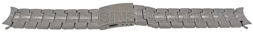

also the grain run's from top to bottom (lug to lug) I haven't ordered a strap yet but I think I'm going to order this one from cousins uk
While the grain running lengthwise down the band would be the most common style, it doesn't look that way in the pictures.
I don't think that band will fit well.  The original band has special small end links that fit inside the recessed area under case.  That band has normal curved end links, which clearly won't fit at all.  I think you'd have to take them off and attach the small link on the end.  But, it's probably too narrow to properly fill the space, so the band will slide from side to side.  It also might be too short, causing the large link to hit the edge of the case.
Your original band doesn't look too bad.  The center links can be re-bent closed if they have pulled open.
