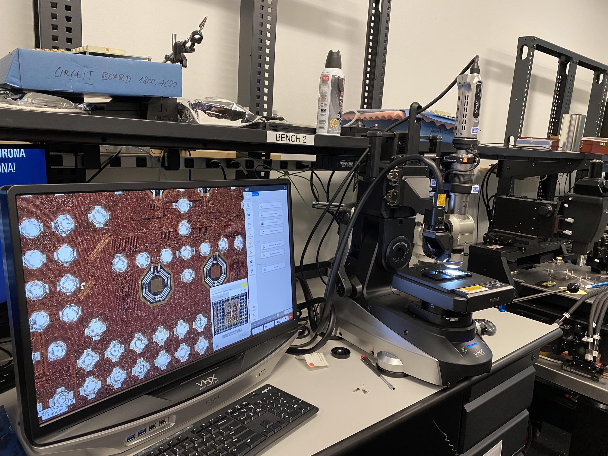

Aside: I have tell you that setting up these shots is a PITA, but satisfying once everything is aligned, in frame and focus.  However, we have it made at work:
In case you don't know what you're looking at, this a portion of a multi-GHz RF integrated circuit seen in the lower right. The whole chip is about 8mm on a side.  The larger octagon looking things are inductors.
