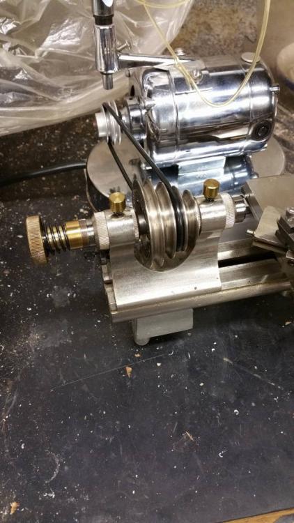

I have a very good condition Boley Leinen 8mm lathe and have been using Mobil Velocite Oil No.6 ISO VG10 for the spindle bearings. There are two oil cups on the headstock, one over the rear bearing and the other over the front bearing and it is rare that I have to top them up. If I run it at high speed for a few minutes the area surrounding the front bearing gets warm and rear bearing area gets quite a bit warmer, almost hot. My question is, is the Velocite to heavy a viscosity or could the bearings be too tight? And should they normally require more frequent topping up.

That's the perfect oil for this machine. It's normal for plain bearing machines to get warm*, if it's not getting warm the bearings are too loose. If it's too hot to hold your hand on for 5 seconds after 30 minutes running the bearings are too tight. But ISO 10 is just right.

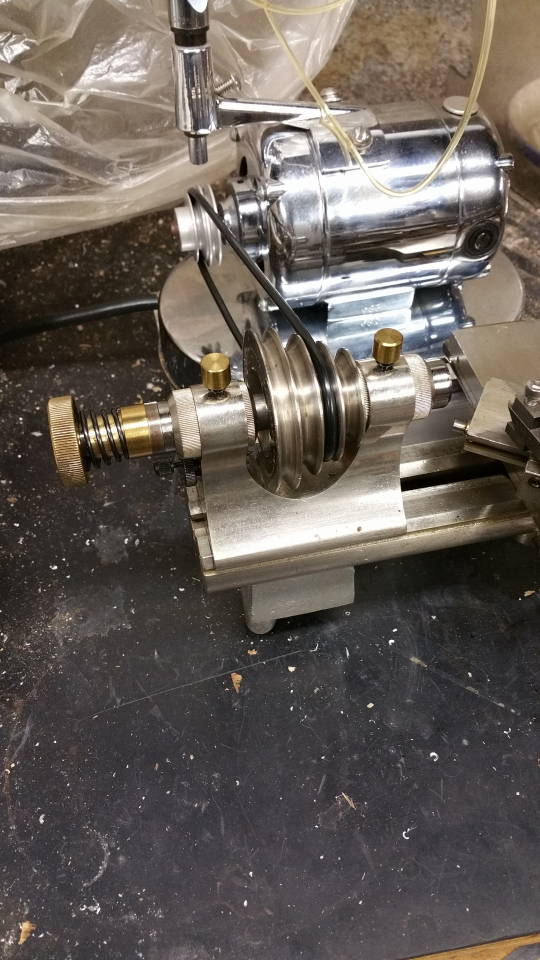

Thanks for the great info. But I have never had the spindle, of any of my lathes, turning continuously for more than five or ten minutes and the Boley is powered by an EMESCO 90N 22000RPM motor. So what would be a reasonable speed to run, checking the temp often, for up to 30 minutes to see how warm/hot it gets?
Oof, that's fast. Would have to know the pulley sizes to have a better idea what speed you're running, but around 2000 rpm would be great for most small work, I generally run 1500. So try around those speeds and see how it does.

Ah, didn't see the pics before. Those dental engines are really built for high speed use. You can make a simple countershaft that fits in the upper support where the dental handpiece works attach, something like a 5" pulley that goes to the motor pulley, and the pulley going to the lathe about the same as is on the motor shaft. That will give enough reduction that you can get the motor at a decent speed and still have torque.

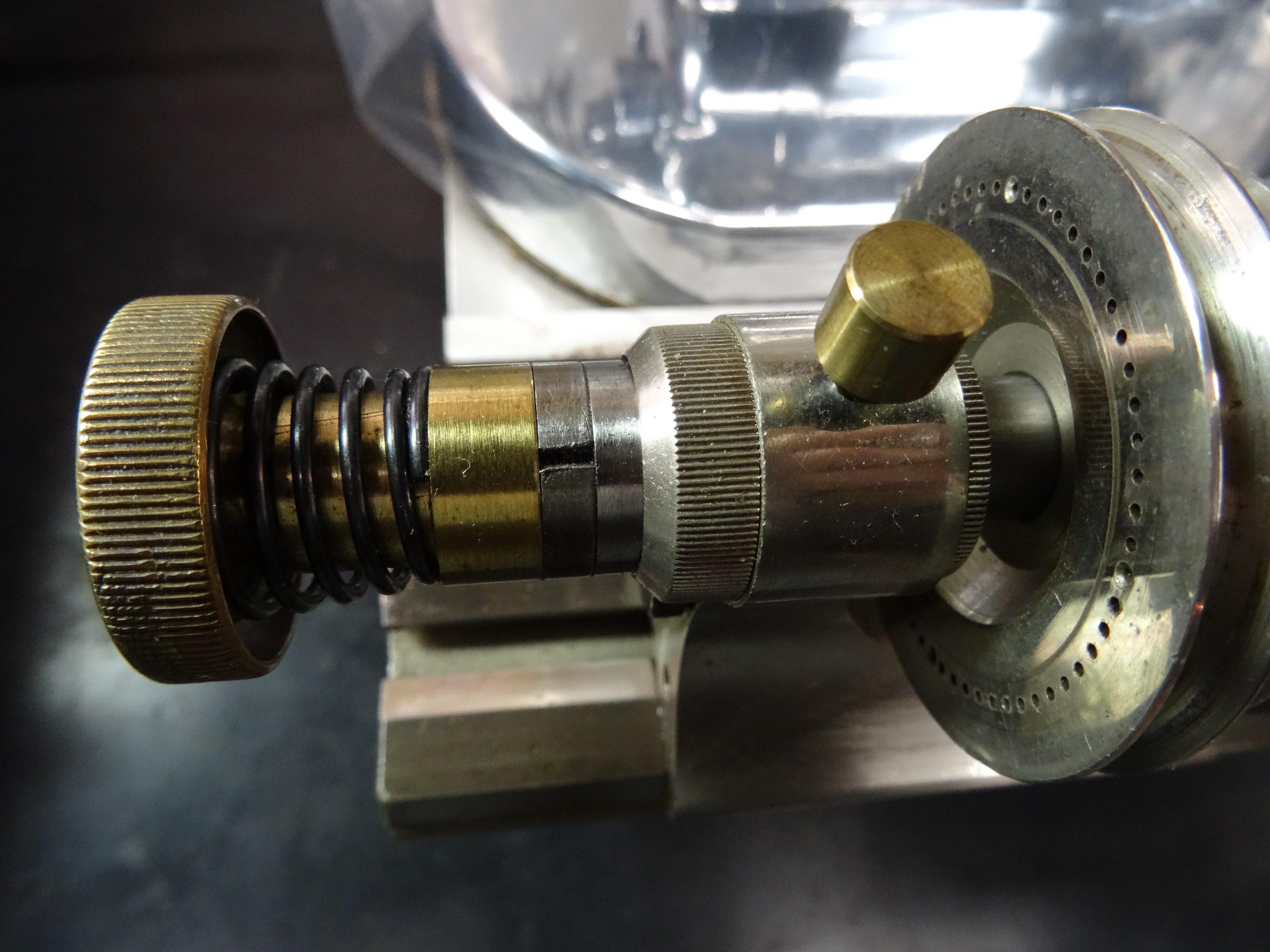

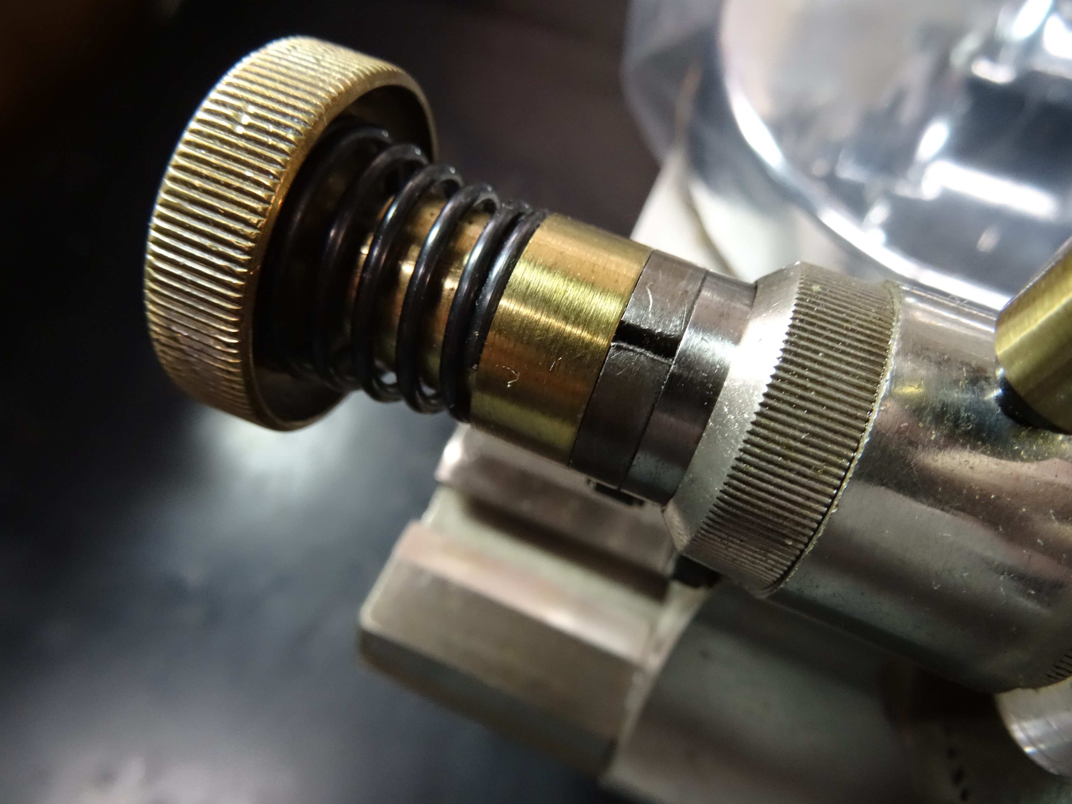

I'm curious about the headstock on that machine, what does the spring do? I've owned a number of Boley Leinen machines as well as other makes and never seen that; it almost looks like the adjusting nut for the bearing play has been replaced with a brass sleeve, and that spring in giving a preload to the bearings. But you must have to fight against it when tightening the drawbar? A spring preload is common in some types of spindles with ball or roller bearings, but quite odd on a plain bearing machine.
I think I need a slower motor. If I understand RPM calculations it seems, with the motor @ 22,000 RPMs and a 5"dia. pulley between the motor  pulley and the lathe pulley, it will result in the lathe spinning at 9167 RPMs.
Example: .75 motor pulley @ 22,000 RPMs = 5"dia. pulley @ 3300 RPMs = @ 1.8 dia. lathe pullet @ 9167 RPMs . Is that correct?
And there is an adjusting nut and I'm guessing a previous owner made the brass sleeve to incorporate the spring to apply a slight load on the  draw bar to keep it from loosening during operation.
Thinking about the home made sleeve with the spring, it seems a clever way to preclude a collet from working/vibrating loose.

The spring keeping the drawbar from loosening is a no go. I often tighten, delicately, on sub 0.5mm parts, hollow, in brass or nickel alloy, never ever once had an issue with the drawbar loosening.
