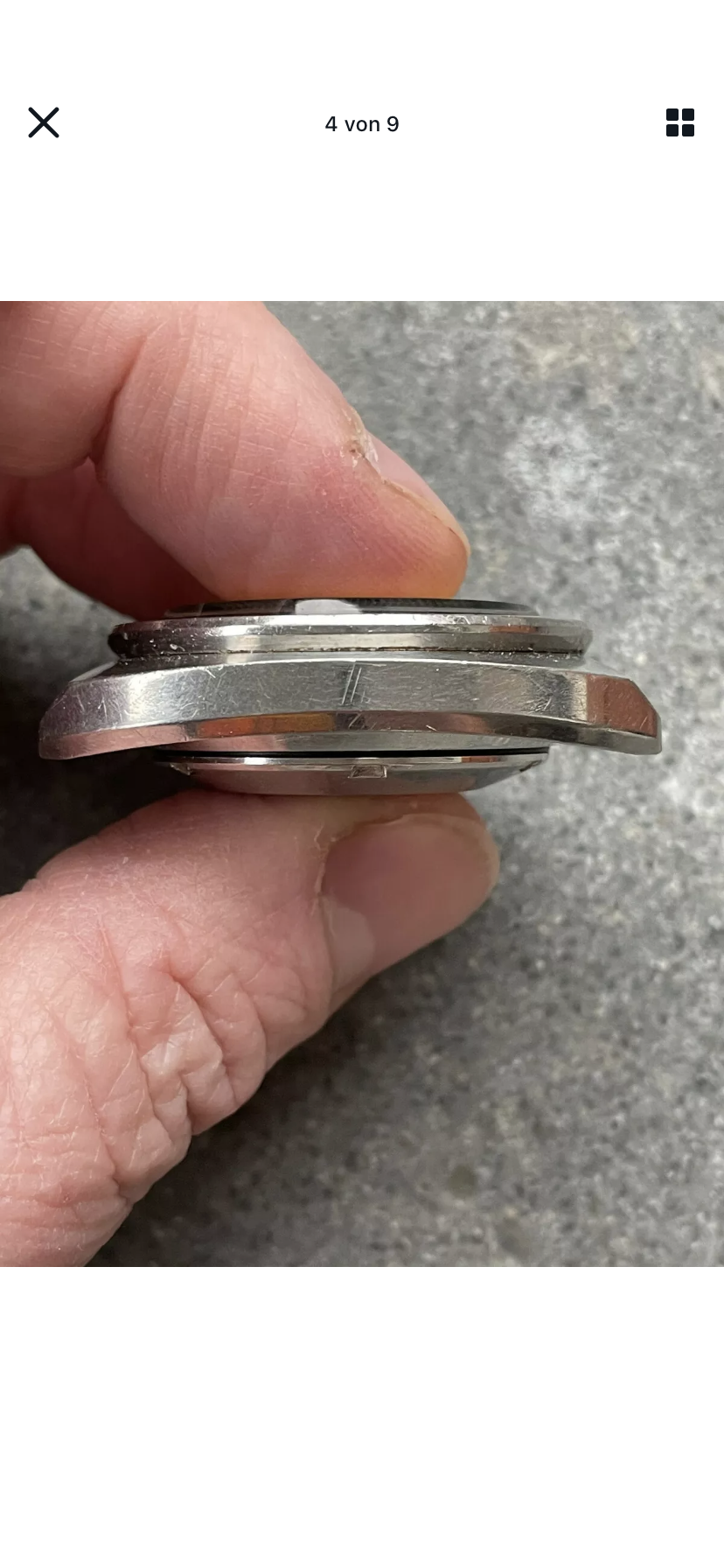

Yesterday I started to work on the case. First some pictures from before:318445F6-706B-4472-8E61-3818629AF243.thumb.png.53bc7266dc2f04e8b97888e63dc4ec32.png69EB2DA4-FEA7-403F-B0D8-88E295F1BBE4.thumb.png.67d23b52c38d8e6fbfbc2c4798757f5b.png76CA5251-FA56-480F-91A8-62626721529B.thumb.png.cd3037ca82f87216b6299afca2c51ce1.png
I started with a grid 100 file and that got out most of the deep scratches and dents. I used some water while filing so the removed metal doesn’t settle into the files too much.
after that I moved all the way up to grid 12000 and this is how the case looks now:
B060064E-252E-4B77-B517-E7C6DD68E61A.thumb.jpeg.f7ce43b051d2c39bf17b34055f0e20fd.jpeg898D78ED-952A-4793-8396-DC99E34316D0.thumb.jpeg.b82c9a034e0a39682dfb3b6a8715dc9e.jpeg
On the top surface I didn’t went up to 12000, because it will be brushed in the end anyway.
I think this already is a remarkable improvement. Getting to this point already took me hours.
next step will be to polish the sides with a wheel and apply the brushing to the top.

Looking good.  If I remember correctly I finished to high polish with Dialux Grey and then Dialux Green.  Used several soft mops in a Dremel. Need to change mop regularly for good final polish to avoid 'carry over' residues into next stage.
So here is the finished result, I‘m really happy how it came out:
78A722F6-91BE-4423-AB35-E6B354FFC2A6.thumb.jpeg.72f2bc94078e9cc67f1d4e0e1181bf0d.jpegF18C61AE-412E-44E4-8562-5375E901C1BF.thumb.jpeg.54b111af1cc0fb6c2bd9195e59364fd7.jpeg37913BD7-FF80-4995-9D50-8871D7DAD369.thumb.jpeg.004a2fe8dc6af3eb3a4c670f30560f0c.jpegAD6A2BDF-166A-413B-A4F7-9395D4BBB85A.thumb.jpeg.3207288f04a178c1804e390ba1476847.jpeg
apart from the uncle Seiko bracelet it is completely original. At the moment it doesn’t have the original crown installed, but I already acquired an original one that just needs to be swapped in.
