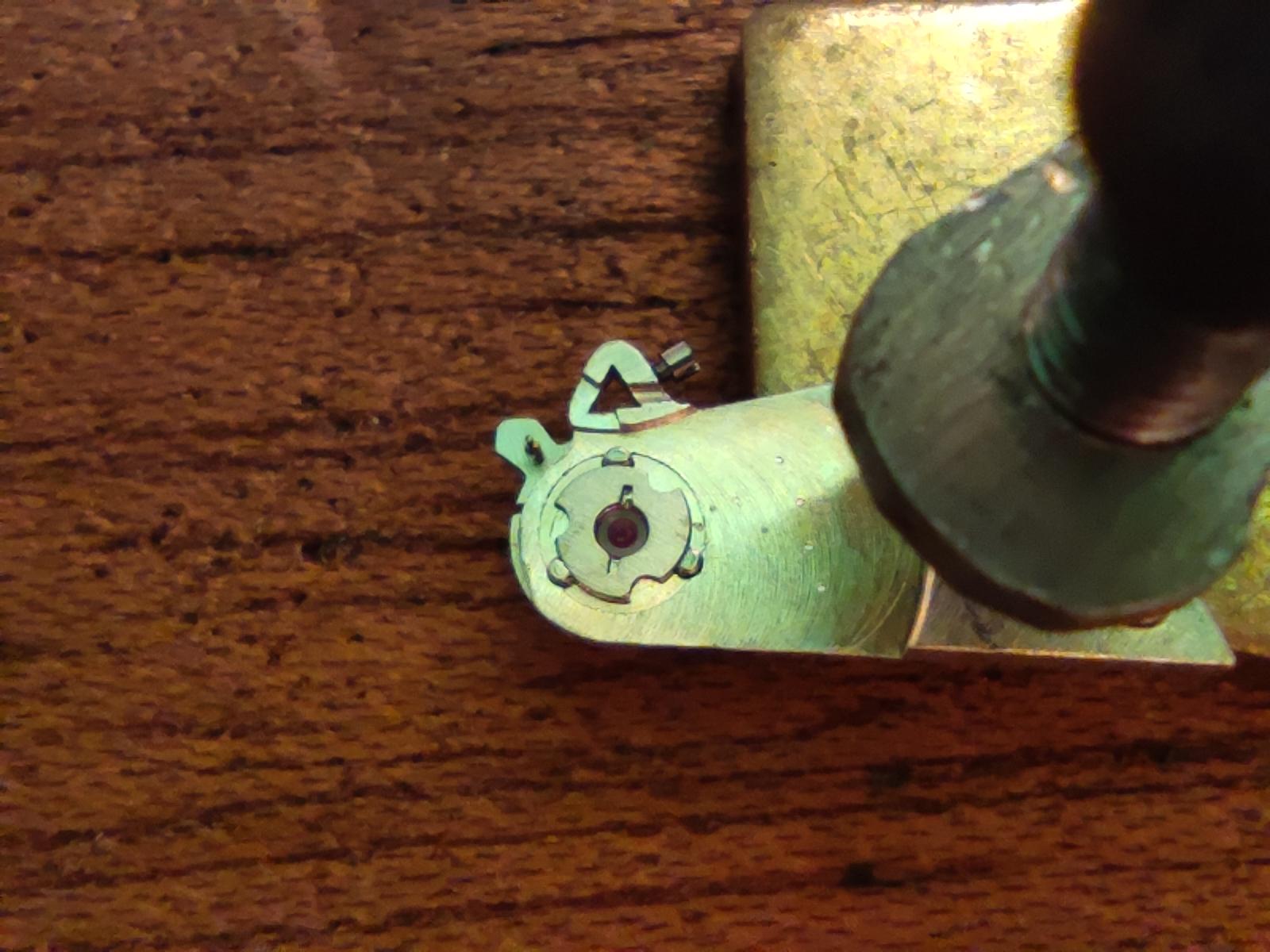

Not really a walkthrough but something I wanted to share since I've never seen it before. I 've striped down an cleaned a 1935 made Omega 23.4 SC calibre. Losened the balance spring stud and removed the balance wheel to take off the cap jewel when I found this piece of pure swiss mastery:
The regulator, regulator arm and cap jewel is one unit which is held by  three pins and a slotted disc serving as a bayonet lock. When you insert the screwdriver into the centre slot and turn everything comes undone and falls out. Like so:
You can very comfortabley grab the cap jewel now by the "handle" and clean it with peg wood in the benzine jar. The caliber is small - only 23.7mm across but the parts are so well made that putting it together again is a matter of seconds. I'm really impressed.
Same design can be found on Omega 30T2 Rg, which is 30mm calibre. I've seen it on Omega watches produced between 1935 - 1944, according to serial numbers.
