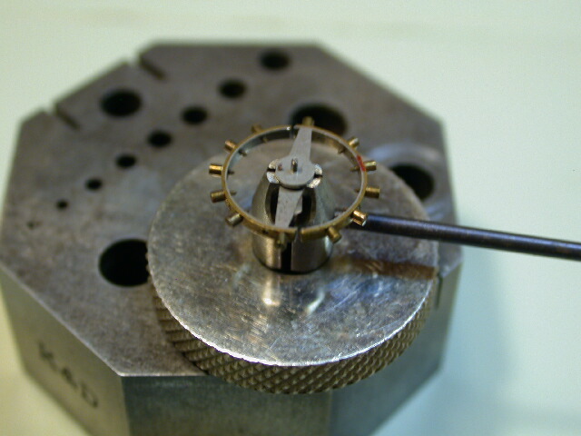

Found this in a vintage lot off the 'Bay. Ok, fill me in....
Looks like a set of Roller Removal attachments.
Very nice to have
http://images.yuku.com/image/jpeg/5431665d12db139c18759ea561df2fdc82a6c2d0.jpg

No kiddin, huh. Ok trying to figure this out so hold the knurl, and turn the "cheater bar" and the roller table will pop? Is that what I'm seeing?
I am afraid nothing will pop: you turn the "cheater bar" to close this tool in order to hold tight the balance and provide support for the Roller. Then you bring a punch and trusted hammer! Boom!
Make sure to align the roller in such way that shellac does not get damaged
Once the roller is supported you take appropriate punch to force the staff out. Let me search for Roller Removal video, but the thing is that Staff Removal is the next step, right? I recommend getting K&D staking tool set #18 with Roller Removal and Staff Remover attachments.

Nothing to worry about - the best way to get such tool is to buy a nice #18 K&D staking tool.
Btw, this particular "staff removal tool" is not really that great, but it does the job (not always ? ). Basically it prevents balance wheel from warping while you knocking the staff out.
