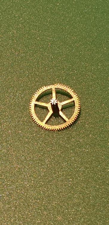

On another note, I just completed the cleaning of all the parts except the keyless works. I managed to find one of the train wheel teeth to be damaged (image attached). I believe this is the seconds wheel?
Interestingly, when I first opened the watch - a while ago - I noticed the hair spring from the balance had come off and had gotten wound in the train wheels.
While taking the watch apart, I tried to unwind the power by disengaging the click spring but there was no response on the crown. And then when I took of the pallet off at a later stage, the whole thing unwound rapidly
So many newbie mistakes. I'm not sure which of the above damaged the wheel.
I would imaging the sudden release of power is what has destroyed the wheel, unfortunatly from my research information and parts are hard to come by for the ricoh watches. Probably best to trawl ebay or others, speedetimekollection, in europe, welwynwatchparts.co.uk, obsoletewatchandclockparts.com (UK)   then there are Jules Borel, esslingers, Timesavers in the USA  are probably worth a look ,   I wish you well, good luck.
