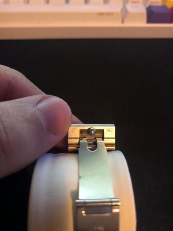

So my beautiful Omega Constellation watch's band clasp pusher is stuck (the thing you push on to release the clasp). I think its because the springs inside of it are either bent or broken.

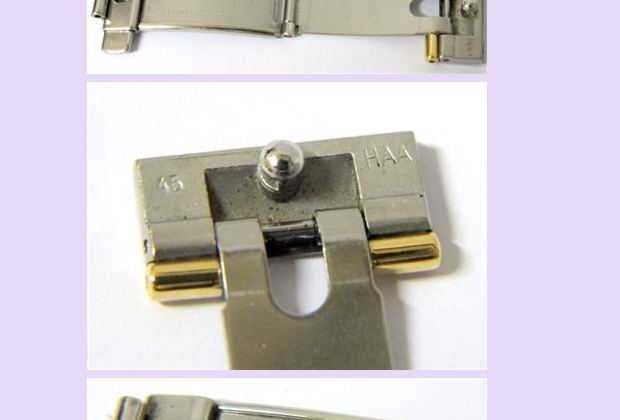

I took it to a watch repair shop and they said they'll need to replace it. So I figured i'll just replace it myself so I went on ebay and found one that looks exactly like mine (i'm not going to link it because i'm not sure if i'm allowed to, please let me know if i am so i can link it). But when i looked at the pictures, i noticed that the numbers on the clasp are different to mine. I also took a picture of MY busted clasp's numbers which I have attached.
Their one says 45   HAA  and my one says  37   1BC
So my question to you is, will this new one fit on mine?
Thank you!

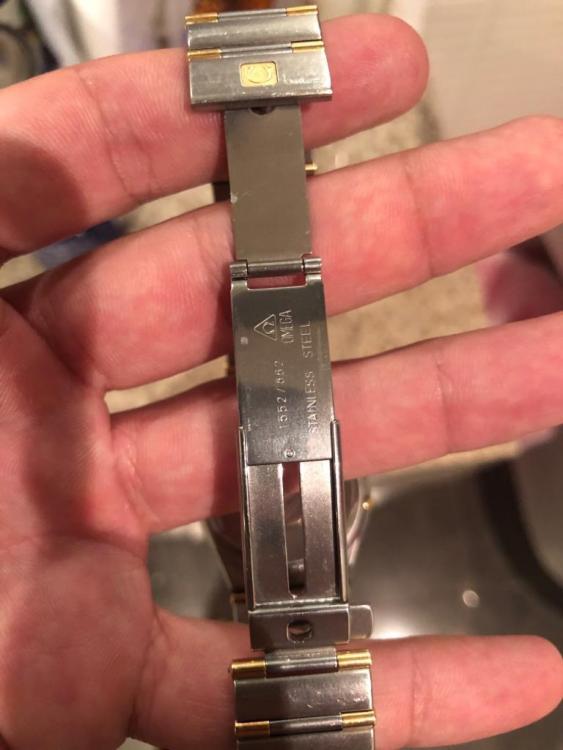

Can you do some more photos which show the whole of the bracelet and both sides of the buckle.

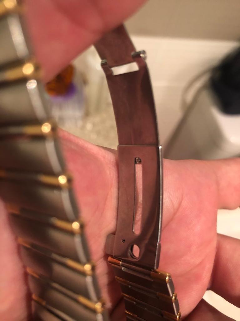

@Alaskamick Yes, my Omega Bracelet is genuine, it has other numbers on the .. slidy bit, it sayss 1552/862  STAINLESS STEEL. I have attached 2 photos of what you asked for.
Thank you again for your help! There's a little screw right where the pusher is - is that the screw you're talking about?

Slightly different to mine but I can see the screw on the pusher which you mentioned.
I'm sure that if you take that one out then the pusher will slide out together with what ever type of spring is in there.
I you post a picture of the dis-assembled bits someone may have a suggestion how to fix it.
You can't do any harm to it.
If you can't make a spring you may be able to swop the bits from the one on Ebay.
Keep us in the picture:)

The buckle is a separate part from the bracelet so all that matters is the length of the tubes on the ends of it.
if they are the same size you can take the one off the bracelet you buy and fit it to your own. That will keep the watch original.
You will have to contact the seller and ask for an exact measurement.
