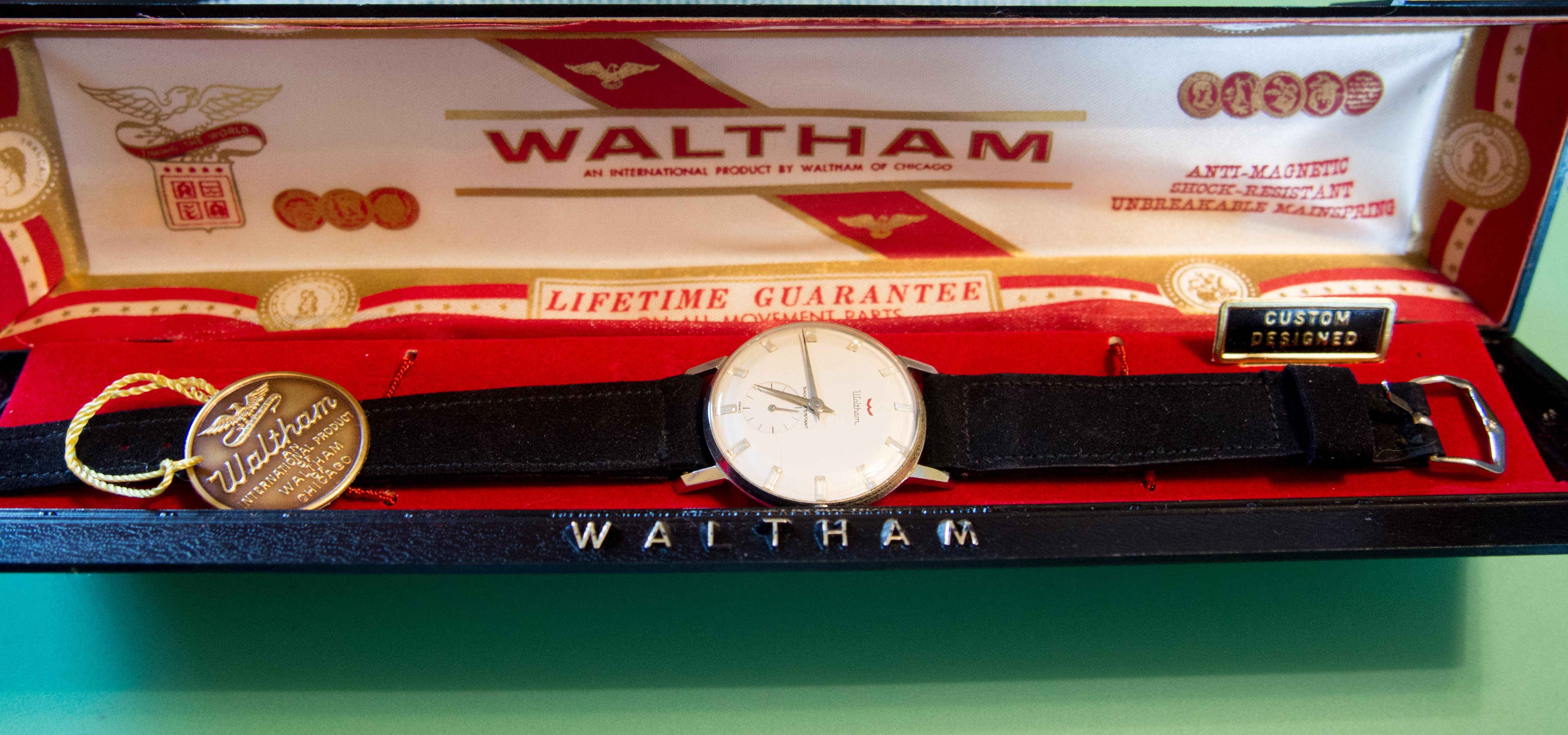

There is a little more to the story - which you may enjoy. The watch who's ratchet wheel screw broke - is an almost identical copy of a watch that means a lot to me (sentimentally). I found it on eBay in NOS condition and purchased it so that I would have a spare part of everything for the watch.
The new one was so beautiful that I decided to wear it (some) - since there is no sentimental attachment to the new one. But it does remind me of the watch near and dear to me. Which, by the way is also in mostly excellent condition for a watch of it's age.
I should  post pictures of the two so that you can see them. The one I recently purchased is completely amazing. It came in the original box, with tags and the original strap. Not unworn, but almost. She's a beauty - and so is the one I have had for decades.

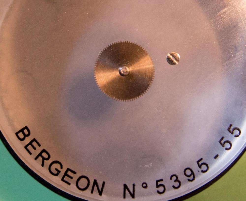

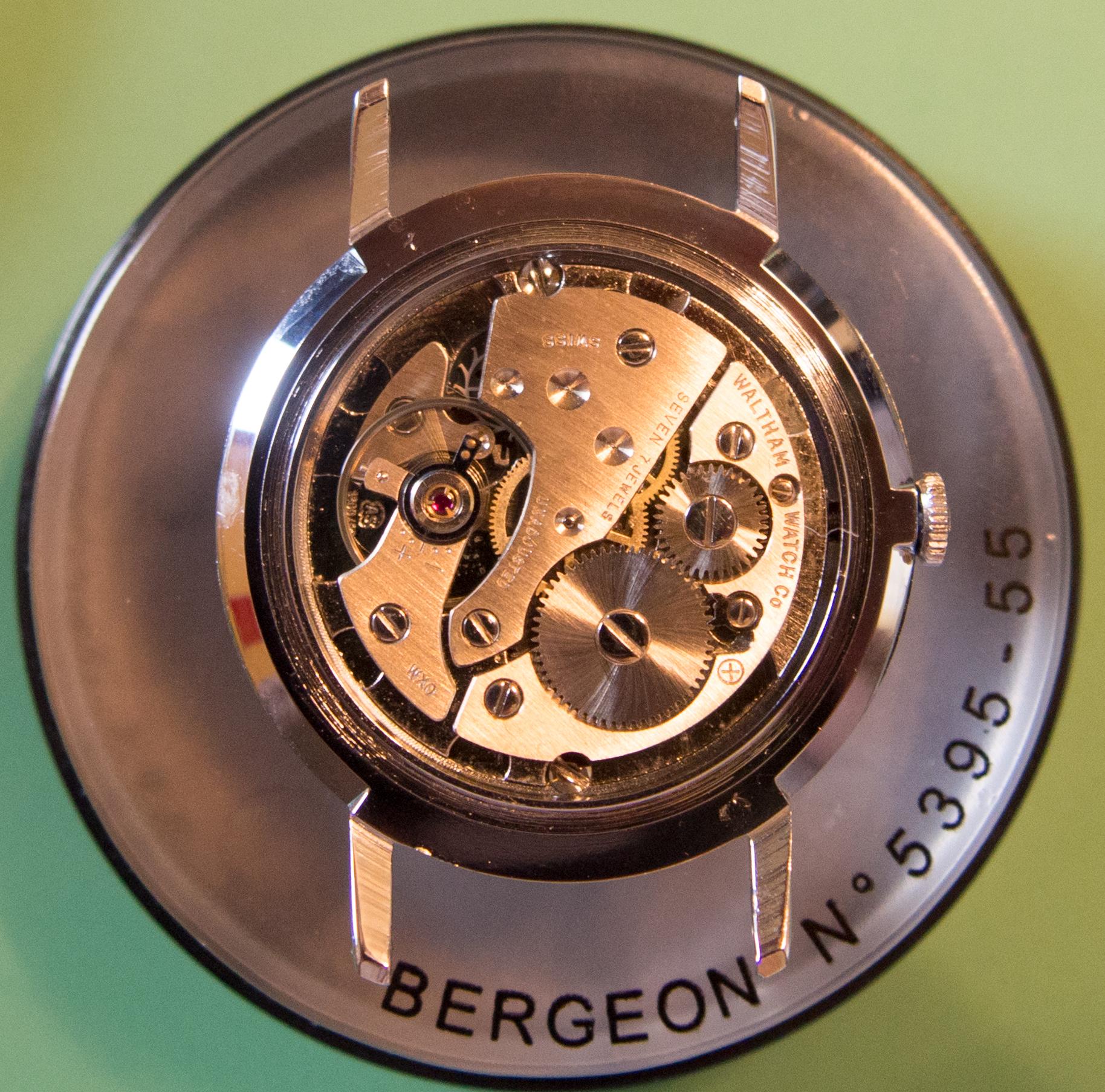

I ended up taking the barrel and ratchet-wheel screw from the "parts movement" that you found on eBay. I also purchased that NOS 1790, but the movements in these watches are the larger 1692. Still gives me a complete unused movement for parts.
Attaching some images - not sure how this is going to be formatted in the post (perhaps should have inserted using links).
But in the order that I think they will be in:
1) The newer movement fully serviced with the new barrel and ratchet-wheel screw.
2) A look at the dial before remounting in to the case.
3) Look from the rear - all mounted with the back off.
4) From the rear - with the back on.
5) The parts removed (barrel assembly complete with broken off screw head).
6) The two watches side by side.
7) My great uncle's watch from the rear with the original strap mounted (this strap came on the one I just acquired).
8) My great uncle's watch from the top in the correct original box (also came with the watch I recently acquired).
