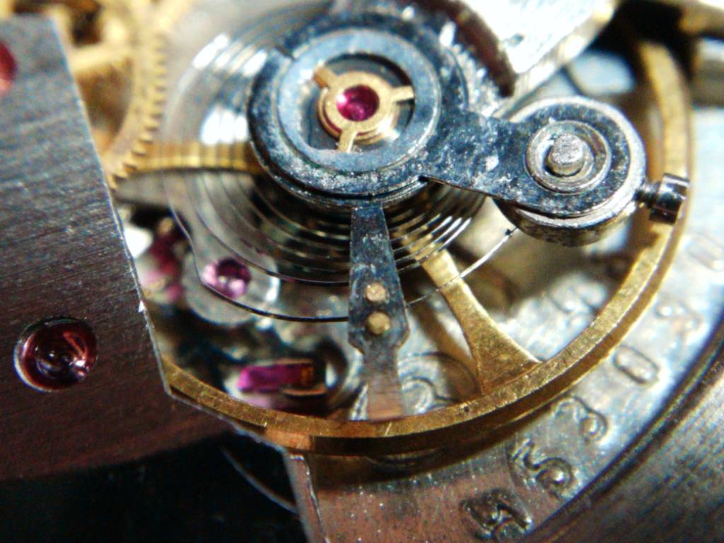

The first thing I noticed is the movement needs cleaning. The second thing is it looks like the hairspring is not exactly centred. IMO before any further adjustments it needs cleaning and lubricating.
The hairspring is definitely out of center and possibly oily. remove it  place it inverted in a bowl  that you have filled with some sort of cleaner, non chlorinated brake cleaner from the auto parts store works well  a quick dip will usually remove any oil. See what that does..these can movements with some patience  be brought into line very nicely.if you have wavy traces you might have a wobbly escapement wheel from what I seen in vostoks , its the part that tends to wear out first.

I have a couple updates: first is the stud that is held in the beat error correcter was inserted far too deep. The adjusted stud can be seen in the first picture.

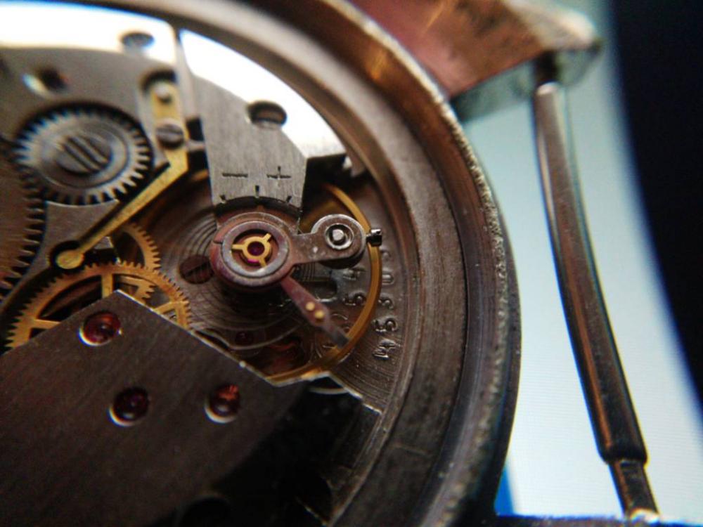

Second, it's now mostly in beat aside from a speeding and slowing seen in the second picture. From what was mentioned here, there's a good chance this is due to dirt on the balance. When I get some proper cleaner for a 1-dip, I'll revisit this. I also need to search the forums for a good set of oils as I only have one weight right now.
This movement was my first full tear down and repair, and being so new, I didn't remove the mainspring from the barrel for a clean either. Not the most professional repair but a good learning experience.

The wavy traces is exactly what i'm seeing right now. Its only about +- 20 s/d which after a few days will hurt the accuracy. It was a junk movement sold for parts, so I'm not surprised. I do have a spare escapement wheel from the same movement the balance wheel + hairspring came from. If it gets worse, I can swap them out.
You have to assume these movements have seen no service and that they have have extreme wear. That being said they are pretty robust.as far as cleaning the hair spring, mineral spirits isn't the best, although  it works fine on hard parts such as gears and such. It does seem to leave a bit of a residue that makes the hairspring stick to itself.I just don't think it is refined enough. I have had good luck using naphtha and brake cleaner ,they are more volatile and evaporate more completely. You might want to order a few more of these movements, or even complete watches. they are cheap enough. It just seems that intact watches seem to work better. they have been left intact for a reason. just as bare movements have been disemboweled from their cases  for a reason, but,.nothing is a sure bet .

I originally left the balance alone with the mineral spirits. I decided to make due with what was on hand and give it a short soak in some Ronson lighter fluid. It's pretty pure but I'll be looking for something better later. I popped the cap jewel off and gave it a little oil and it seems to be running better.
One point I forgot to mention before was facedown, it was in beat, but face up it was way off. With the clean and oil it's running consistent both ways so I wound it up and I'm going to let it run overnight and see how it does.
