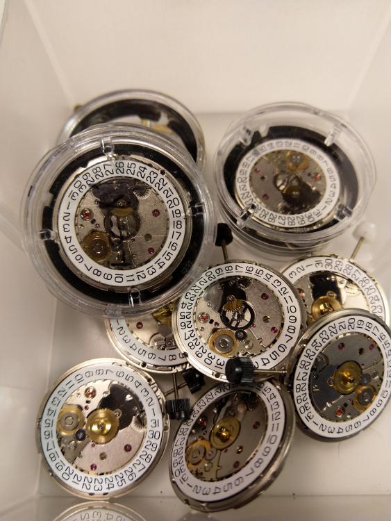

Since I have a restless brain I today decided it was time to practice on an ETA2824-2 Movement.
I pulled the practice 2824-2 movements box out and blindly  picked a specimen.
But soon I realized the pictures probably are so many it would be hard to upload.  So I made it to  a two part PDF series instead.
Part 1 2824-2 Disassemble.pdf
Part 2 2824-2 Assemble.pdf

Excellent pdf’s and good timing, thank you as I’m currently working on one of these exact movements, and so far the amplitude is awful! Bit more work to do.
By the way - you have eight 2824-2 practice movements? How on earth did you manage to get eight?!!

Only eight! Then I must have misplaced a bunch of movements somewhere.
Like all scientists I suffer from a restless brain, this is nowadays confirmed by genetics. One of
the manifestations or symptoms is the urge to quite the voices in the head by manically investigate
a claim someone maid (ETA). In this case I probably had to see what really differs between the different ETA 2824-2 movement variants.
The conclusion was .. after some tweaking with the simpler model the biggest difference was mostly cosmetic.
It’s one of my absolute favourite movements. Simple, robust and with good enough precision.
