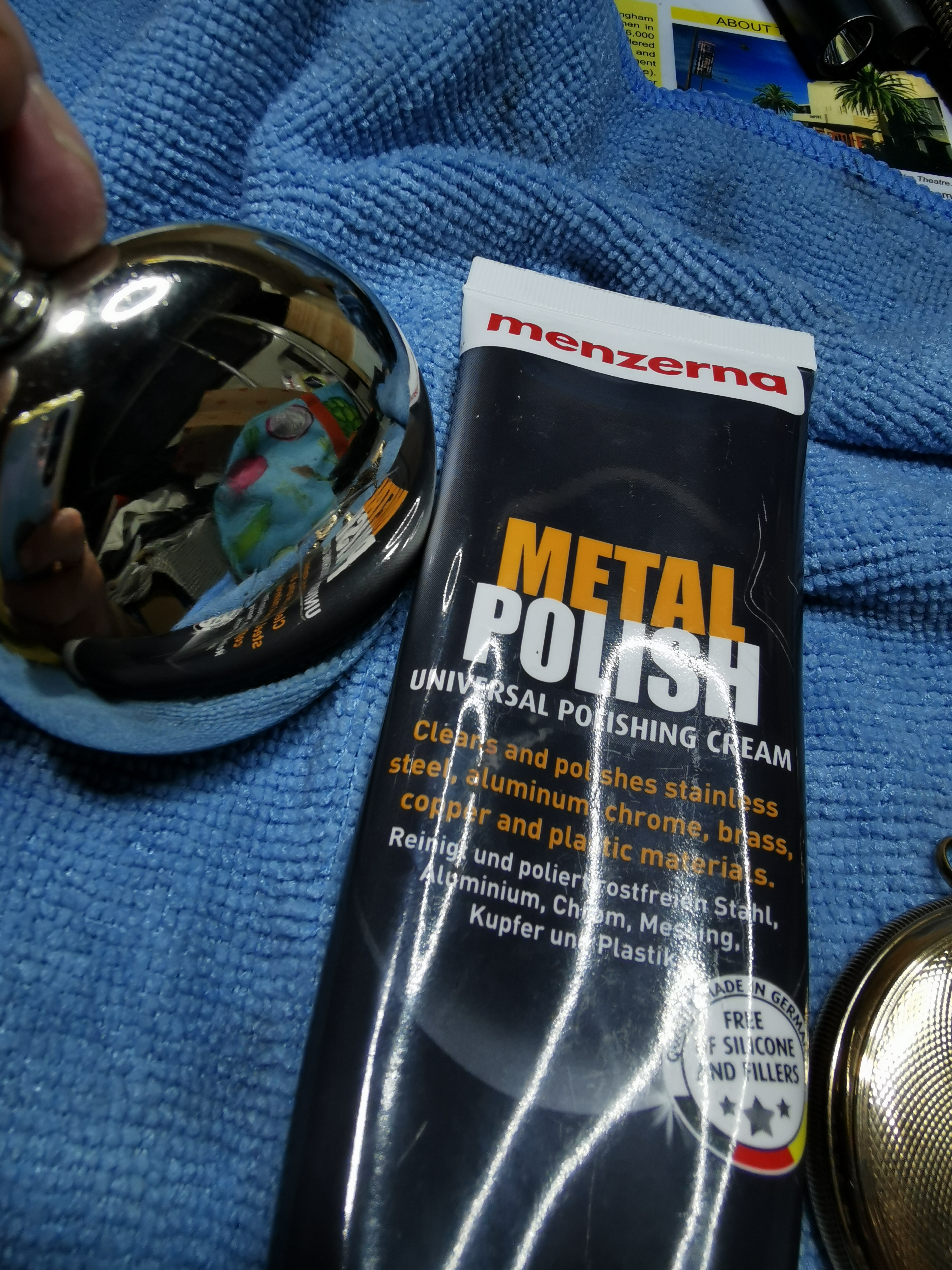

  2. Hi there, just wondering what everyones thoughts are on polishing your watch collections. Yesterday I pick up this nicely working grade 1 1908 Waltham pocket watch. And the first thing I did was polish by hand the nickel silver case to see the condition of it. I use menzerna universal cream on all of my collection. Gold plated, gold filled, silver what ever. Even if some plating has worn off they still turn out nice and shiny. Do you guys and gal's polish your collection? Cheers Graziano
