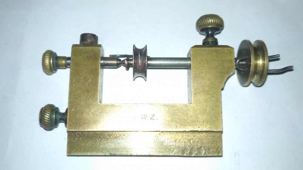

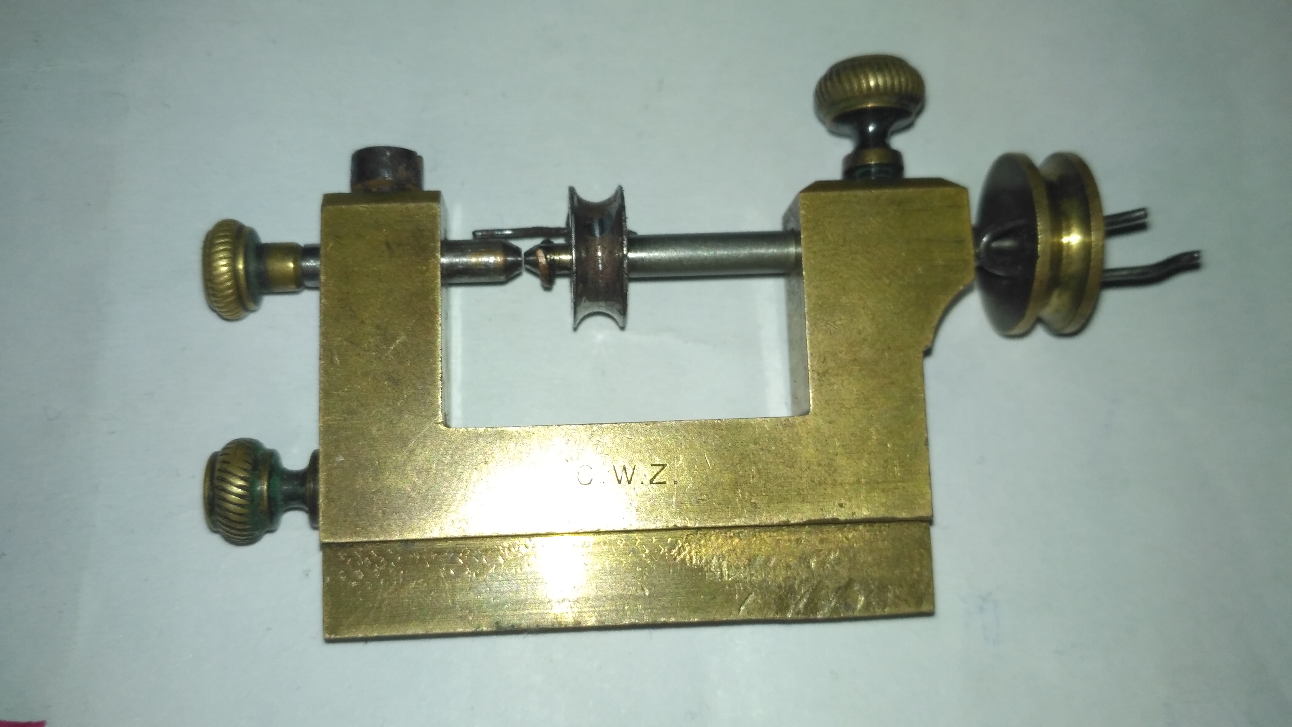

I am new here on forum and I have a one question I have a pivot drill that I bought on a flea market really cheap and it wasn't in full set so what will be your suggestion on how to use this tool?

I bought it as it's on photo and I am thinking on how to hold the balance to get drill straight to the center of the staff.

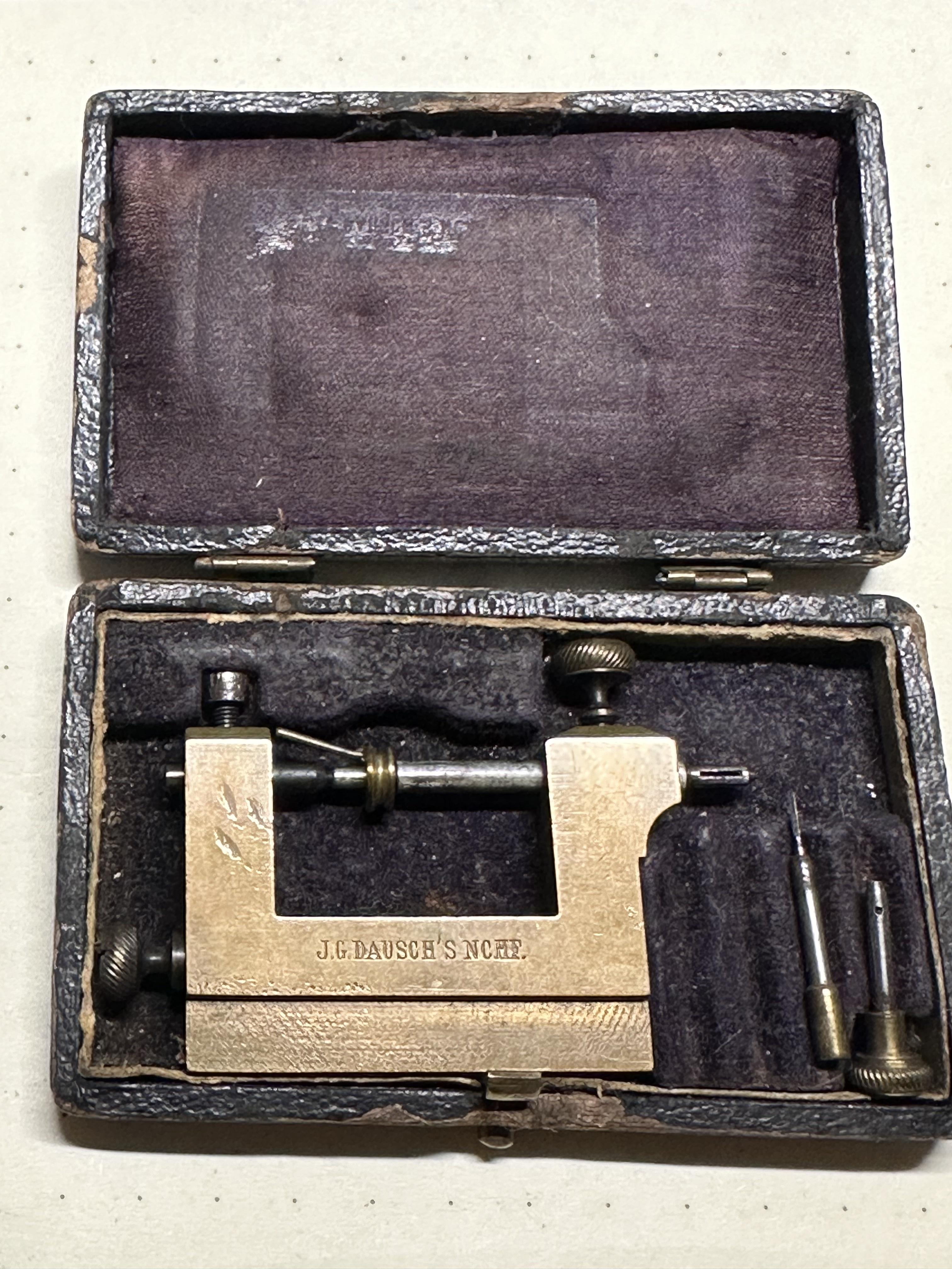

Looking at the photos it looks like it's missing a few pieces. There should be several sizes of hollow end arbors that hold the work while you insert the drill. There should also be a drill holder. Have a look at this one:

Yes now I see it's missing some pieces.
I wanna think what kind of use I can get from it.
Without all the accessories, I'm not sure if you will be able to use it as intended at all. You also mentioned replacing a balance pivot with it, unless the balance is for a clock or something on the larger side, you'd be better off replacing the staff. This tool is meant more for larger pivots, such as for the train wheels and the like, a balance pivot is simply too small.
