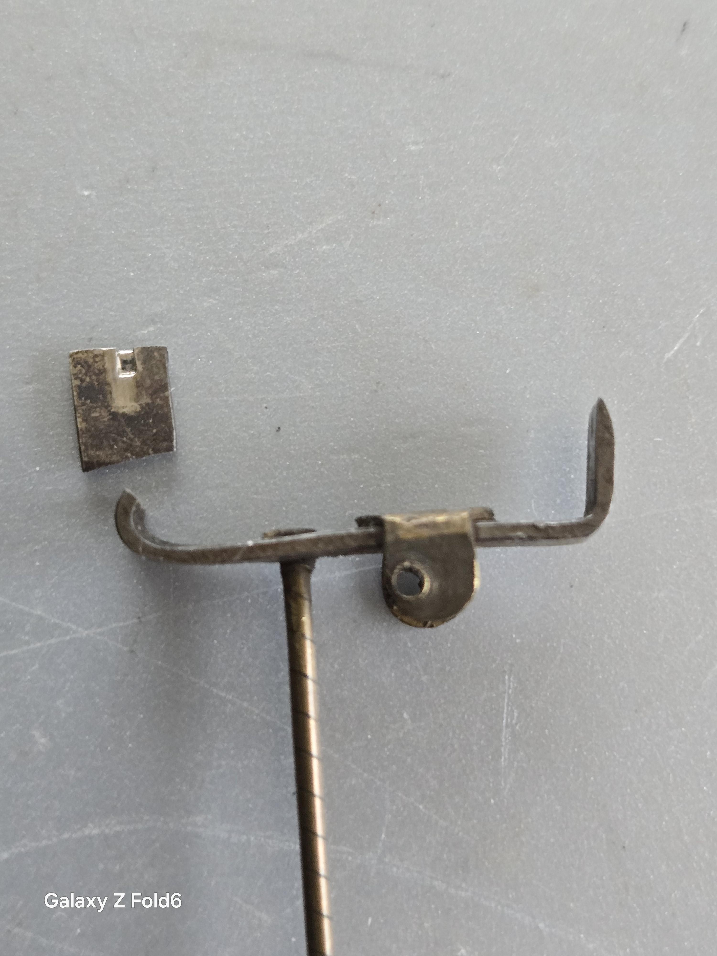

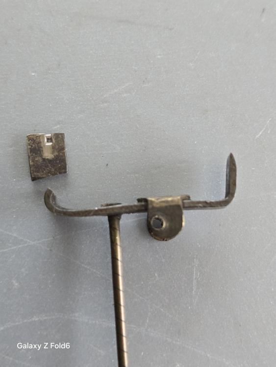

Broken anchor pallet
By RichardHarris123 · Posted
