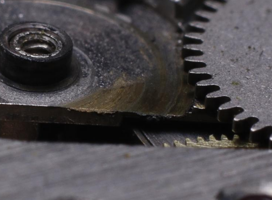

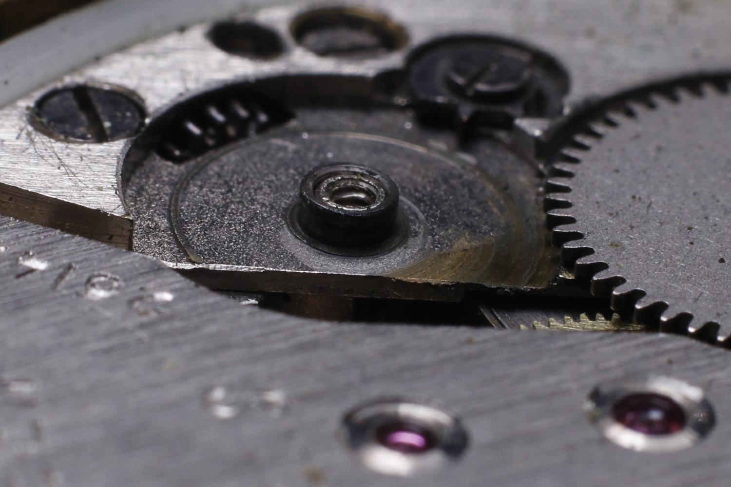

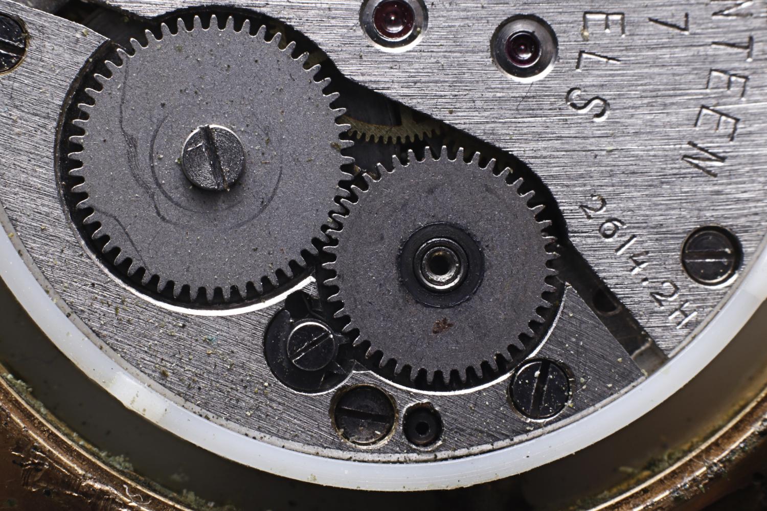

Worn mainplate under crown wheel

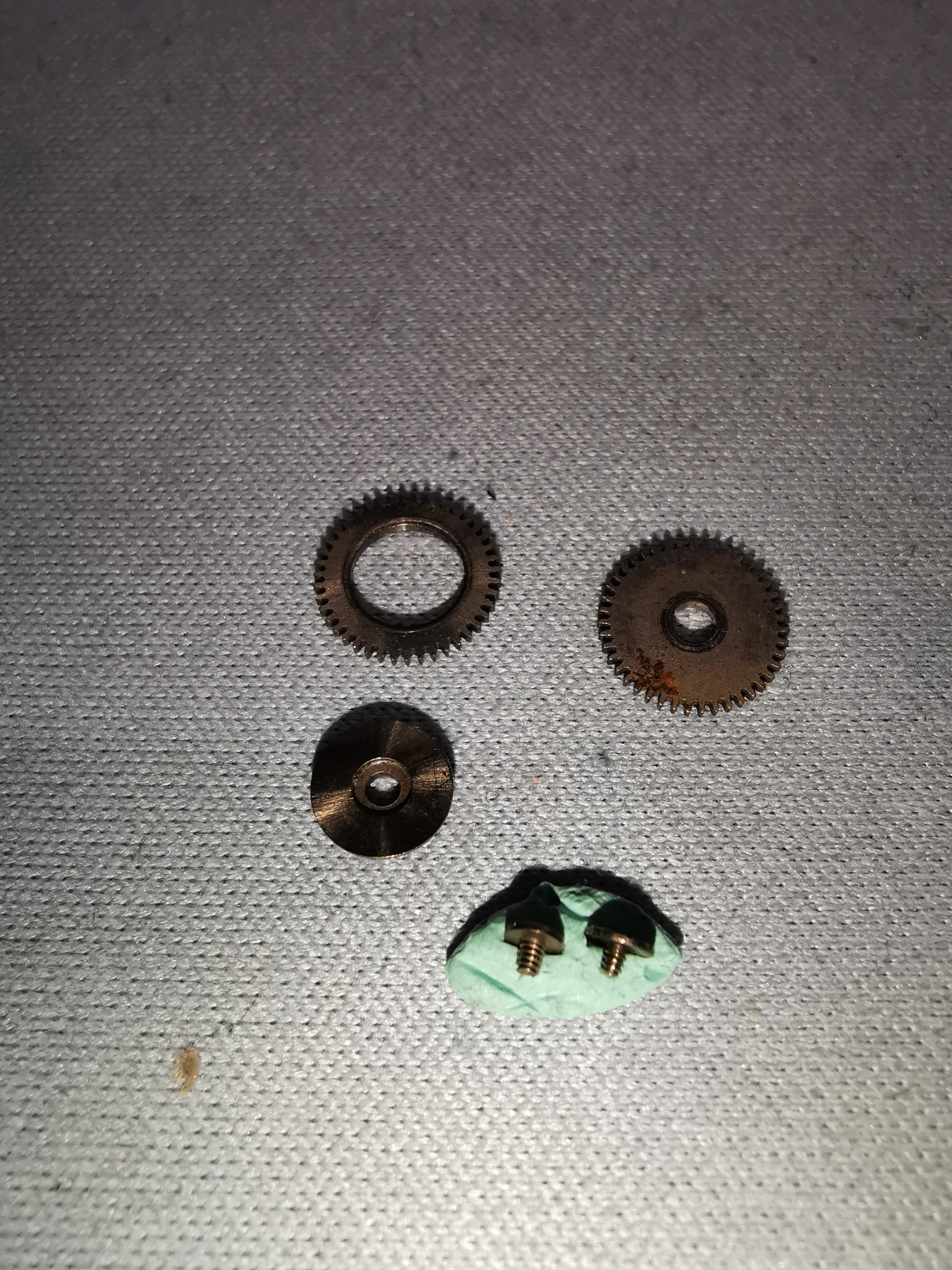

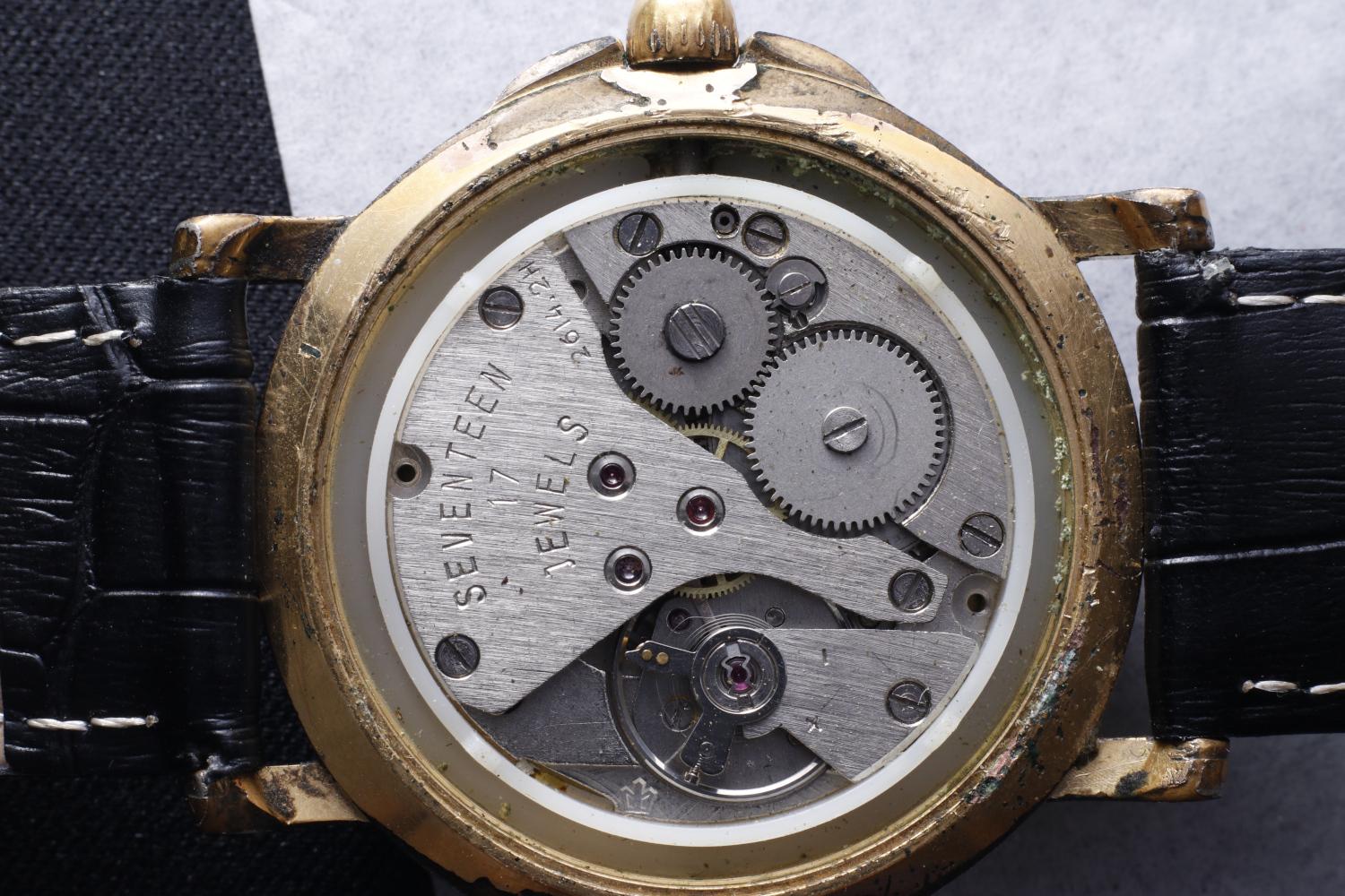

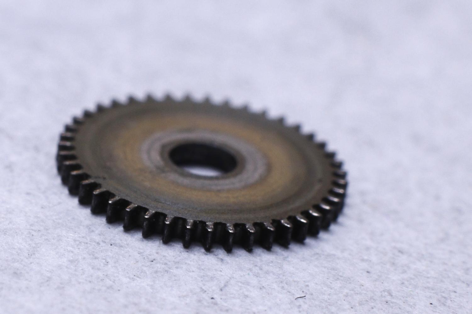

Ok so I'm certain about the escape wheel being the biggest issue here. I cannot get it into place, and if i do, it just pops out again. Jewels look fine. Pivots look fine, but I can't see them in detail. Maybe I order a new escape wheel?
The pinion side pivot looks light. How well can you inspect it ? Does the end seem flat ? How is its cap jewel looking ? You sure the pinion and the wheel of the escapewheel can turn independently of each other ? -

That sounds like the wheel is loose. You might need to source for a new escape wheel.
