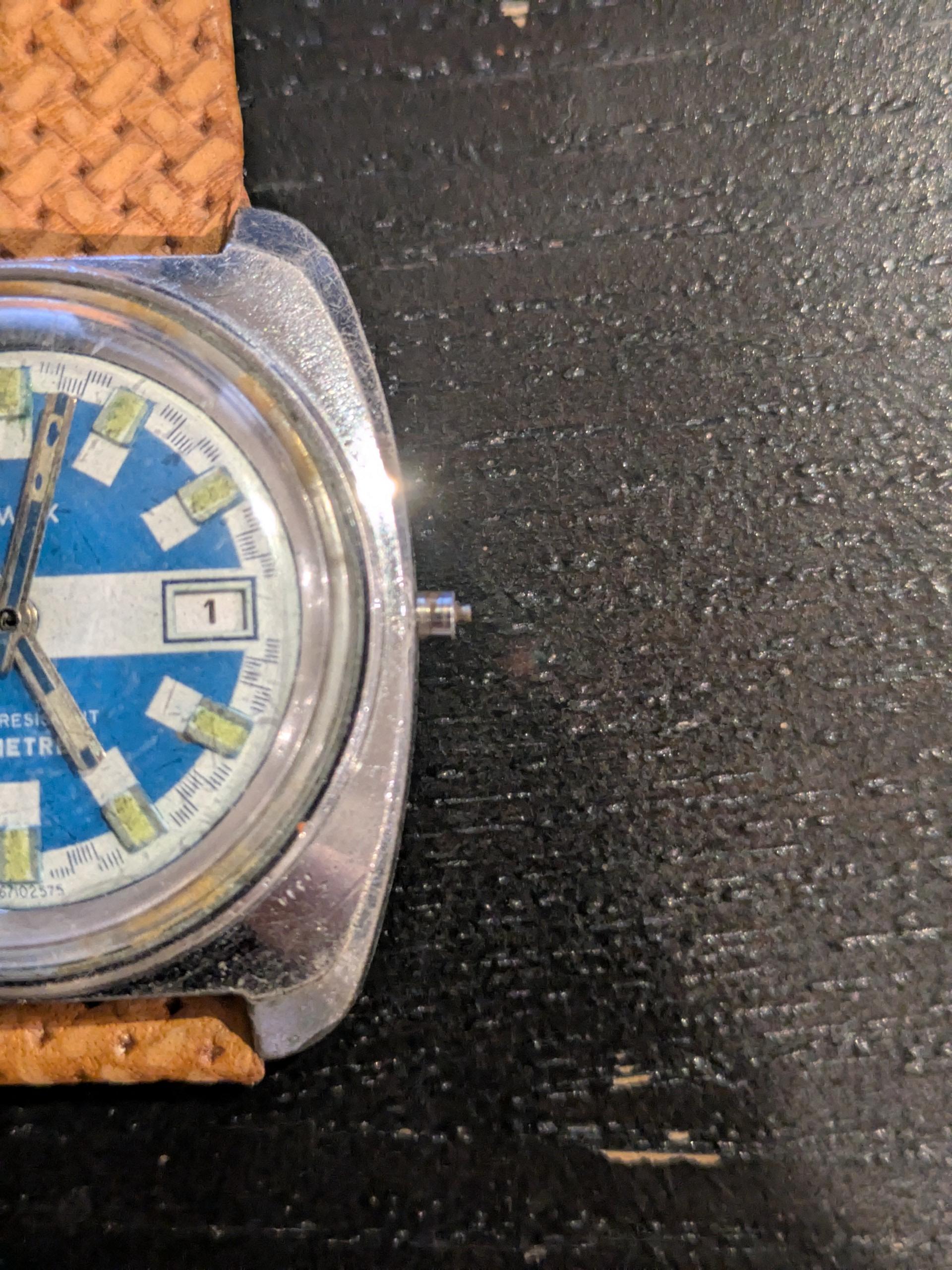

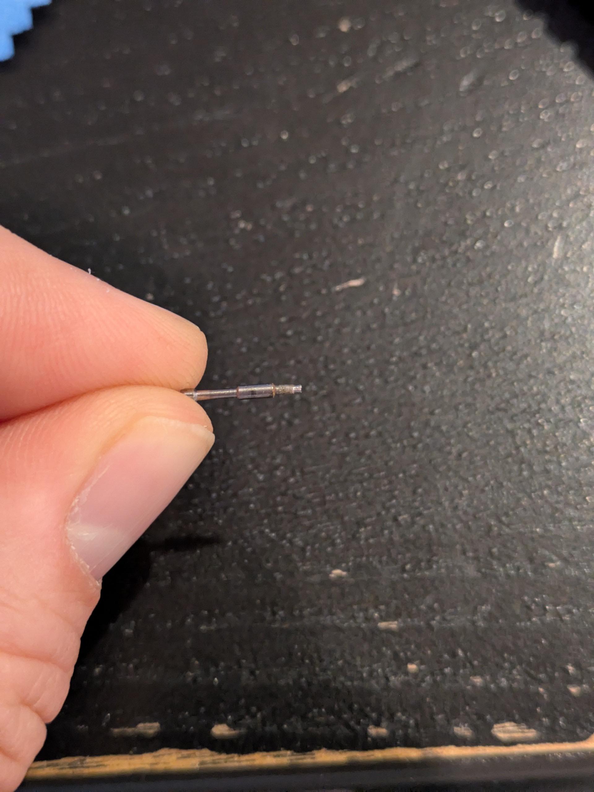

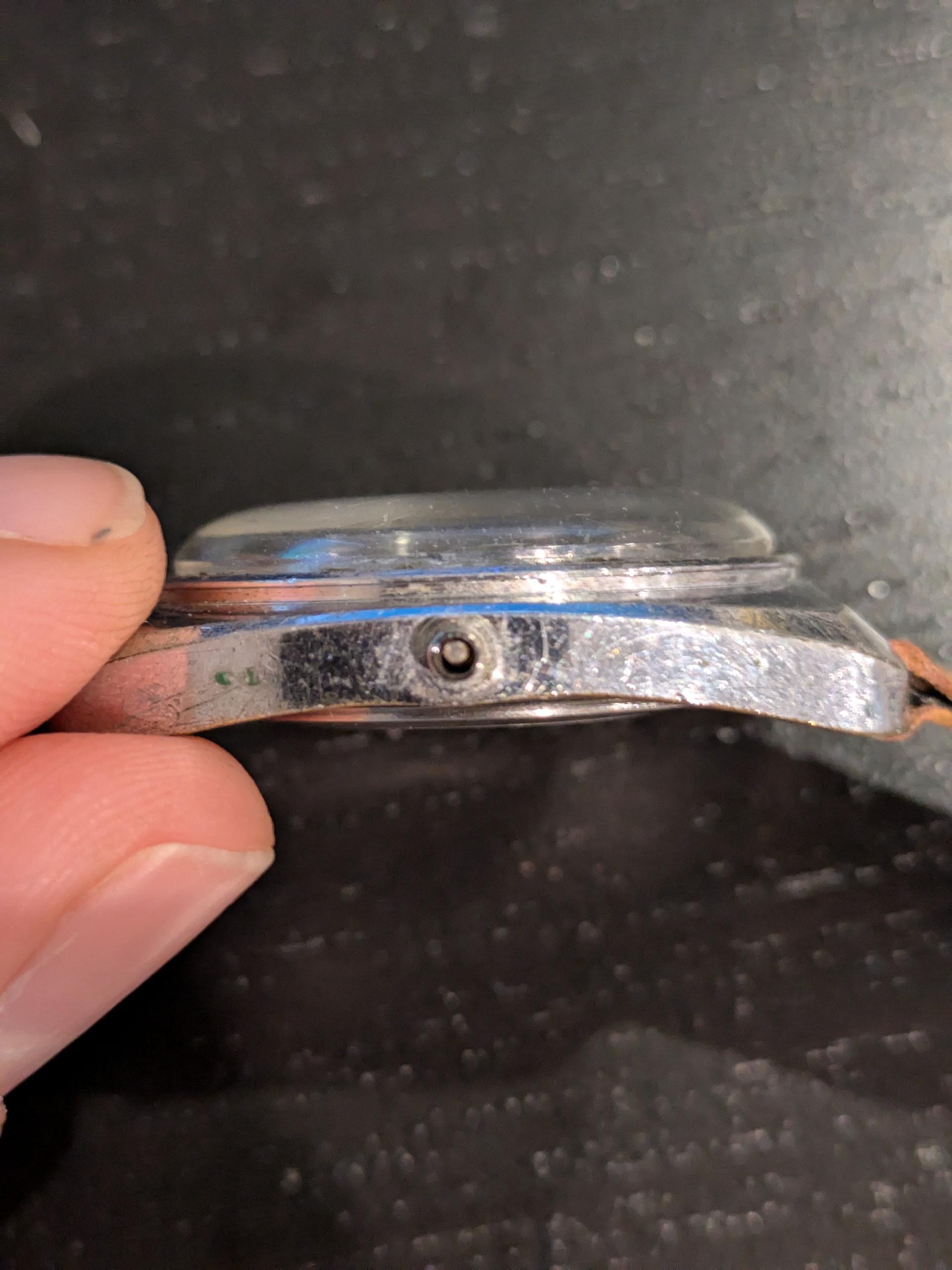

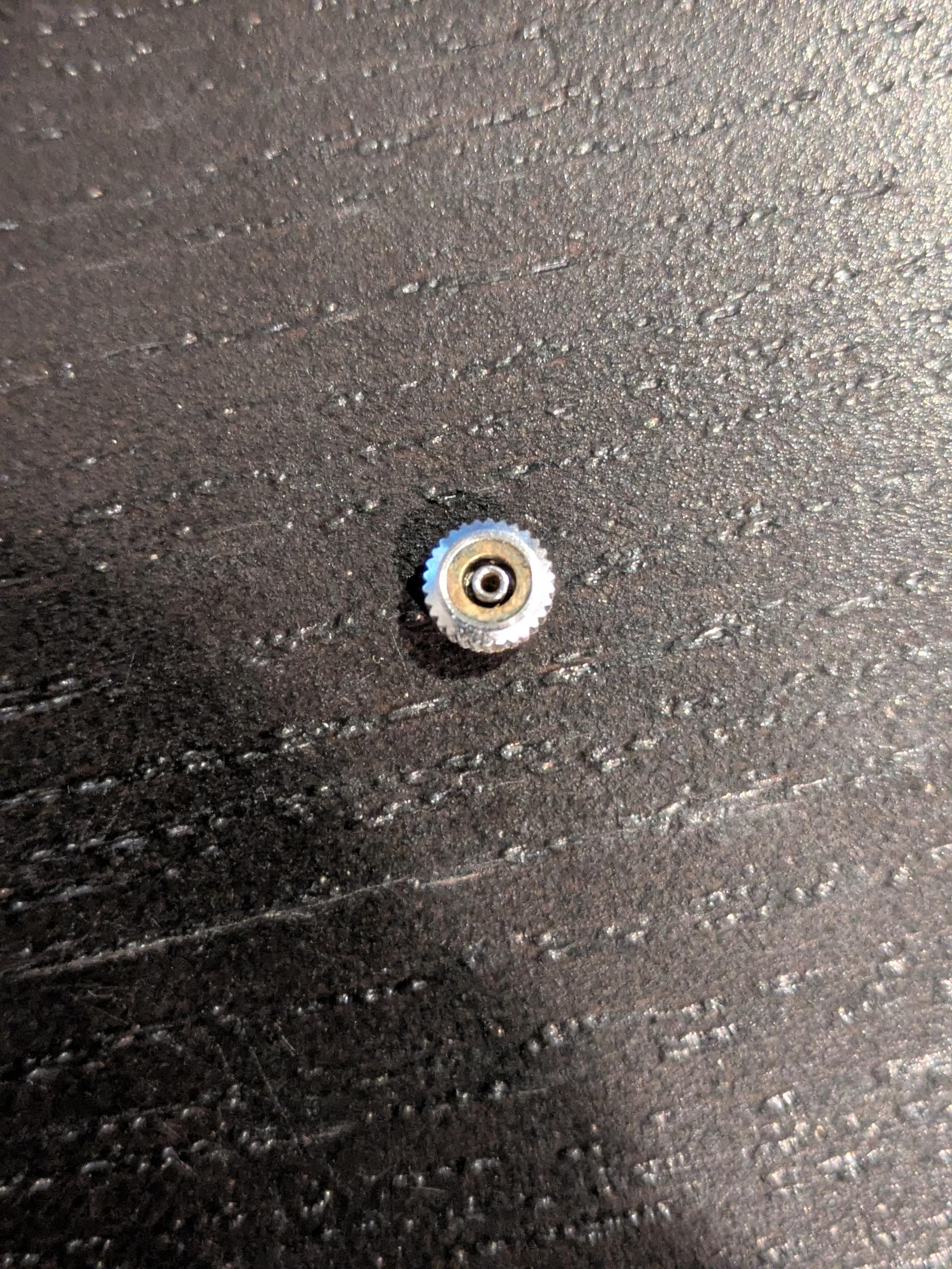

Timex Merlin Crown will not Stay on Stem

I would go for the red Loctite -
Here is a pic: It sticks out about 1mm from the case tube (thanks again for the terminology!). Remember as well that the crown not only allows the stem to slide in, but the case tube also is fully inserted into the crown as well. I eyeballed it and it seems to me that the stem goes into the crown right up until the crown goes convex so I don't think it could go in any farter which would lead me to believe it wasn't snapped off (I hope!).
