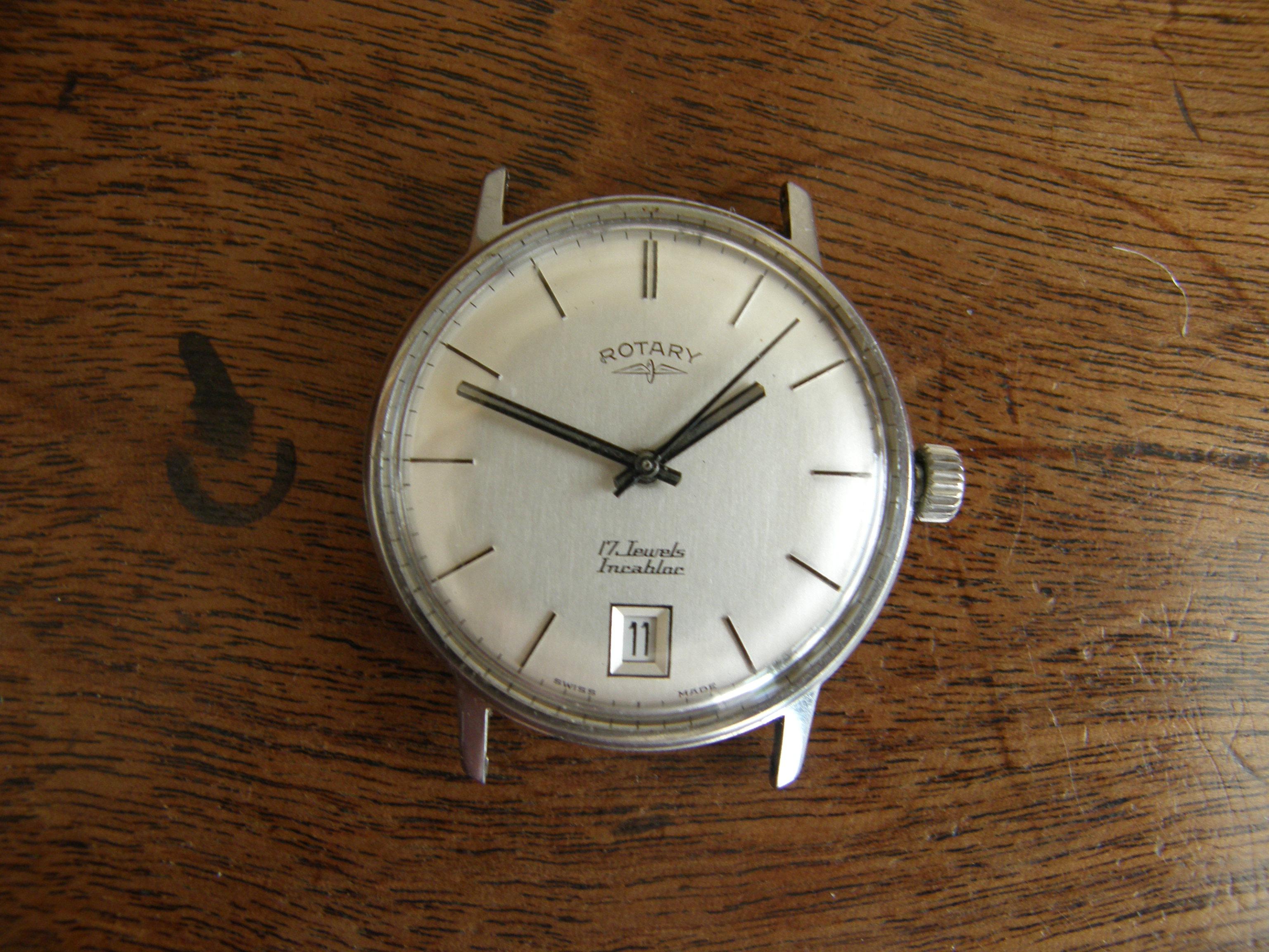

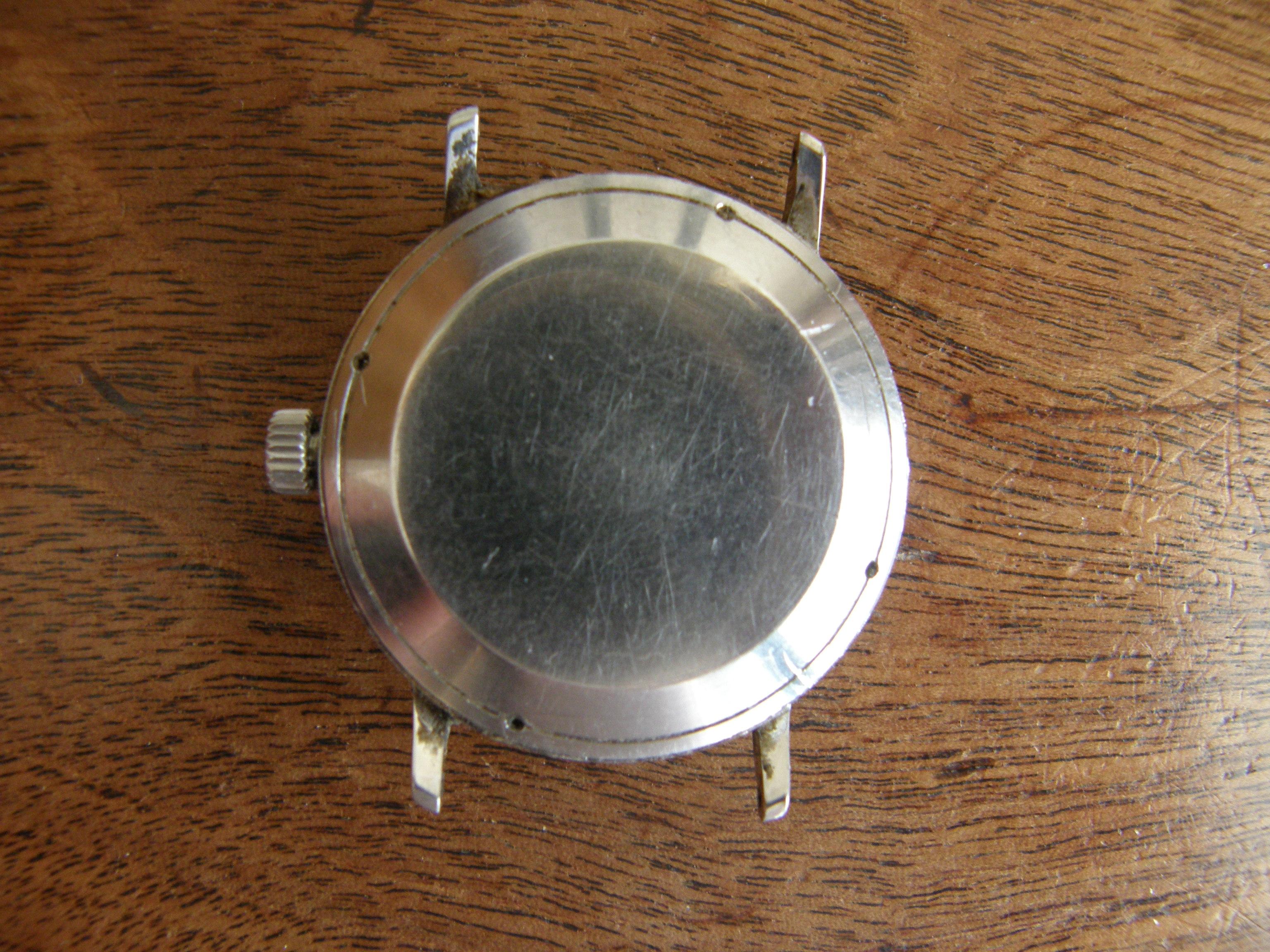

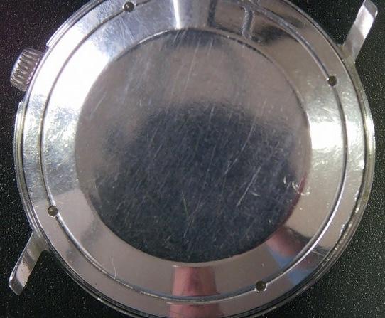

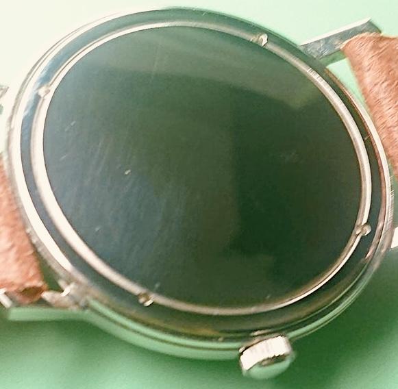

Can someone help with this please....Is this a screw back? If it is the pins would be very thin. If snap on
no prize points for case knife visible. Thanks
