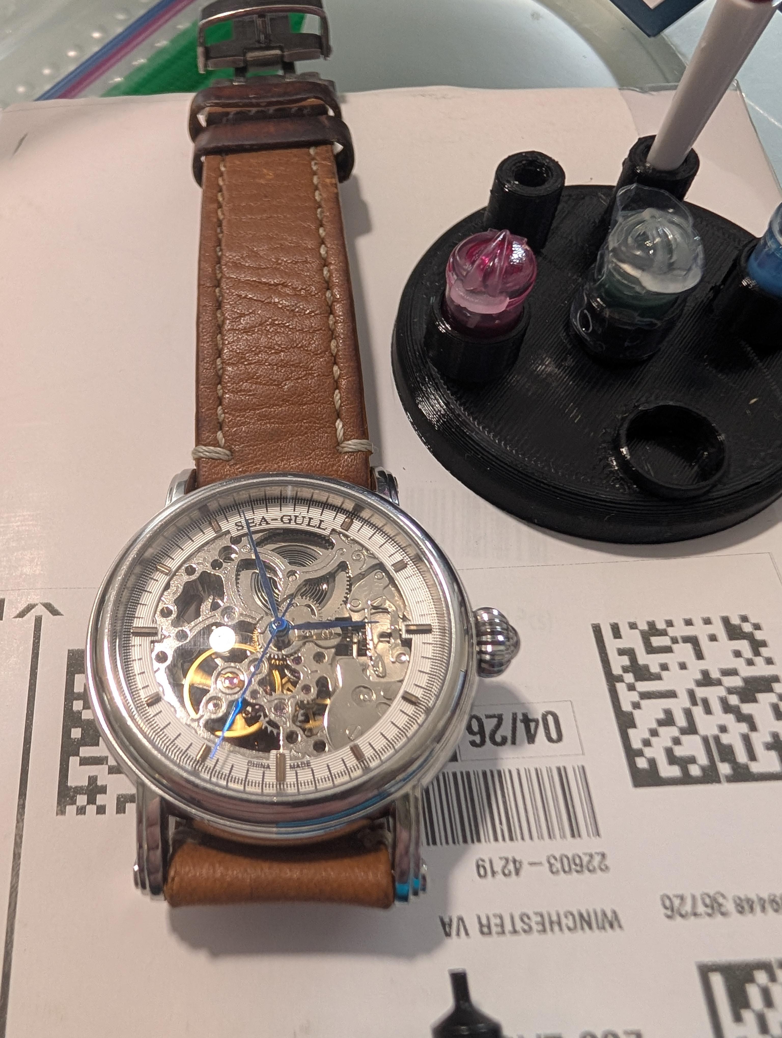

This will be my first crystal replacement, I have a press, but looking at the watch I wonder if I might need a bezel tool also. Any and all help appreciated.
Tool for removing or pressing the bezel? Most likely you have to remove the bezel (with a knife) before removing old crystal or inserting a new one. You can press the bezel with the crystal press if you have a suitable die with straight walls or otherwise a die that has enough clearance that it doesn't touch the crystal when pressing the bezel.

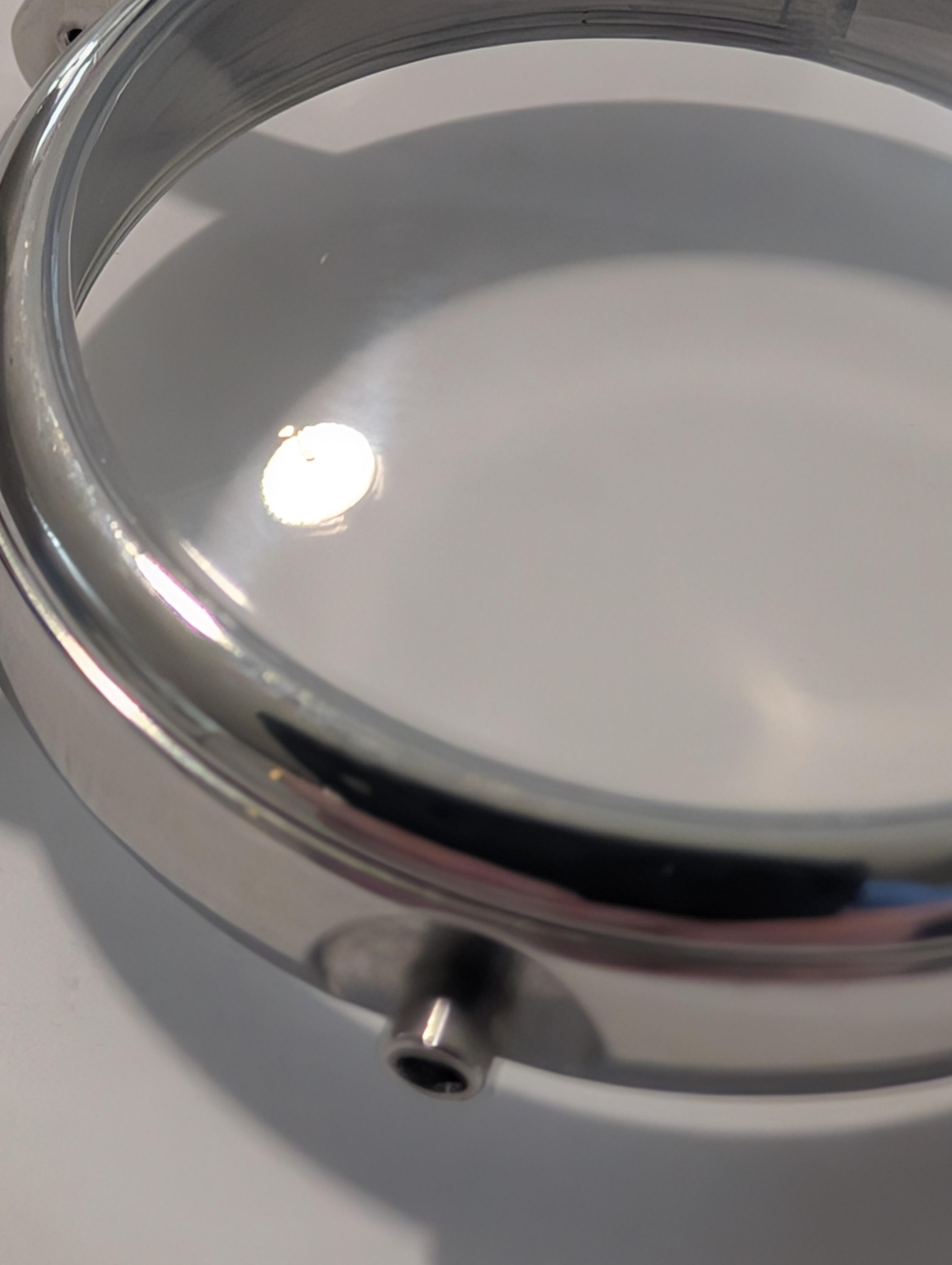

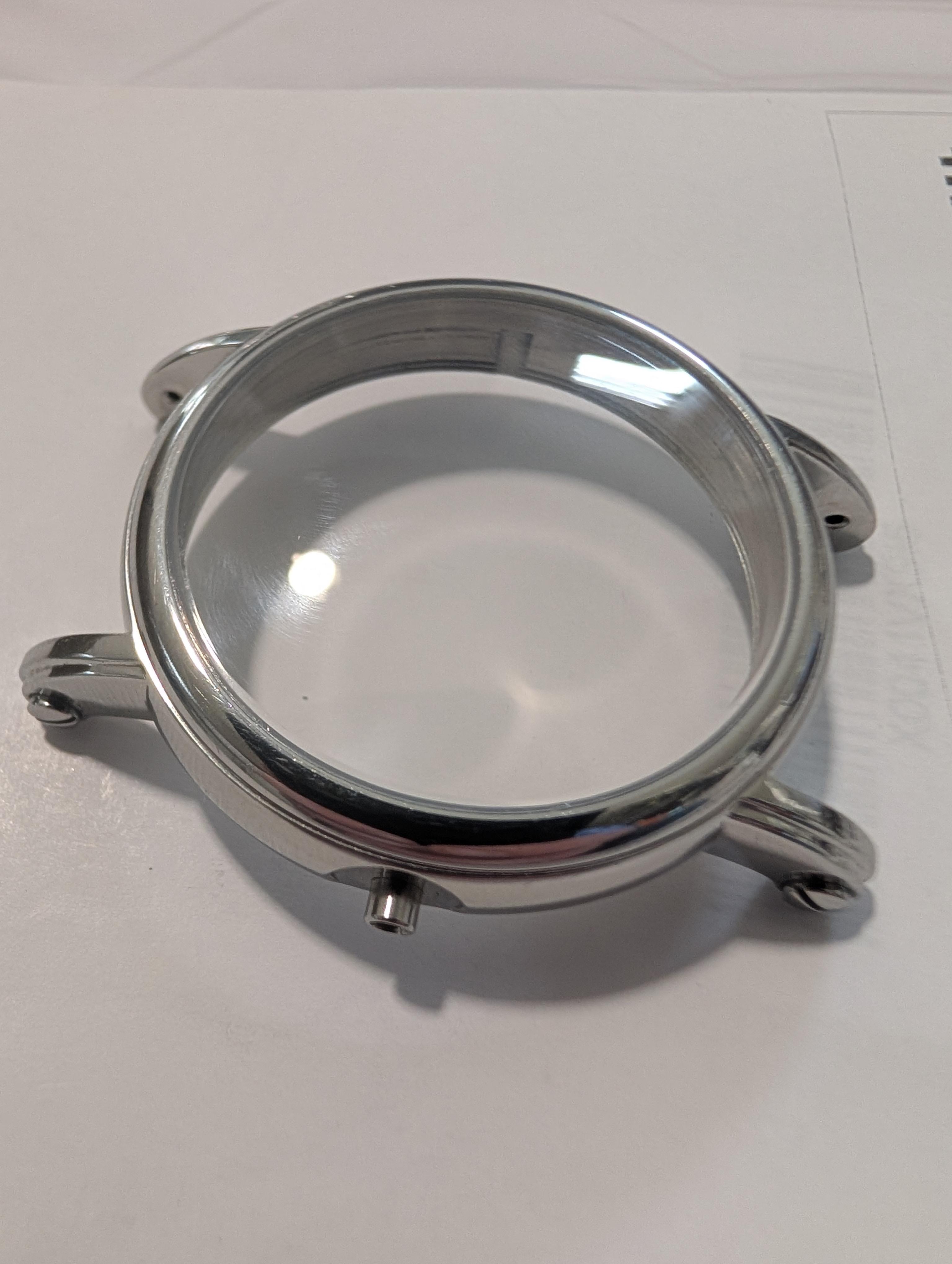

It's difficult to tell, but my guess is it just looks like it has a bezel. Once you have removed the movement, you should be able to tell. Either way, I think you should be able to press out the old crystal from the inside as long as you have a die that properly supports the bezel around the crystal. So, take it apart first and then assess if any additional tools or actions are needed. Let us know how you do!
Edited by VWatchie
From what I see, the crystal is made of mineral glass and is secured to the bezel with a sealing ring.
If you might want to replace the crystal without removing the bezel or the movement, I think it's possible, but risky. You have to suck out the old crystal without breaking it into tiny particles. I would not do that.
If you remove the movement first you can press the crystal out and press a new one in without removing the bezel.
Edited by Kalanag
Well, turns out it was a fake bezel! The crystal is domed mineral glass and I was able to find a cheap replacement that should be here in two days.
I used my crappy little press to pop out the cracked crystal, Ill give the case a good cleaning in the meantime and do a once over on the movement.
