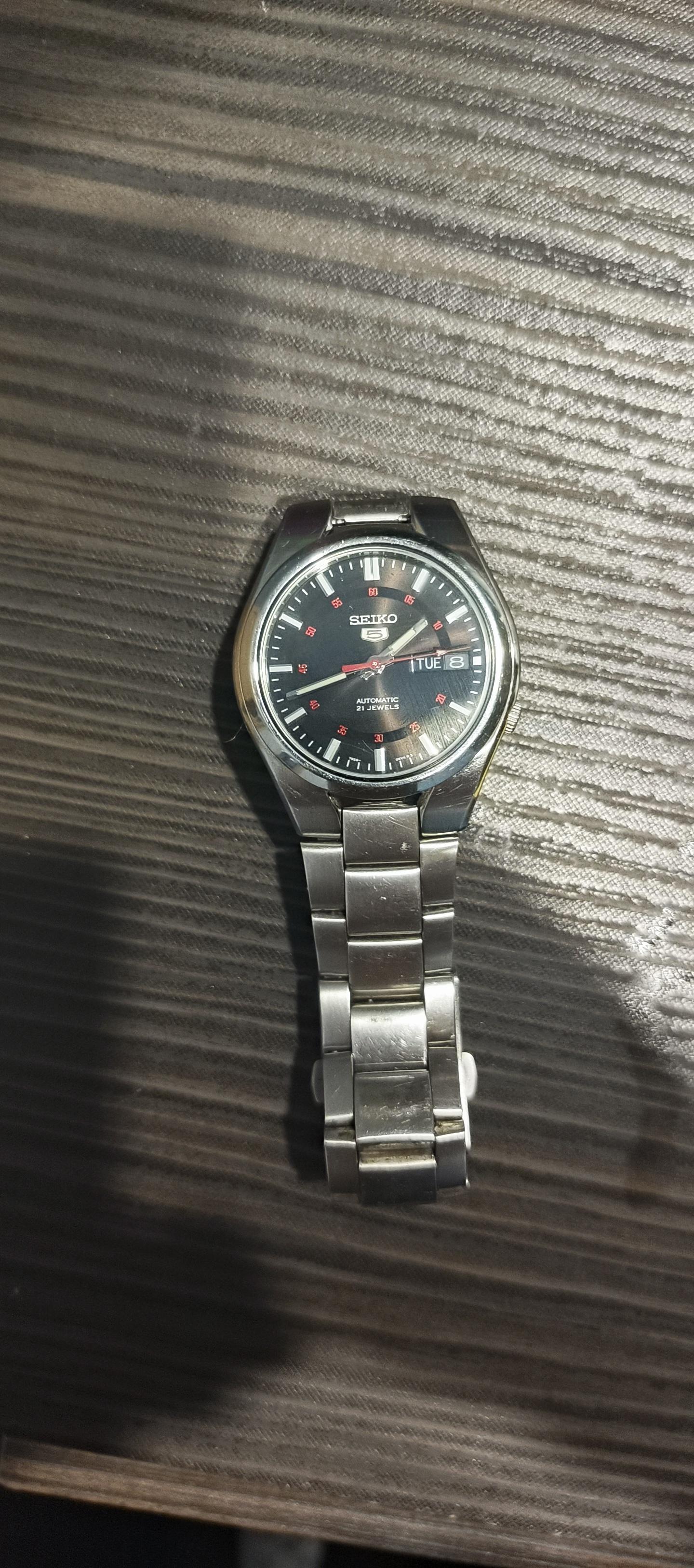

So because that Seiko is 3.8 rather than 4, if the movement fits the aftermarket case you would just need to refit the dial somehow - the day/date should line up with a 3o'clock crown.
I don't understand how the date would line up
My suggestion would be to sell it and buy another rather than ruin a perfectly good watch.
The spacing on the day/date discs means if you removed the dial the day and date would be inline with the crown.
Edit
The above depends on the movement.
Edited by AndyGSi
Of course, silly question when I think about it.
You forgot one of the forum's golden rules, " no question is silly " . 🤔 A matter of repositioning dial feet.....I'd rather not.
The day date disk stepping may not then line up with the date window of the new case. I wouldn't mess, like Richard said you might ruin a perfectly good watch.
Lets look at an example of the alignments. The crown positions of the two cases are 3.8 ( old case ) and 3 ( new case ) , that's 15 degrees of case position difference.  In order for the date window to line back up at 3 the dial needs to be re-positioned on the movement 15° clockwise, thats the first obstacle.  Now looking at just the date disk alone, it's divided into 31 days , each date number and disk tooth is approximately 11.6 ° of rotation from it's neighbouring number. So each date position is also approx. 11.6° apart, since the new dial position is 15 ° from its original position and the date mech is set to that position..... the jumper can't be repositioned ! ... the date numbering will be approx 3.4° out of alignment with the date window.

I think you've figured it and the above post explains far better than I will, but crown either side of 4 works (3.8/4.2), but bang on 4 needs a new day and date wheel.
Day wheel can be realigned on some, date is a different disc.
1 hour ago, AndyGSi said:
3.8 is 24 degrees so result would be 2 degrees out.
Well spotted Andy,  I missed out the 360° of a full dial divided the 4 minutes of an hour dial reposition.   Should have actually been . 360° ÷ ( 60÷4 )= 24° . I must do better maths 😄.  Still won't line up,  11.6°  or multiples of would have.

It does line up which makes me believe it's not actually @3.8, even the Seiko literature states @4.
Edit
Just realised my maths was wrong too and it would be 0.8 Degree out 🙈
Edited by AndyGSi
That's probably why they line up then. Each day on a date ring is spaced at 360° ÷ 31 days, which works out to 11.613 ° or as near as,  2 days is 23.226° . Thats probably where the crown is postioned  from 3 onwards on the original case.
Positioned at 4 would be 360° ÷ (60 ÷5) = 30°
Who has a seiko 5 and a protractor handy ?  😄
It looks like the crown is at 19 minutes, which I assume is where the 3.8 comes from .
Yes and very difficult to tell even close up if the 19 minute / 3.8 is accurate.
If you worked on a 30mm diameter dial you're looking at around 94mm circumference so 0.8 degree works out about 0.2mm
That's pretty damn close, the original case crown position could easily be just 2 date clicks away from 3 o'clock.  The OP still needs to decide if he wants to move the dial feet. Do seikos have dial feet ?.... I have no idea 😄.........whats a Seiko anyway 😅.   The 4 crown position doesn't leave a crown imprint  in your wrist when doing push-ups......stick with the original case OP.
