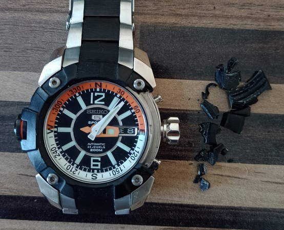

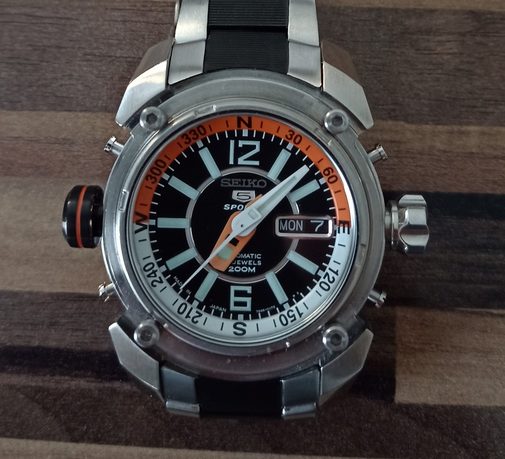

I've got hold of a used Seiko SKZ265 K1 automatic. However, during initial inspection, parts started smouldering off of the protective resin shroud, forcing me to remove all of the resin bits and make room for a replacement. Oh well, that only made remaining maintenance easier.
However, without the resin shroud the case look a bit like a poodle that's been to a mad-scientist-doggie-salon for a fur-cut 馃檪
Pre-smoulder-picture:
Post-cleanup-picture:

Scanning is not an option. Shroud has utterly and completely disintegrated into little bits.

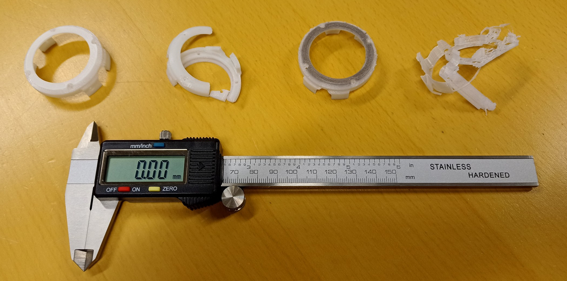

I think I can 3D-print, altogether avoiding casting. Have both FDM and resin printers in-house. This is obviously a job for the resin-printer.

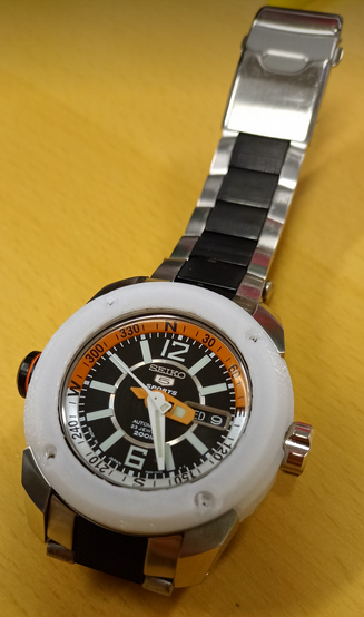

However the task of designing a replacement part of my own design was simply too exciting, so I've made a rough sketch that looks like this - for the moment it's a fitting-exercise:
Either my email will get me an OE-part or my own design will end up fitting properly.

3D-print is always an iterative process. Especially when trying to fit a new gadget A to an existing thingamabob B.
Dunno if I'll aim for OE look. Since last, some 5 protos have been done, fitting better each time. Once fit is in place, form will be addressed. Prototype-sequence up till now (right-to-left):
  1. Non-functional.
  2. Non-fit.
  3. Bad fit.
  4. Better fit.
  5. Almost-there fit.
I'm now here (that's '5'):
I'm getting there...
So. Fit attained. Next step is to try mimicking OE. A challenge, but only caused by the 3D-printing-process involved.
