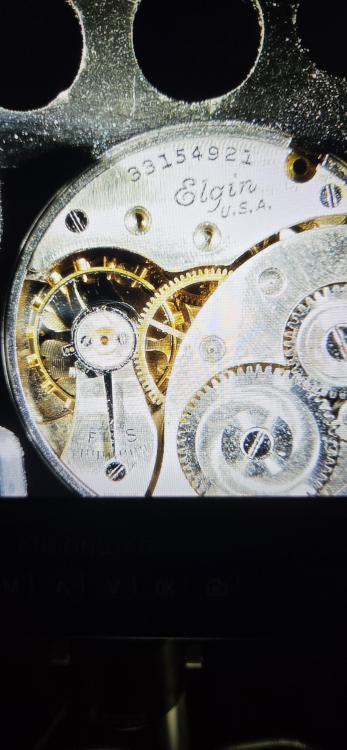

very new to the hobby and just starting in on my first few practice movements. this one is a USA wristwatch, Elgin 33154921.  Which I have not found much info on for parts.  My mainspring measurements come up as 1.84mm high, .08mm thick with a 11mm barrel ID and 3.4 arbor OD.   If I try to run a string along the length and measure i come close to 400mm however using calculations I saw online   L=3.14(R^2-r^2)/2t  I get 536.94 .  I have looked on CAS-KER's Us site and on COUSINS UK site and have not been able to figure a GR code or part number close to those measurements.  Any help would be appreciated but am more interested in what I may be doing wrong or directions to get the right answer over just which mainspring is right.

So from the Serial No you can find from the following sites that it's a Grade 485 Movement.
https://www.elginnumbers.com/index.php
https://pocketwatchdatabase.com/search/result/elgin/33154921
If you then look at the attached PDF you'll see it's a 4789 Mainspring.
An eBay search comes up with these as an example but there is a slight conflict on the strength.
https://www.ebay.com/itm/115496722196?norover=1&siteid=1&mkevt=1&mkcid=16&chn=psoc
https://www.ebay.co.uk/itm/374299307774
The Pocket Watch Database site above also confirms this.

1 hour ago, dirkwulf said:
CAS-KER
If you look carefully on their website they have a nice PDF to download which I will attach. Then you can take your dimensions and figure out which mainspring you're supposed to have. It also give you the various numbers of the mainspring so you can go look on eBay
One of the problems with part numbers for American pocket watches will be or can be typically with balance staffs and mainsprings will be size variations for the same part number. Typically with Elgin when they give you a part number they will give you the thickness of the spring.
If you look at the above example I have you'll notice that for some of the Springs for the same part number you did have various thicknesses or strengths. As time has gone on the quantity of mainsprings available especially the aftermarket springs the quantities or the choices of thicknesses will go away. In other words you're lucky sometimes to get a mainspring at all.
Then from a different listing for the particular part number we can see that the blued steel spring originally came in three different thicknesses. With the initials DP standing for Elgin's alloy DuraPower.
Personally especially on the smaller size American watches I would try to go with the original spring as they will be more likely to be sized correctly. Then DuraPower Would be the preferred choice. Then even though the listing up above only shows one thickness/strength according to the seller below there were three different thicknesses and other words you get a choice.
https://www.ebay.com/itm/156090848585
