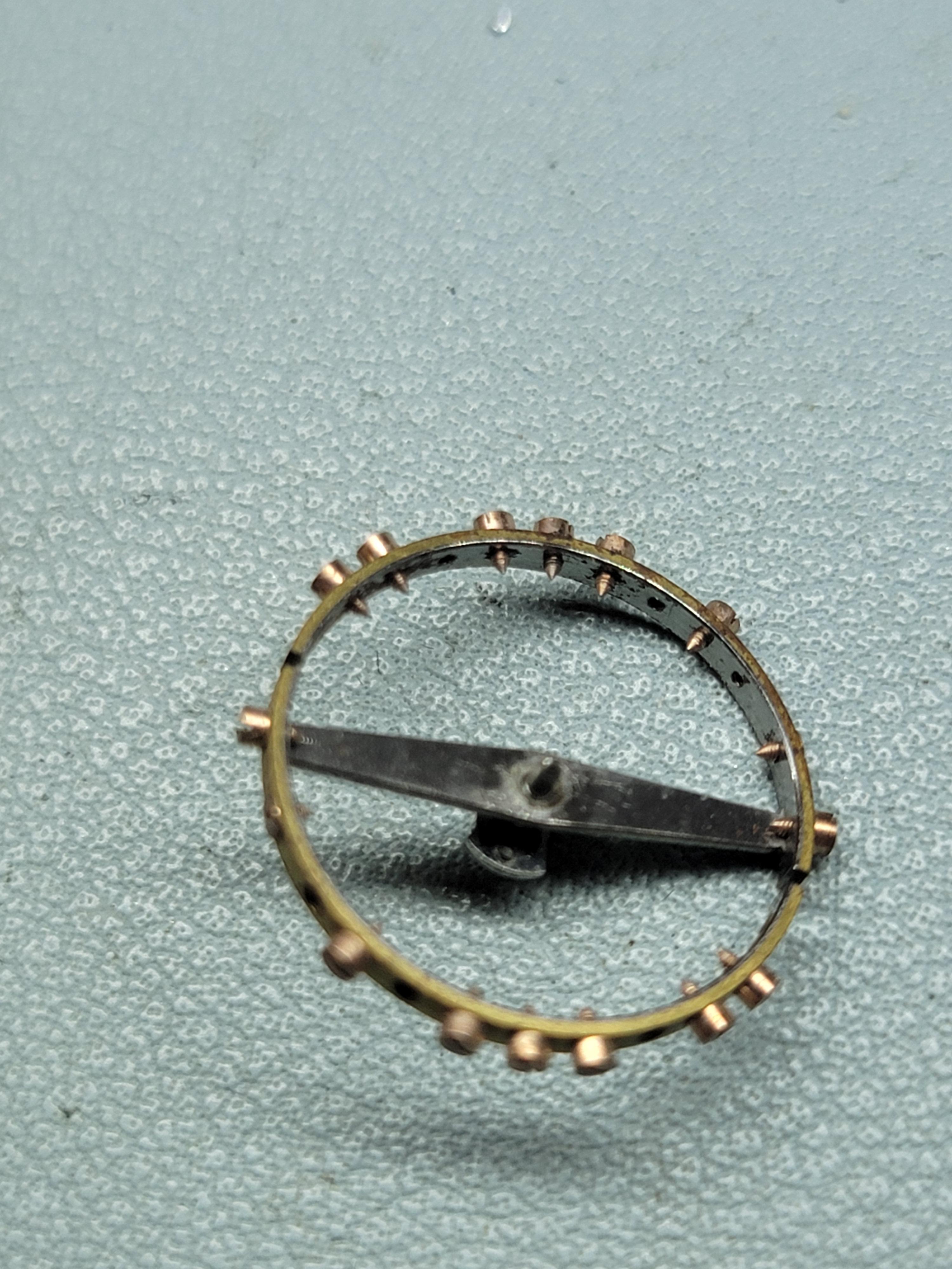

I cannot seem to find any reference to a staff for this movement.  In pocketwatch database, it is referred to as a Hamilton-Ball.  I do see some Hamilton watches with 99x numbering.  Maybe I am looking for the wrong thing.
I have the old staff with one broken pivot, so I can turn  a staff...though I never get very close to factory.
38 minutes ago, mbwatch said:
Is it a friction staff or riveted? Hamilton had switched to mostly friction staffs on their railroad watches after the 992. If you can get good measurements, I expect it will match one of the Hamilton staffs listed here https://pocketwatchdatabase.com/reference/balancestaffs/hamilton
I was at that page earlier today.  Not sure if it is friction or rivet.  Will go take a look and take a few measurements.
Ok I believe it is rivet fit.  Based on a couple of measurements, I think it is part #126 on that page.
Here are some images. I need to replace the roller jewel as well.
