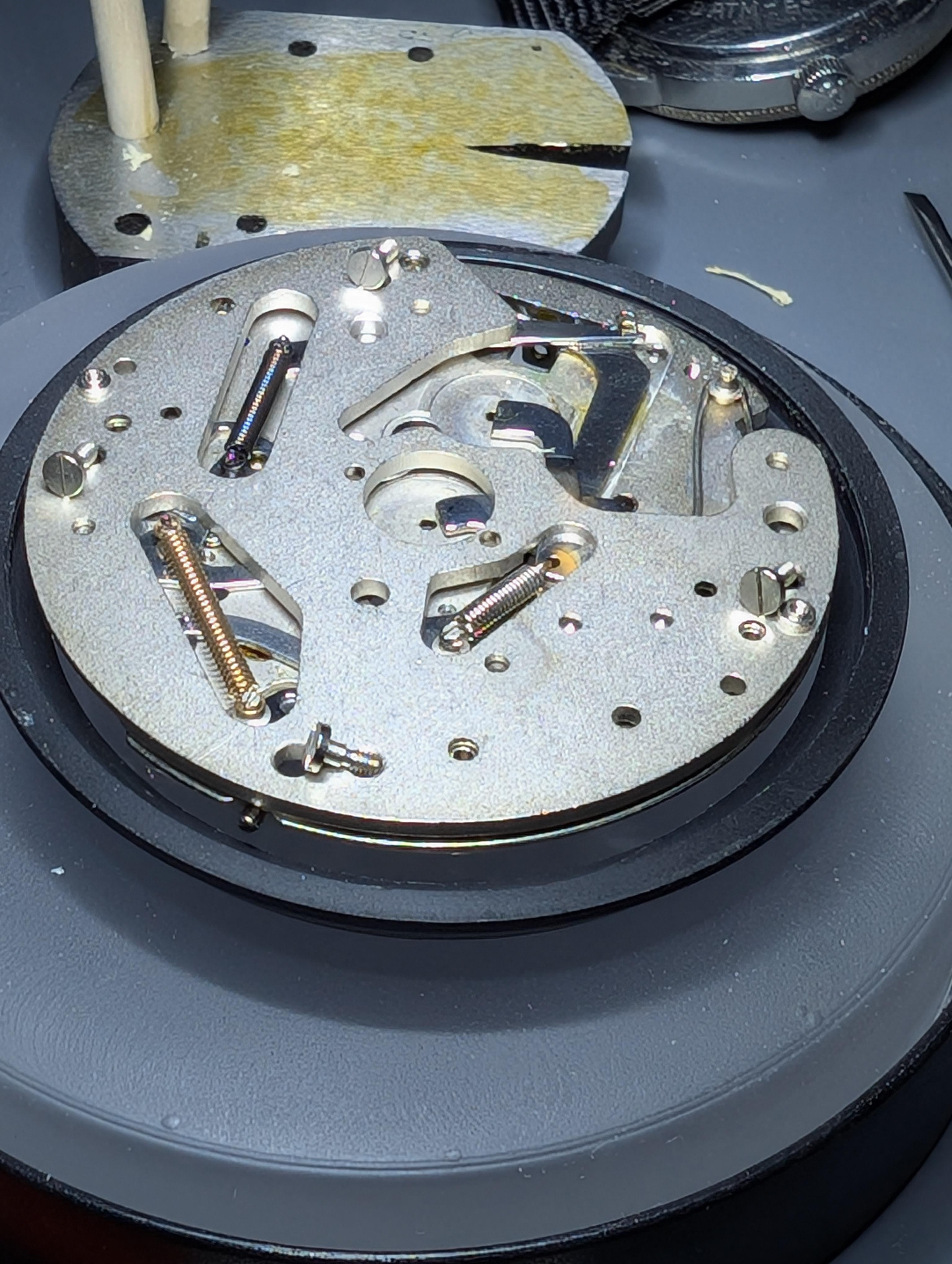

I recommend removing the springs before you remove the dial rest plate. This will prevent stuff from shooting everywhere if things aren't properly seated. I also recommend waiting to replace these on assembly so that you don't struggle to get the winding pinion and winding stem guard as they relate to a tab on the hammer lever. This also shows the dial plate screws and their locations.
You can see how much corrosion and dried hard candy was inside this with the dial support plate removed. Obviously my spring removal recommendations were based on personal experiences. Lucky enough everything was super stuck together that nothing flew out.
Positions of the springs.

Then for anyone else that comes here. Snipped out an image from the pictures up above Springs that are nicely color-coded. Plus a photograph so you know where they go. The last one I worked on a 736 the two spring is appeared to be almost identical. There are about the same color they both looked may be the same. The parts list indicated different part numbers which might imply there different and. The really important not the mixup the spring is if they're not color-coded.
