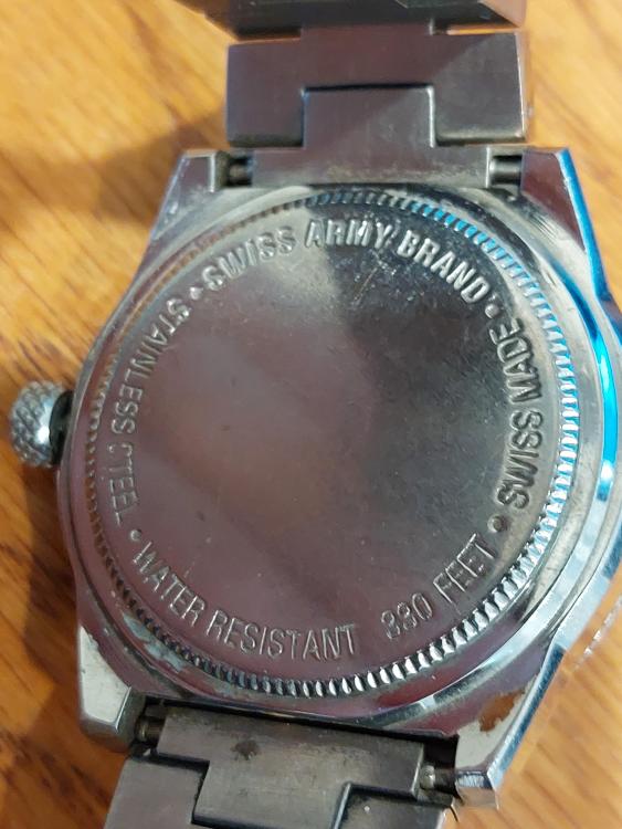

I have a 40 year old Swiss Army watch.  I got it for free by clipping coupons from Marlboro boxes (I stopped smoking.....).  It's a great looking watch with a stainless steel case but it stopped working.  I took it to a repair shop, but they say that they cannot purchase the works anymore.  I sent it into Victorinox and they say that the parts are no longer available but really, they just wanna sell me a new watch and offered me a 30% discount.  lol.

Interesting that it doesn't have a special dial? Sometimes referred to as character watches many companies give away watches with their logo on the dial. So basically the watches were free which you had to purchase a lot of something.
Then we would really have to see the inside of the watch.

I'd presumed it would be a quartz?

Very kind of you but we still don't know what's inside.  If it is a quartz and the battery has leaked it may be beyond repair.  A new movement may be available. We could do with more information from the OP
I probably should have answered some questions before posting my last photo:
In order,
AndyGSI, Thanks for the welcome.  🙂
JohnR725.  Yes it was free, Sir.  No marlboro logo which is kinda why I like it.
NuceJoe and Andy GSI, It's dead stopped.  It's not a winder.  I am able to change the date and time.
Looks clean enough so doesn't appear the battery has leaked.
Can you fit a new battery and see if you get any sort of twitch from the seconds hand as it could just need freeing up.
Failing this there are still replacement movements out their.
https://www.ebay.co.uk/itm/205152415028
Edit
The movement is actually and ISA 1198.103 or 1198/32
https://swisswh.com/product/isa-swiss-movement-1198-32-1198-103-disk-at-3/
Edited by AndyGSi
27 minutes ago, ArizonaGuy said:
AndyGSI,
Do you know how i can which 1198 it is?
Sorry I though the one in this link was correct but that's black on white not white on black although any half decent repairer could just swap the date disc.
Edit
Can you confirm the date and dial are black as I can't find that as an option.
Edited by AndyGSi
