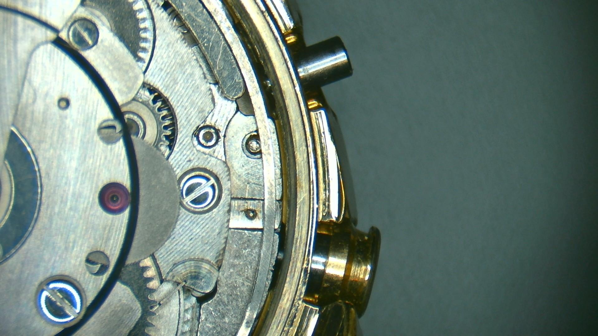

Hi All, Just looking for some advice regarding the missing pendant tube. Does anyone know the sizing used by Seiko or will it be a case of pushing the old one out and taking measurements off the hole and the new crown? I do have the correct Seiko crown in hand 55W06NS1. Never done a tube replacement before so I probably need to get a tool for that also. Thanks, Steve.

There's nothing listed in the Case Parts for the tube so looks like it's a measurement job.
Thanks Andy, can you offer any advice on the right kind of tool for this? Has anyone used the ones, usually red ones available on AliExpress?

I've used all sorts from Torx Bits to pieces of metal with a point and drifted it out from inside the case.
It all depends how well fitted they are as to how much persuasion they need.
Is that the remnants of the tube still in the crown?
You should measure the internal diameter before you start trying to remove it from the case.
One of my Bellmatic's is in a 6010 case. I've just removed the stem and measured the stem tube :
Outer diameter 2.00mm, and it sticks out 2.6mm. It looks like it's just a push in, so should be easy to find a replacement and push it in.

Thanks so much Mike. From looking at the proper crown and the case I had worked out that I was going to need a stepped tube 2.0 diameter stepping down to 1.8 mm into the case. 2.6mm length was the missing info I needed.
On 12/19/2024 at 10:25 PM, steve1811uk said:
I could only find a pendant tube with 2.0 mm ext length, so it's a touch short and waterproofing is lost when the crown is pulled out to set the time. I will just have to keep my eye out for one that's longer. Couldn't be more pleased with the finished watch.

Thanks everyone. To clarify, there's just an o ring in the crown. The o ring does not sit around the tube when the crown is pulled fully out as the tube is 0.6mm too short (only 2.0mm long externally when the original tube is meant to be 2.6mm long)

How did the tube insertion go Steve ? Does the shortness let the stem wobble when a bit when setting the time ?
Exactly that. The stem wobbles during time setting. I've found a longer tube and will fit that when my new tube removal tool arrives.
All sorted now. No wobble with the longer tube in place. Thanks for all the help.
