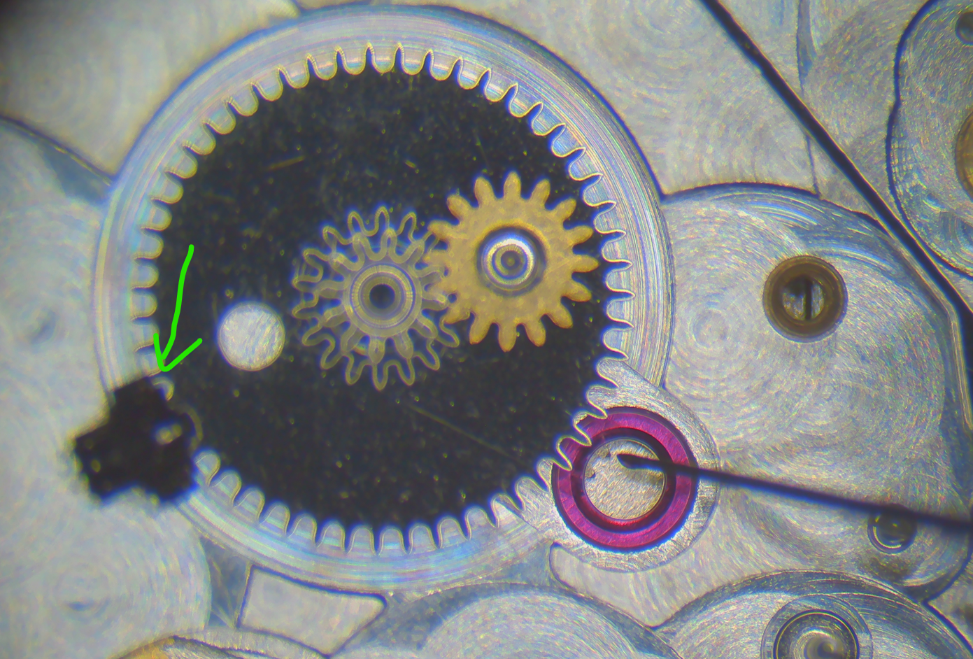

carefully oiling the jewel for this pinion (green arrow). This pinion connects to the barrel itself and lets down the power reserve indicator.

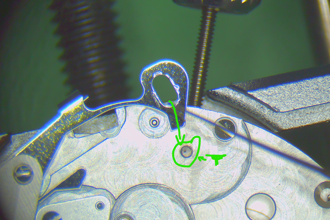

position the wheel more or less like this. The cover palate for these wheels has a little pin which will go into the open area of that snail-like top-part of the wheel (indicated in green). The hand for the power reserve indicator will go onto this wheel. Then the watch is fully wound, the pin on the cover plate will stop the wheel from moving further (the wheel on the barrel arbor will start to slip).
Again, careful when placing the cover plate for these wheels. If the pin doesn't go into the cut-out of the wheel (green marking), you may bend the cover plate.

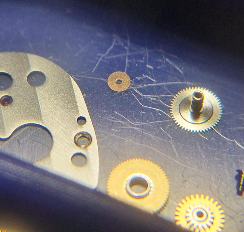

And please, if you find this washer, let me know where!
On 12/2/2024 at 10:42 PM, Knebo said:
have an unusual problem. I part appeared during cleaning. I meticulously took pictures of every part I disassembled, but this one isn't captured and I am sure that I didn't see it. Maybe it was stuck to a plate or wheel and I didn't notice it. It's a thin washer-like piece. I found it in the basket compartment with the second time-zone pieces:
