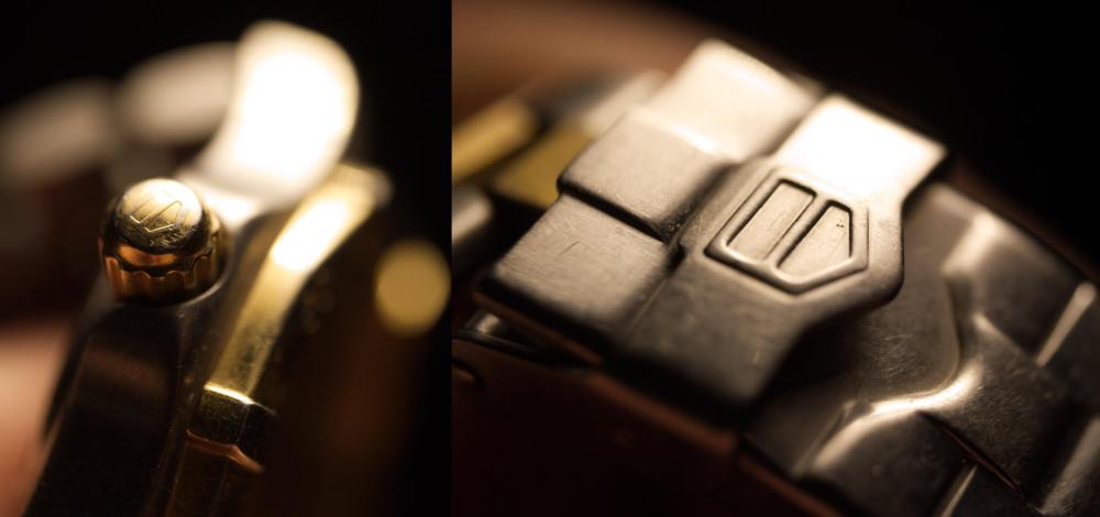

From what do you conclude that it's fake? It has been serviced by Pro Time in NJ before and they didn't raise any issue. I own three Tags of this vintage.
The quality on the dial, hands and bezel isn't their for a genuine.
I'd be interested to see the back, clasp and crown.
As @Neverenoughwatches said the movement would also confirm this.

Thanks for the replies. First, yes, I always have the watch pressure-tested for diving after battery replacement. I've always been told that this requires replacing all gaskets.
I examined the watch in question under an inspection microscope, comparing it to a men's model of similar vintage bought at a different jeweler. I found the quality of the finish to be similar, and that the details of the women's watch match pictures I find online. The picture above does not match; it may be a different model. This is a WK1321. I can't find even one picture purporting to be of that model that matches the above picture.
Here are some better pics. I do think Pro Time would have called it out if it were fake.
