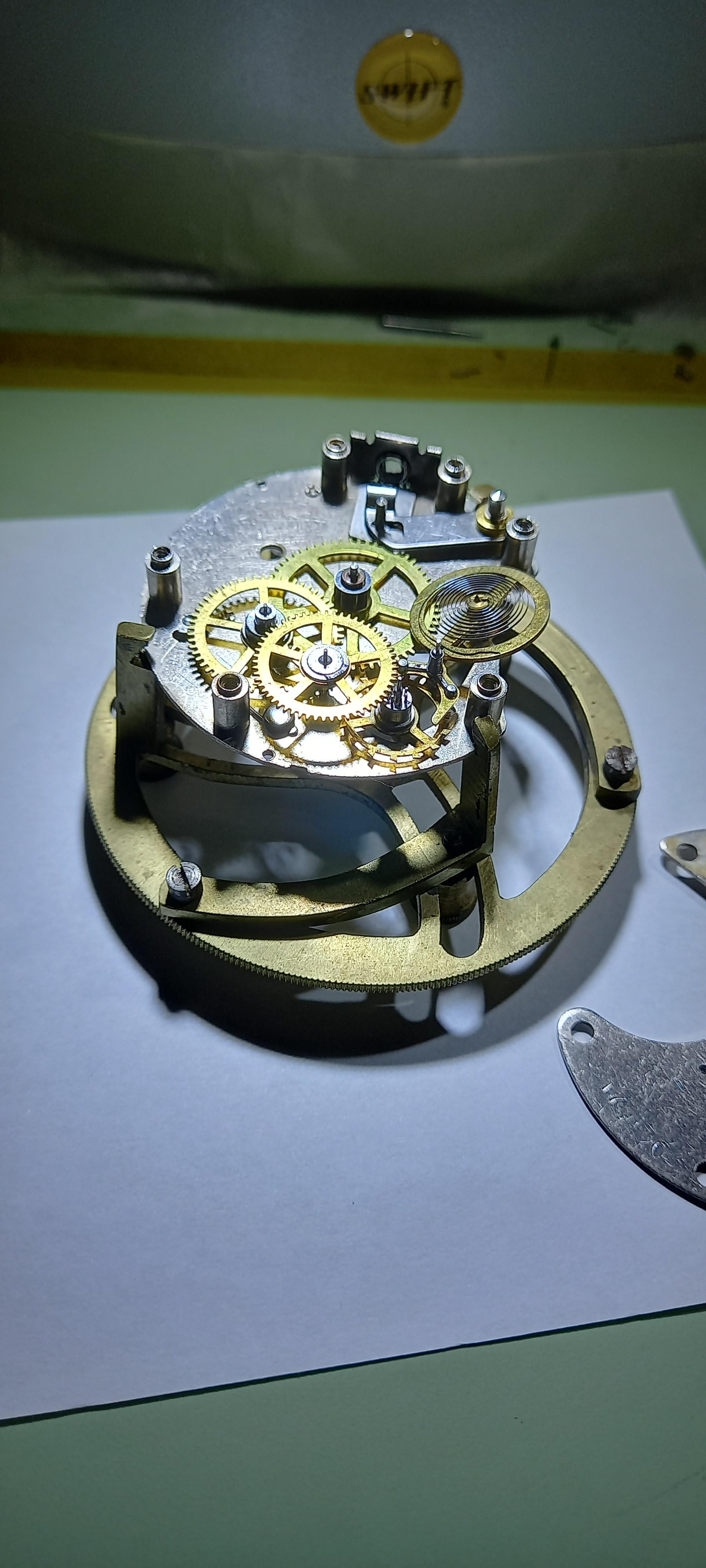

Changed my game today, while waiting to see how my current project fares on power reserve i fancied something different.  15 minutes of fiddling around trying to remove the stem after dropping the power. Looking at anything that resembled a button lever or latch. Under the glass bezel is a lever at the rhs edge, hold the stem and pull the latch down let the crown slip through your fingers to unwind the mainspring.  The stem release had me bamboozled for a little while, after seeing what moved while tugging at the stem after removing a peephole screw in the full plate bridge i noticed the locking bar wasn't thick enough to take the full width of the end of the stem. A small hooky tool is used to pull up what i think is a notched bar this releases the stem. More to come after my cuppa 🙂

🤔.....8 pieces to fit under this plate including the winding pinion and time setting lever,  veerrry interesting........ not sure about this clunky pocket watch lark .

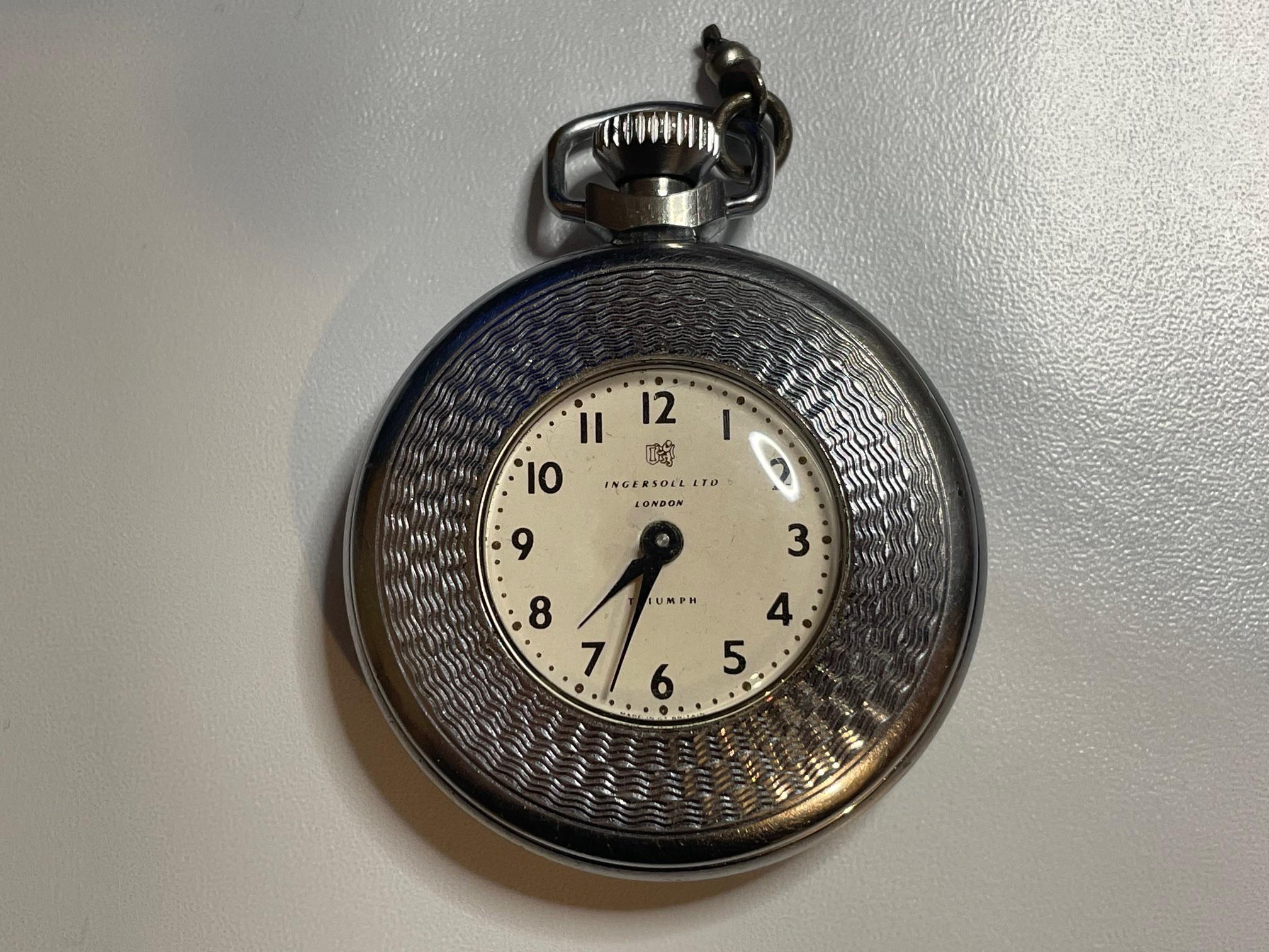

I just realised that looks to be the same movement as the Ingersoll Triumph one I did a few weeks back!
Looks very similar Rob, i have a few of those. This one says made in Canada.
The balance and barrel are switched over and the time setting on the westclox looks more ancient. How did you find it, the winding mech on this is tight , difficult to wind up, the spring was a big hefty thing.
The winding side is OK, considering the size of the spring. The time setting is very stiff, despite thoroughly cleaning and oiling the centre wheel hub.
This is one of the last bits from my fathers estate; he had about a dozen pocket watches but I sold most of them, as I had no spare time or interest for them back in the early 80s.

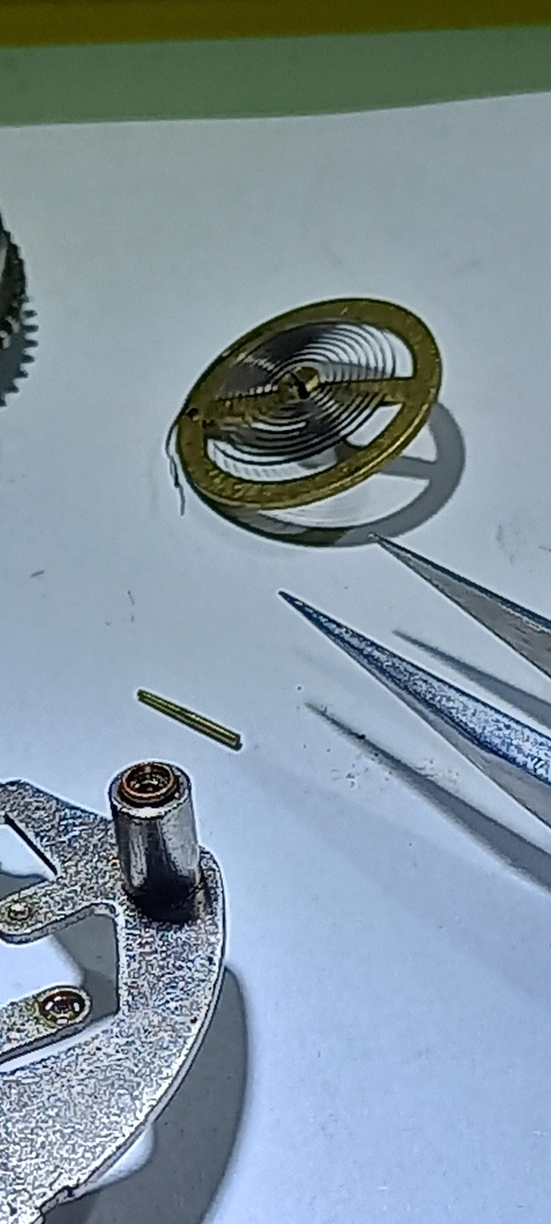

Thanks For the reply Rob. The wheel pinions made me laugh, i wonder if thats where the name comes from these are just pins diametically placed around the wheel hubs 😅 ( aluminium hubs that support the pivots, the escape wheel pivot was sliding inside the hub , amazing quality i think Dollar watches were overpriced 😅 ). I was unsure as to the cannon pinion looked friction fitted , i didnt try seperating it from the center wheel and cleaned them both in situ. Timing was a long way out - 800s/d and the inner coils of the spring are also catching the side of the loosly termed regulator pins, no knee bend terminal curve so i thought i would make one , just adding that now. Two pieces of equipment to shi definitely ow, the movement holder is extremely good for PWs, easy to handle and loads of cutout underneath for working both sides at once and the balance holder , traps the roller between a compound tapered slot , keeps the balance held then the whole unit can be picked up looked at worked on etc. I definitely recommend both of these for working on PWs , the MH was about £20 and the bal. holder came with a job lot of tools but I've seen them separately for about a tenner. Mine needs the top re-finishing.

Seeing that movement with the barrel bridge in place, it does look quite different to the one I have.

Mine may be slightly newer, as it has brass pinions rather than the lantern style?
They're usually a simple gear friction fitted onto the dial side, but able to be levered off to separate the center wheel. But that's not the source of setting friction. On the back of the center wheel pinion are a couple of washers, possibly cupped, that supply the friction.
When you get the hands on, you might find that cleaning machines have loosened up the friction and it won't keep time until you stake that washer back to be tight enough. This has happened on almost every dollar movement I have worked on.

This  westclox pocket watch is running much better with a dedicated end curve added. I'm now able to regulate it much closer to accurate time without the hs bumping the regulator about that !...... I'm thinking of modifying the fixed hs spacing that can fit a dozen springs. Yet to see what the lift angle should, at default 52° the amp is managing around 150° it also looks visibly low but reserve is very good Friday 14.00 - Sunday 20.00 and it was still ticking.

I have to say the westclox is starting to get on my t..s now. The hairspring just did not have enough room to breath so i introduced a terminal curve which it didn't have or rather not good enough to allow rate adjustment without the coils touching. The regulator was then in the way of the hairspring but was easily fixed by reducing the fixed pins. I couldn't understand why the watch did not have an external time setting function. It does but poorly designed, pulling the pendant activates a bar with a sliding pin inside it, a sloped slot on the bar draws the pin to one side that brings the timesetting wheels into engagement. The pin also has the help a plain flat spring set into the top plate to help draw the pin into position. Problem is looks like the time set has never worked, i couldn't pull the pendant at the start of disassembly and even after adding more slope, more polishing and grease to encourage the pin to slide its still very stiff to pull the pendant 🤨. More work needed to this 100 year movement,  again i think it was overpriced at a dollar. I think the actual figure was $1.59 in 1929.
