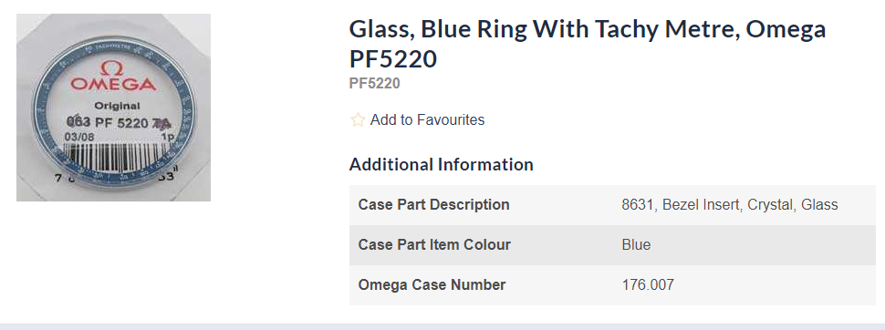

1 hour ago, JohnR725 said:
Then if you look at the PDFs it gets even more confusing because each of those PDFs has several different crystals with slightly different letters but not a detailed explaining
Is the Crystal not just the PN5220 with the varying parts being either the bezel or the tach ring?
I think technically you need the 063 in front of that because that's the code that says Crystal. then yes all the rest of the letters lurking in the number will have some sort of meaning. We just conveniently don't know what it is.
so for instance if you look at the list you'll see list the top number as the and the bottom numbers just the crystal
I was doing a quick search on my computer because I know somewhere I've seen at least a partial listing of what all those letters mean. Unfortunately I have way too much Omega documentation and none of it has a particularly helpful title so giving up on that. But did notice that reference number in 2023 I downloaded the PDF's. Suspicious I just now did a search on this website and sure enough somebody was looking for a movement ring but there's a whole bunch of other references to this. It's always good to do a search on the website to see if anyone else had any other questions or similar questions. Some may want insert the crystal but decided to take it somewhere more professional as they got a better price of $190 yes everything is going up in price.
The top number (PF5220) is the Crystal with Blue Tachy ring and the bottom number (PN5220) is just the crystal.
Edit
Should have added that Cousins used to only sell Tachy rings but the letter after are as follows.
TA - Tach
DE - Decimal
PU - Pulse
TE - Tele
Edited by AndyGSi
