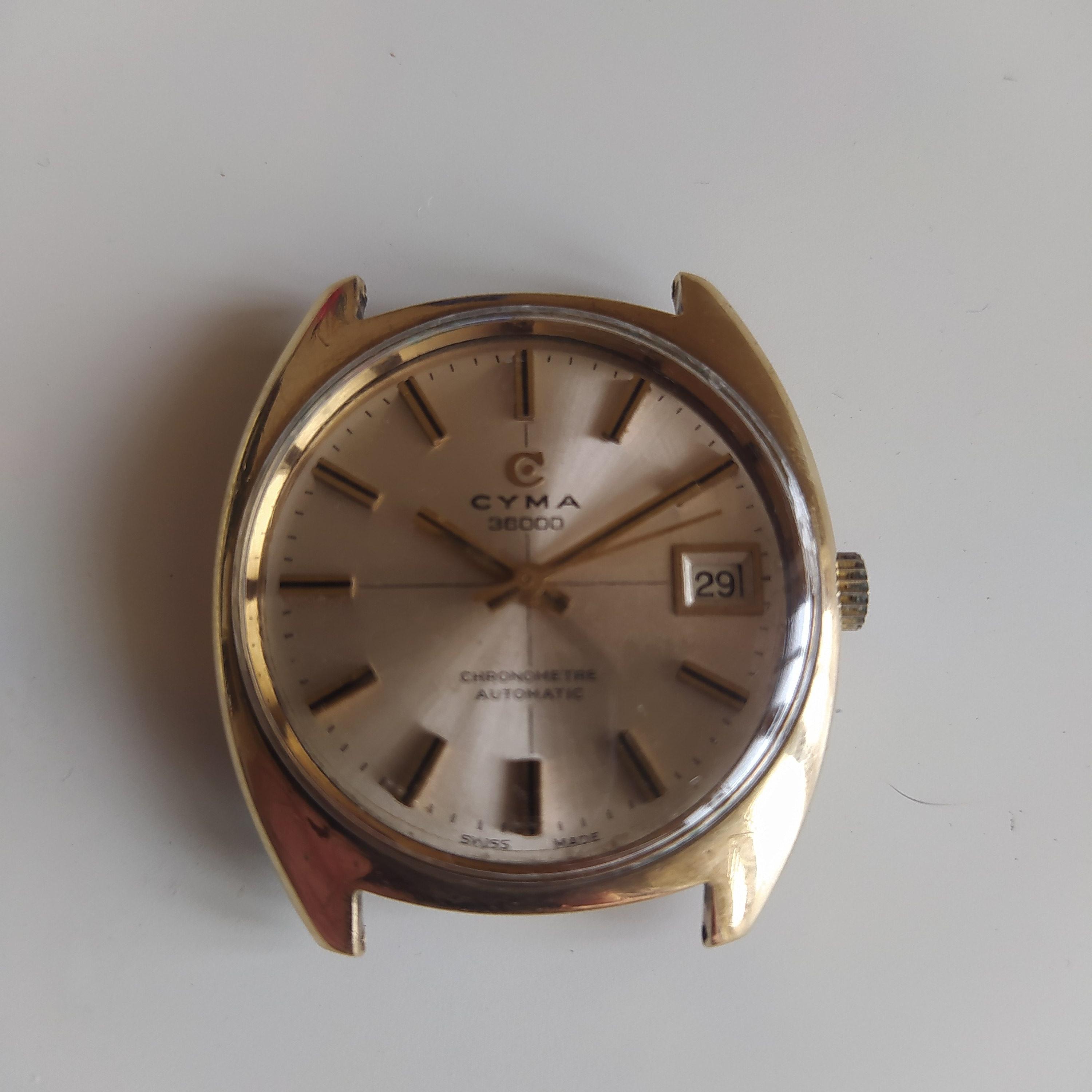

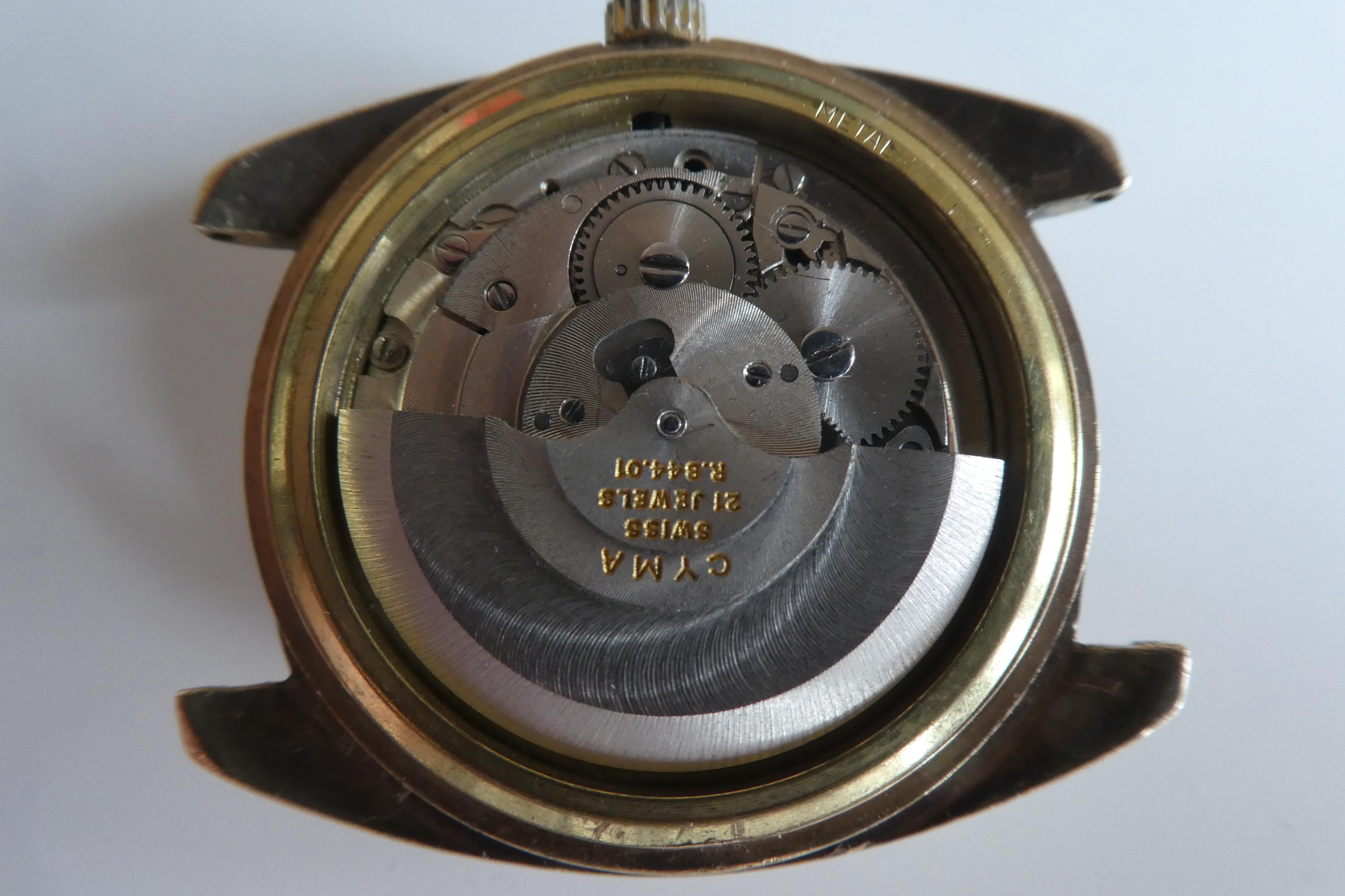

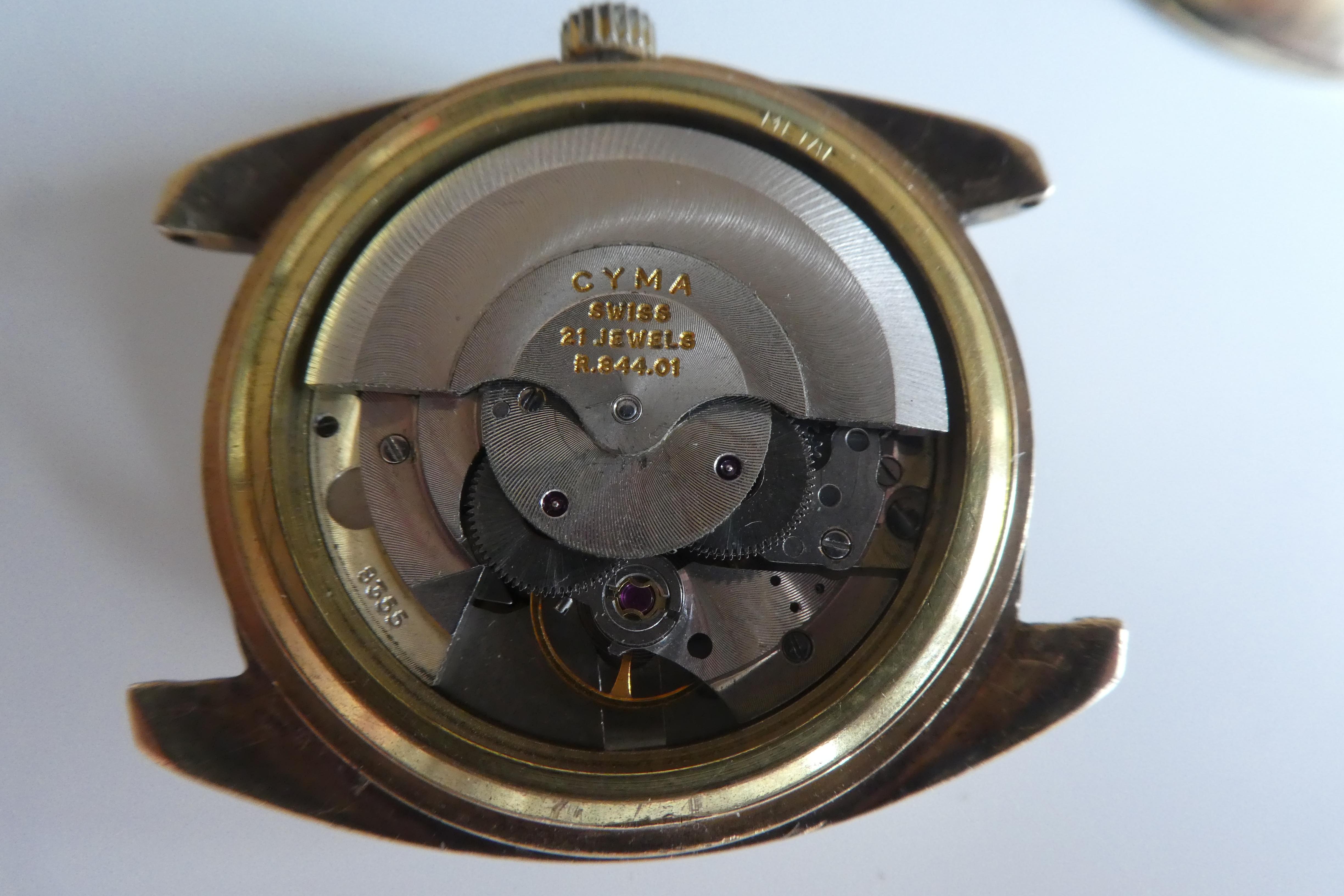

We need a pic of the movement to identify its caliber.
 In case the forum did not allow posting pix , you can post on  YouTube or.....  and gives us the link to see the movement, we might need to see pic of the keyless.

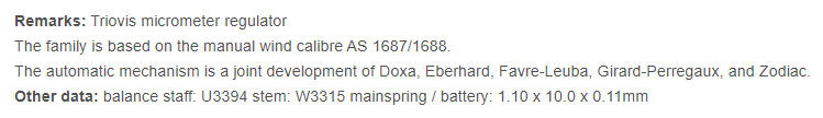

I can find little information on the Cyma/Tavannes R.844.01. It's not listed on the Jules Borel database, and Cousins list the barrel as discontinued, but I downloaded their documentation (see attached) 2064_Cyma 844.pdf
Someone has written on Zod 86, and it does appear to be the same as the Zodiac 86
For the Zodiac 86, Jules Borel lists the Barrel Complete is common on the following movements.
