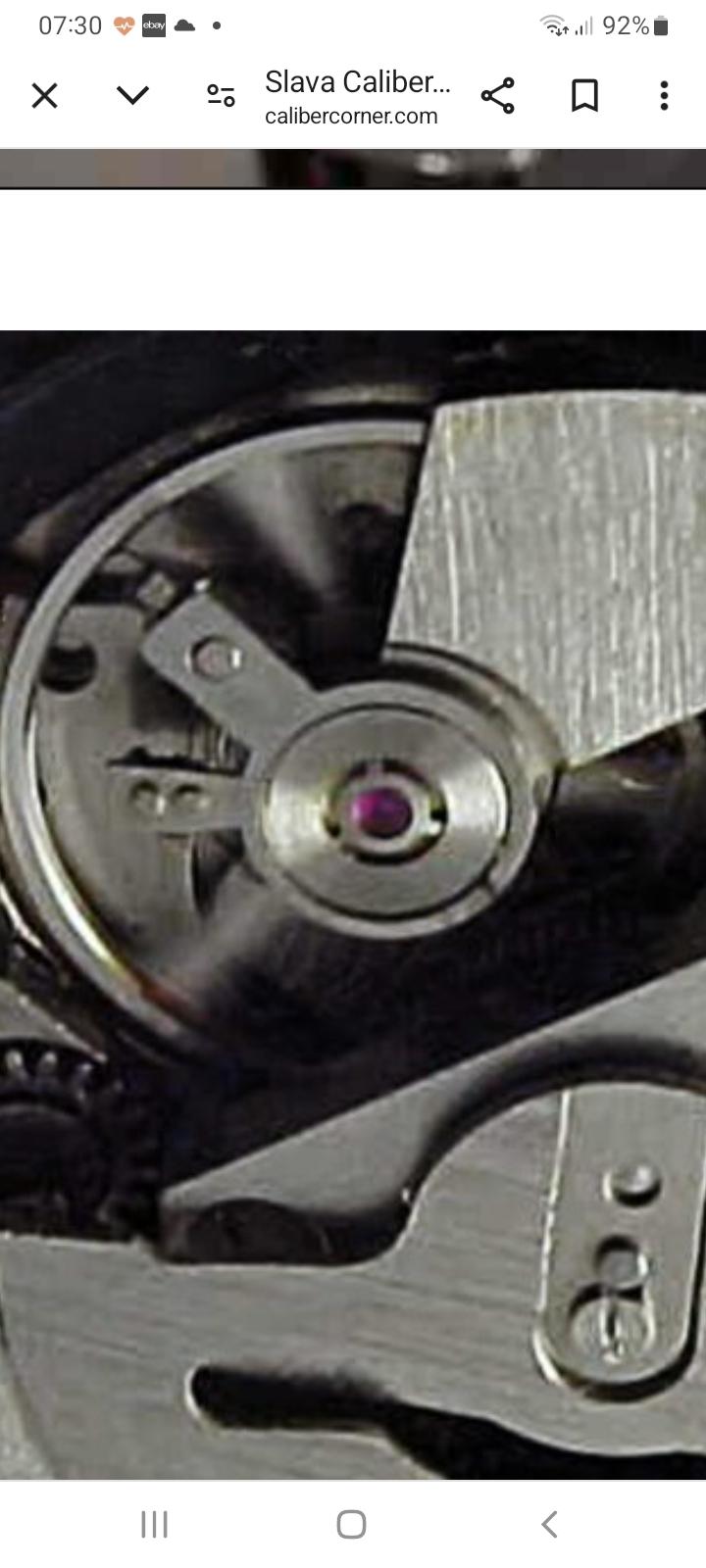

These are driving me mad. The score currently starts at lost: 2, broken: 2. I have read what I can find on them, watched videos and made two different tools.
I am trying to service a Slava 2427 which has fought me every step of the way. I have blown through the two springs on this watch and the two on my donor movement. I have three more donors on their way and genuinely concerned that I am going to waste those as well.
I understand the theory of getting two legs under the lip and the third above the cutout before turning with a tool. I actually had the balance one installed at one point but I thought it needed rotating slightly more and... it came out again!

The Soviet springs aren't the worst. They only have one cutout, whereas the KIF Trior has 3 cutouts and you have to press all 3 legs down through the cutouts, then turn.

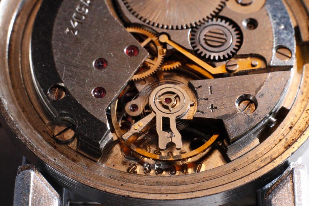

Sorry chaps could only find 2 soviet 2400s in the russian tub and both had the shock springs missing, but heres a picture grab of one and 2 two seiko springs for comparison with 2 moving tools. The jewel picker is great for moving springs, this is the smallest available , shame there isn't a smaller one. But you can make your own wooden jewel picker ( condomed tooth pick ) of any size. Shape a toothpick to what you want and then dip it contact adhesive, set to dry for 2 hours , i like evo-stik. 🙂

If I remember correctly, the most convеnient tool for Slava 24 shock absorber springs is a refill (tube) for regular pen. Use the tube to turn the spring in no mater which direction until one of the arms gets out thru the cutout. Then grasp it with tweezers and just remove the spring. No need to turn it any more, the other arms will get out when they get to diametrically oposite parts of the circle. Putting the spring back is in the reverse way
