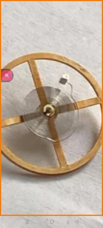

Here is a picture of a new balance complete (taken from an eBay ad). This shows the outer coil how it is stepped out from the rest of the coils. The terminal curve steps in roughly in the centre of the quadrant opposite where the stud is.

Here is another eBay picture showing the hairspring as flat.

Guys, demagnetising this spring is like empting empty bottle. First of all, it is very hard, almost impossible to be magnetised. If it is sticky, then it must be cleaned. Usually hexane or generally pure petrol helps. If one can't obtain such materials, then He can distill some A95 petrol from the petrol station. But, sometimes petrol is not able to clean some sticky stuff and then pure acetone must be used. And, the heavy artilery - boiling in stuffs like NaOH. The last thing for sure will destroy the shellac if it is used to fix the imp. jewel, but in 2609HA there is no shellac there.
Now, if the hairspring is not sticky, then it is bent and needs to be rectified. I mean not the terminal curve, as it is a piece of cake. It is twisted - then find the place which is twisted, grasp it between two tweezers and twist in in the oposite direction in order to untwist. What i mean is the concentricity of the last 2-3 coils, as they are touching each other. The terminal curve for 2609HA is correct on the shown picture from internet, but there is little problem there - the curve must be on the same distance from the main body of the spring from it's beginning to the end.
