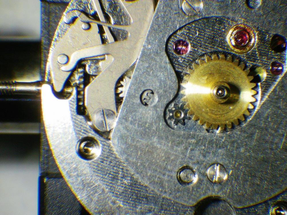

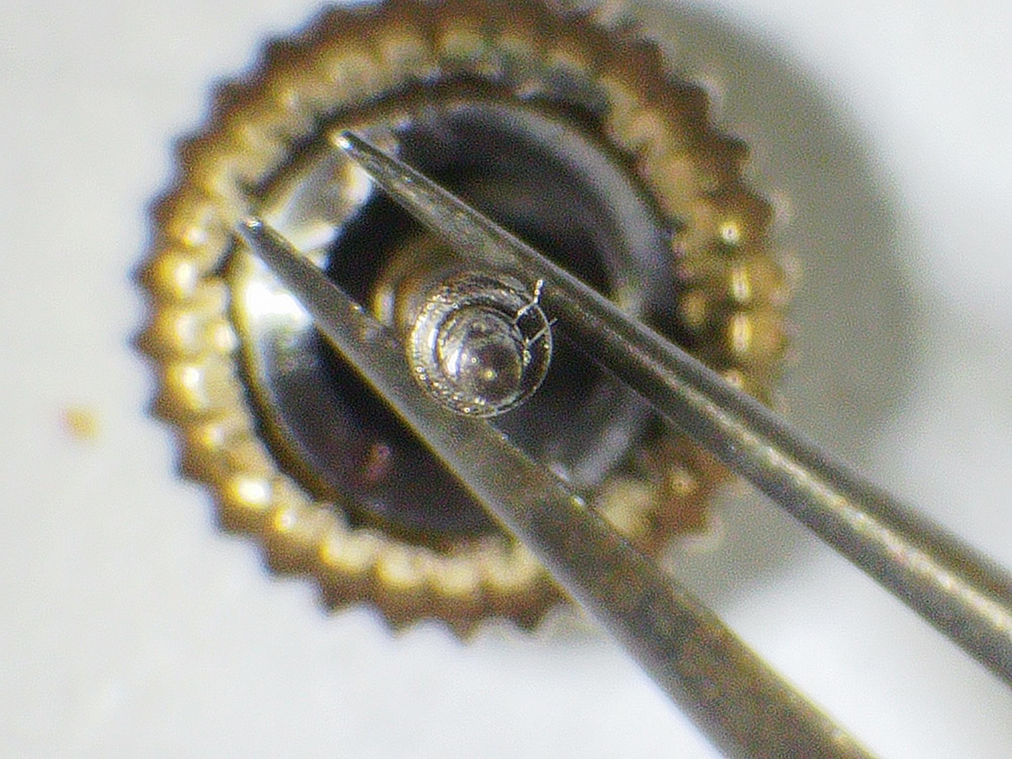

I'm out of ideas to fix this issue! The stem won't install and wouldn't stay engaged when I had it right, I thought. This is a Seiko A201 Sportsman (vintage 1960-80) movement. I serviced it and had everything working, but then after casing and completely finished (naturally) the stem started disengaging. I set the time once and everything worked before the stem came out when I pulled on it to set the time and then couldn't get the stem to stay in. The watch had never been serviced and the stem worked when I got it. Here's what I know: the winding pinion looks good. No broken teeth or bends. The sliding pinion is fine. The yoke sits in the sliding pinion groove. The setting lever works and the spring release also works to release the stem, at least it did when it was working. The yoke "spring" is engaged properly with the small nubs on the setting lever. The setting wheel works. I tried it in both up/down directions. The minute wheel is good. I'm not sure about the stem itself. It might be bent ever so slightly at the tip. It's hard to tell from a photo. What it does: the stem won't seat all the way unless I take out all the yokes/spring yoke. I wound the mainspring a couple of times before the stem stopped working (disengaged when I pulled on it), so the click works. I did have an issue with installing the mainspring case top upside down, but fixed that. I'd try a new stem if I had a match. I suppose I can find one. Any advice will be appreciated. Thanks.

The setting lever is not in the stem pullout slot here.

Progress, but not quite there! I thought it was fixed when I made the adjustment to the setting lever. I left the stem in and screwed down the yoke and spring part. Everything worked perfectly. I could pull on the stem and the setting lever worked, setting time, etc. The stem did not come out. After assembly of the dial and hands, the stem is in all the way but it only turns the hands at the innermost position and pulls out all the way, only, when I try to set the time. I can't wind the mainspring. I pressed in the setting lever nub to insert the stem. I'll take off the dial/hands again to troubleshoot, but could use some suggestions. THANKS.

Once again, I have the keyless works working minus the dial and hands, but I'm not sure about how to remove the stem for casing the movement. Do I pull out the stem and then press the set lever screw nub to release it? Or just press the release nub and pull out the stem. Also, what's the procedure for inserting once the movement is cased. I've never had this problem.

Yes, I can adjust time and wind. After I withdraw the stem by pressing the set lever spring I can't reinsert the stem fully unless I press in the set lever spring, and then the stem goes in fine. The set lever blocks the stem and the only way to insert the stem is by pressing the set lever spring (in other words the set lever screw). Is that normal? It should work the way it is, but last time I tried casing for some reason it didn't work and only allowed me to change time, not wind.

Try removing the stem in the setting position and then re fit to check that everything still works OK.
Andy: Now the stem won't go in. Also, one of the setting lever nubs is out of position.

So at what point did the setting lever go back to the winding position and the spring jump out?
Upon withdrawal, I think.
Sorry but I'm at a loss as to why the lever won't stay in the set position when you remove the stem.
On the same principal I don't understand why if the stem is actually removed in the wind position why you can't just replace it.
I presume all the other wheels are installed correctly as you've had it changing time and winding.

What does the movement look like from the other side where the set lever indent is?

I reinstalled the stem by pressing on the setting lever spring. I also figured the stem should go in without having to press the setting lever spring. That's the issue. I pushed hard on the stem, and anything harder would not be normal. The stem inserted properly with the spring pushed down, clearing the setting lever spring nub, and works fine. I'd like to know definitively why the stem won't insert on its own before proceeding. Photos show stem pulled out for setting time and the setting lever spring nub side. Thanks

Thanks Richard, Andy, and Neverenough! It's cased and working. My process is to pull out the stem to "setting time," then removing the stem by pressing the setting lever spring. The case is cheap and funky, which contributed to my difficulty. I had to press hard to seat the stem while pressing down on the setting lever spring (I prefer the screw). Maybe the stem could be a mm longer. More later.
