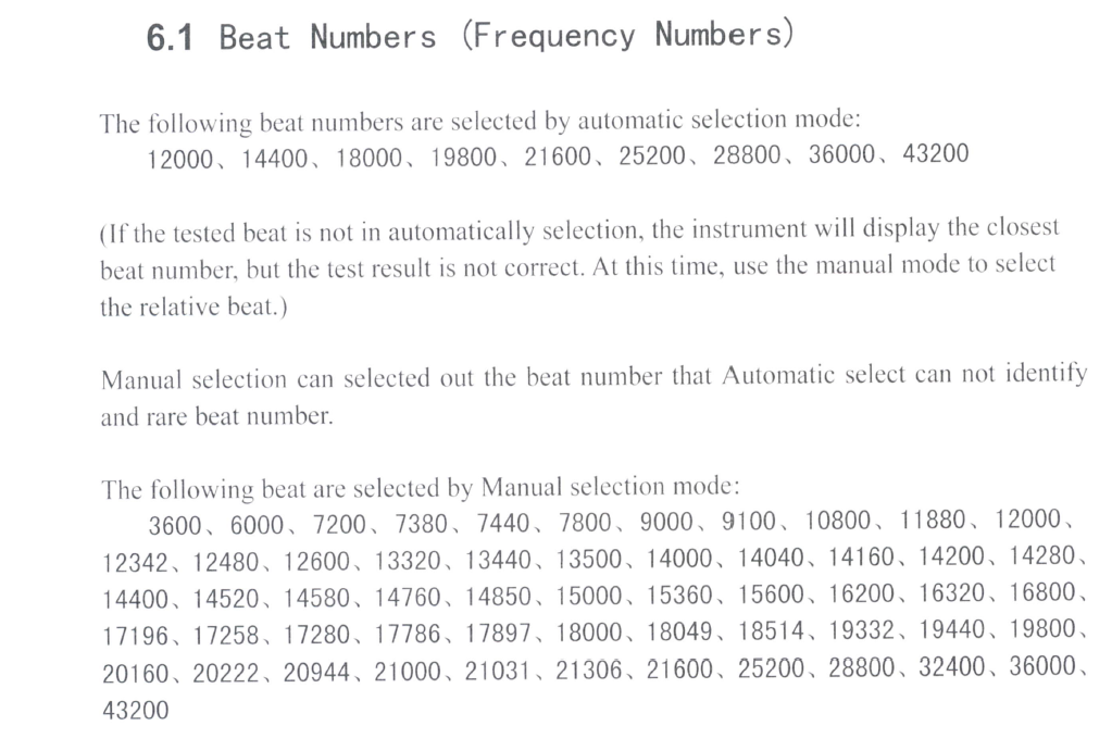

Continuing my watch fixing journey, I bought a cheap pocket watch off ebay. Turned out to be a jewel-free cheaply made affair, but it ran. I’ve managed to dismantle, clean, and rebuild it, and it’s running well, at least to my eye.
On the timegrapher it’s another matter. Massive beat error giving a snowstorm effect. To my musical ear it sounds regular, but the timegrapher beats 31 times before pausing and starting again. The watch doesn’t stop and continues ticking away.
Are timegraphers a waste of time with pin pallet escapements? There’s no second hand on this watch. Any tips on regulating it (the balance has a regulator arm)?
Generally there is no reason why a TG cannot test pin pallet watches. But some use lower beat rates than 18000 that are not included with cheap TGs 😀. Maybe that is your problem.

Hi Doc,
@praezis is correct, no problem to test pin plallet watches on timegrapher. The problem probably is that the timegrapher doesn't support 17280 beat rate, and this beat rate is common for almost all of Roskopf watches. I will advice to use Clock Tuner app for android, the free version. It will accept manually set whatever beat rate You need.

Auto setting work just fine for 'modern' watches but it's highly unlikely it's going to be a 'standard' frequency for an old pin pallet pocket watch.
If you know the movement then you should be able to find the frequency and lift angle to suit.

Yes that does list lift angles but where the antique watches? There is no vintage in the list because vintage occurred before the newfangled timing machines that needed a lift angle.
OK, we speek about antique watches. Those about 120 years old and younger usually are with 18000 BPH.  The cylinders too. Exclusions are Roskopfs. 'Chinece' crab-leg duplex and  almost all dead seconds are with 14400. Older Engliish lever and Amreican watches which are full plate with big balance on top, usually have 16XXX BPH and it is needed to count hte teeth. There is second hand, so no other teeth count needed but of the table and pinion of escape wheel and the table of the seconds (4th) wheel. Americn watches are well described and one can easy find BPH in different websites. Lift angles can be measured, but why one will need them? To read the amplitude??? If one will need timegrapher to read the amplitude of a pocket watch, then keep away from such watchmaker and find beter one with more experience.
The verge movements are different and there is great variety of BPH, especially in english ones. The french watches, especially later ones and repeaters, will usually have 18000. But one never knowos untill teeth count is done, so don't forget to count the teeth untill the movement is dissassembled. This is only needed for timekeeping adjustment if the hairspring is replaced or in similar cases. The timegrapher traces of such watches are 'terrible', so less sensitive (with smaller trace slope) adjustment is needed. Chinese timegraphers are useless here. Clock Tuner app performs great with verges.
