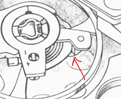

32 minutes ago, nevenbekriev said:
Just in case You didn't notice this:
20240101_004114.thumb.JPG.9b10e1f462671e139f59c65c8d06cb42.JPG.a6006e0e0364be8758bd3c247c4a8252.JPG
The jewej is broken and no wonder, the decision of the movement designer is a little strange here.

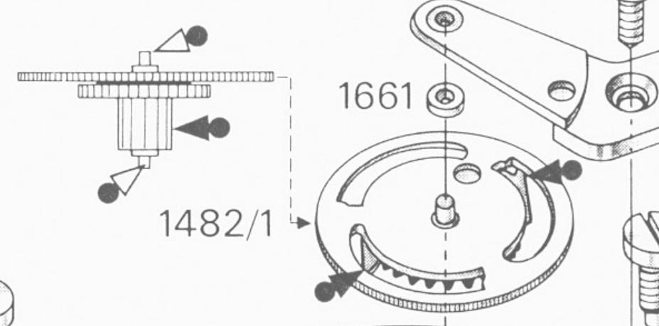

Hi @nevenbekriev, thanks for having such a close look.
But it's actually all how it's supposed to be. It may be an optical illusion. These a 2/3 circle brass bushing on the lever itself and a full jewel on the plate below.
The pic from the manual will clarify:

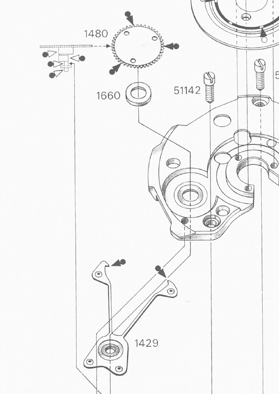

I have two questions:
1. lubrication of the "driving gear assembly for ratchet wheel"
The manual only prescribes lubricating the clicks and the pinion with grease (and the pivots of course):
But this guy also lubricates another point (https://youtu.be/LmHqj5RMXqk?si=Mg5D7U0DEt_xf_MK
What do you think?

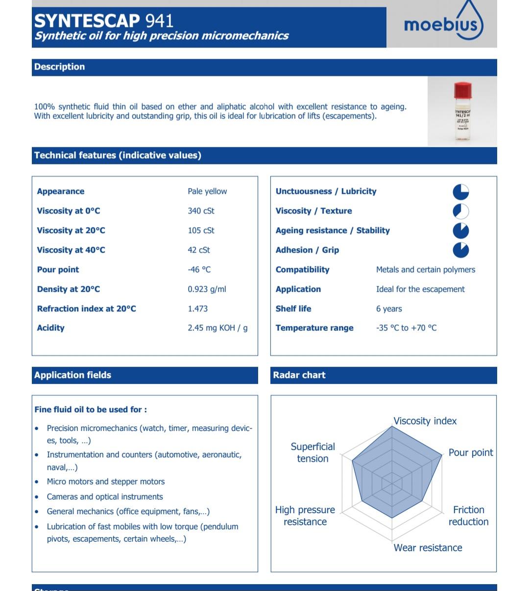

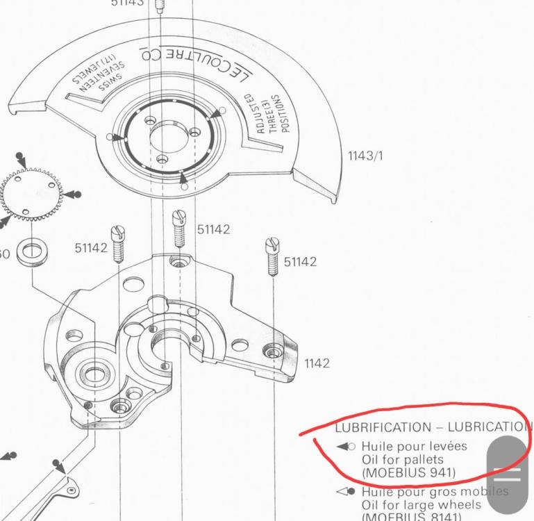

2. Cleaning and lubrication of rotor ball bearings. From the service guide:
a. Would you follow this cleaning approach instead of my usual L&R No111 (ammoniates watch cleaning solution) and L&R No3 (watch rinsing solution, two cycles)?
b. Would you use Moebius 941 for the balls?? First time I see this in a manual? Normally, I'd either use 9010 or Lubeta V106. What do you think?
A few thoughts on my own question 2b.
9010 vs 941:
Screenshot_20240617_224955_OneDrive.thumb.jpg.ee2044c5c84b2811fc4b973e2b1ba2eb.jpgScreenshot_20240616_002156_OneDrive.thumb.jpg.dc56508f58be5216a1c99e836b97bd18.jpg
The two are quite similar if you look at the tech sheets (and look past the spider charts). What I find weird is that the spider chart seems to indicate higher viscosity for 941, but the actual numbers are higher for 9010 at all temperatures.
From this info, I feel like going for 9010.
However... why does JLC recommend 941 if 9010 already existed and was even used elsewhere in the movement??

I follow your walkthrough with great interest!
I'm not sure how I would do it but still think I would try to follow their recommendation. My only question is how do you practically go about quickly rotating the rotor in the benzine?
I would follow their recommendation. Oiling correctly is often an underrated art with far greater consequences than most people realise. I don't think it's a coincidence that JLC recommends 941. That said, in this particular case, I think you can safely use 9010 if you don't have or don't want to invest in 941.
Yes, it is undeniably strange. Maybe the explanation is that there is a difference between viscosity and "viscosity index"!?
I understand that 9010 is a much older oil than 941. I guess JLC has found through practical experiments that they get marginally better results with 941 for just the rotor bearing, but who knows?

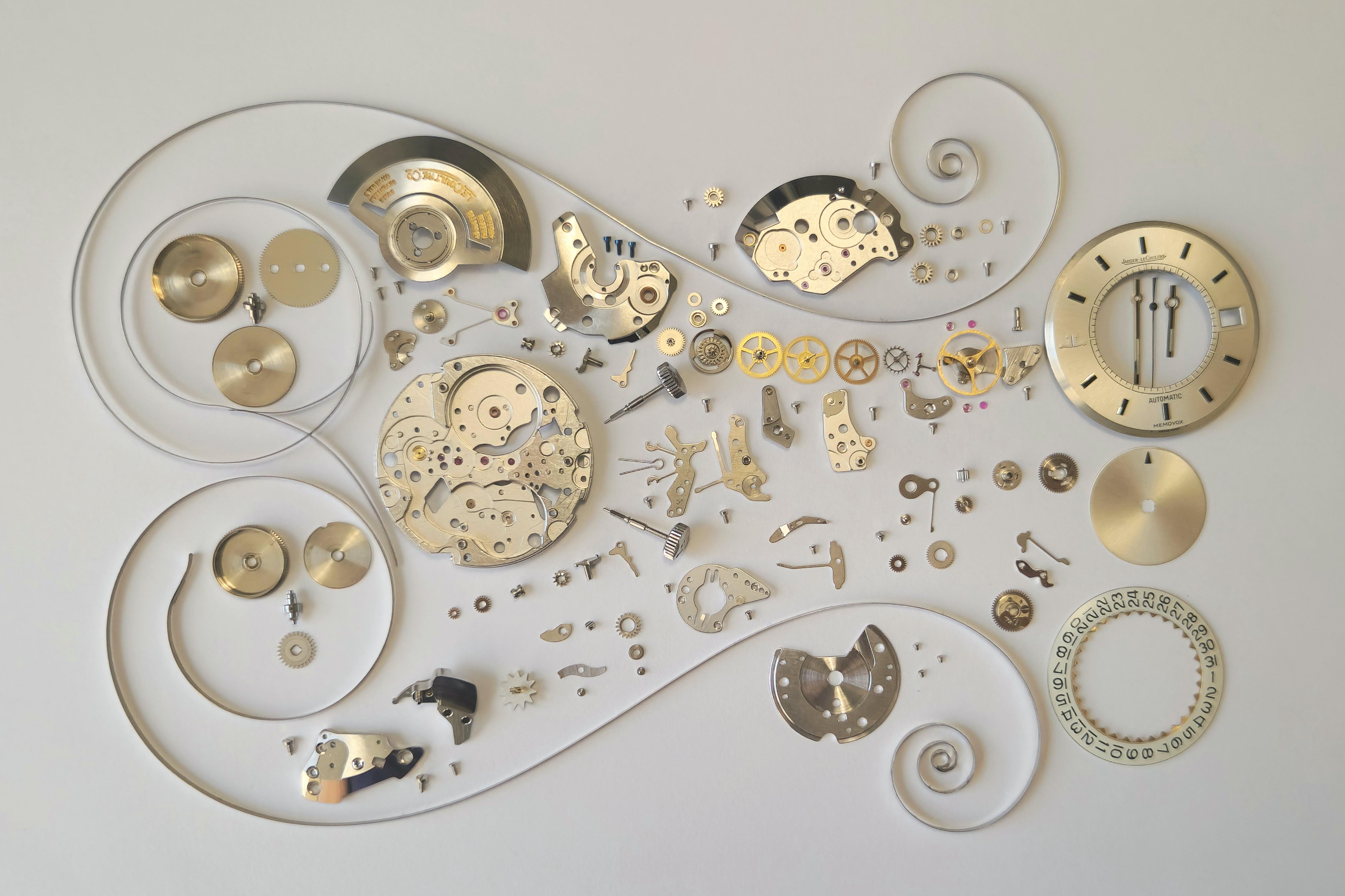

After cleaning, here's my usual "movement art" picture.
Assembly coming later..

I forgot to mention and you may already know this but whatever oil you use for the ball bearing, you should apply a minimal amount. Otherwise, you risk inhibiting its free movement.
Thanks @VWatchie. Yes, I know.
Now I am wondering if I should go with 9010 or a bath in Lubeta V106 (I have it and never used it...).

I let it run without lubrication on the pallet jewels to scrape of a channel of the epilame. Then I remove the balance again and lubricate the pallet exit jewel 4 times.

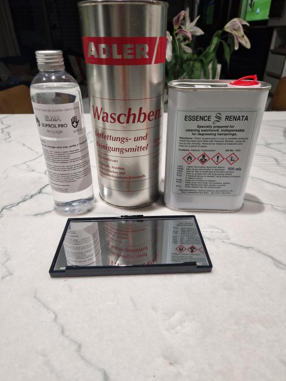

The manual asks for a particular cleaning procedure:
I wasn't sure if it's necessary because my cleaning procedure already cleaned it in the ultrasonic and with ammonia liquids.
So I did a test. My three cleaning liquids lined up (from left to right): Elma Suprol Pro RINSE (i.e. the last liquid in my cleaning cycle), washing benzine, Essence of Renata.
All applied to a my wife's makeup mirror (don't tell her!!!).
To my surprise, the cheapest of the liquids (the washing benzine) leaves the least residual. Essence of Renata, shockingly, the most.

The regulator is a bit unusual...
The method of regulating is the same as always, though. BUT I ran into some confusion.. I managed to regulate it pretty much to 0sec/day (and 0.0 beat error). But when I can back an hour later, the watch somehow ran at minus 30sec/day... very bizarre. I repeated the regulation. Same phenomenon an hour later...
My theory: since the "buckle" is in permanent contact, there may be a bit for friction between it and the hairspring. So, when moving the regulators "buckle", it may pull the hairspring along just a bit. Thus, "pretending" to be regulated to a certain rate.
But as the hairspring oscillates for an hour or so, it gradually moves to the actual permanent position of the regulator buckle. In this process it moves from 0sec/day to -30sec/day.
Consequently, I intentionally regulated the watch to +30 sec/day. And waited an hour.
And yes, what a pleasant surprise, it ends up pretty much dead-on.
I can't say for sure that my theory is correct, but at least I know that there's nothing really wrong with the regulator.

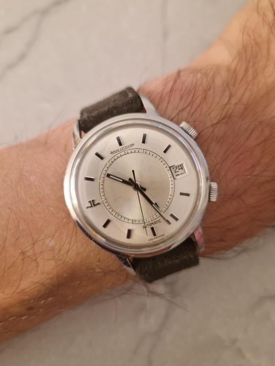

And here is the final product (also with a new crystal)

A quick follow up on one question I included in last night's post. About the lubrication of the seconds wheel.
As indicated in the manual, I only lubricated the thicker point indicated by the green arrow. NOT the one with the orange arrow (also thicker part, closer to the pinion/wheel. But should I have?
After some thinking, I believe/hope that the extended seconds pivot only touches the inside of the center wheel where I indicated it with the blue circle (bottom of the picture). If that's true, it makes sense to only lubricate the specific point with the green arrow.
This guy, however, also lubricates the upper part (orange arrow): https://youtu.be/LmHqj5RMXqk?si=G79SyuxK0-5fHHYL&t=1163
