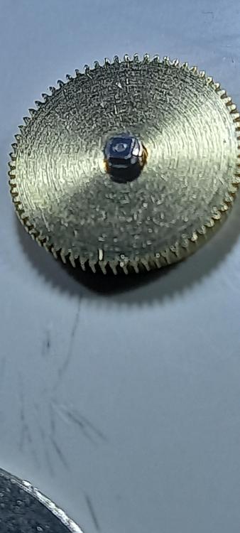

There's a first time for everything,  broken pivot on a barrel arbor, granted it looks quite small and feeble, in a plate jewel as well  EB 8021N . Been running like that for a while looking at the wear on the plate. Typical all cleaned and ready for assembly, new balance staff fitted trued and poise checked.  Check all the watch parts people before you start cleaning and find the irreparable repair first 🤨. Looks like me and the lathe will be getting reacquainted tonight 🤷‍♂️
0.3mm hole drilled which was surprisingly easy and went a whole lot better than i expected considering i did it free hand with a carbide bit in a small pin vice,and no breakages. I only have some 0.34mm and 0.5mm blue steel so my plan is to open up the hole to 0.5mm and reduce the pivot down to size to fit the plate bearing before fitting it in the arbor.  I'm not entirely sure on the hole depth, my head is tell me 3x the hole diameter .

Go and drill with 0.4, then finally turn the piece to size untill it fits the hole. Don't worry, if something happens, You can turn new arbor.

I dont have a 0.4 mm Nev or i would have.  Turn a new arbor 😲😵 me thinks you overestimate my ability Nev 😅

  On 6/13/2024 at 7:40 PM, nevenbekriev said:
Now don't hurry to enlarge the hole to 0.5. Hope I am not late saying that.
Expand
No i haven't started to do that yet Nev, i wanted a bit of feedback first. I think you're  going to tell me to turn the pivot hole spigot down to 0.3 , i thought that would be too small and weak though
Enlarging the hole is dangerous and it is almost sure that the drill bit will break inside and it will be hard or even impossible to get the broken pieces out. 3X diam is enough. Just prepare the piece that will get in the hole in a manner that it will have 0.3 X10 part that will enter the hole and wide part that will be outside and will be able to turn it tio size.

I knew you would say that, i was thinking the same , i wasn't particularly happy about opening up the hole. Should have gone with the 0.5mm to start.  On the positive side i now know i can drill a hole for a 0.3mm pivot, looking at it through x25 while i was drilling it looked MASSIVE 😃
I think that if this is a spring wire like piano string or similar, it will not break and  wili be srong enough.
What You could do is to drill straight with 0.5 . Then it would be beter, but now it is good enough to do it with 0.3.
See, the watchmaking is actually a piece of cake, just some practice and skills to develope needed and to believe in own strenghts

Yep my thoughts the same,  i realised i slipped up with the smaller drill half way through. Out of curiosity if you had to widen a hole, could it be plugged and re- drilled ?

See, the problem with widening to a little bit wider diam is that the bit will 'grab' too much at a time and will get in too fast by itself, then it will stuck and break imediatey. If enlargening from 0.3 to 0.5 needed, complitelly different drill bit must be made - it must be similar to the ones they use for weapon cannons, with one cutting edge and with angle that will not cut fast. The other option is to enlarge the hole like they do on big lathes with cutter for internal turning, that will be small enough to get in the hole
The idea with the plugging could work, but I haven't try it. The pug should be only a little bit softer than the piece and must get in completelly to the botom of the hole.

It wasn't a rookie mistake Nev , i should have know better with me being a joiner. After a hole another a wider bit has nothing to keep it to center and the outside of the flutes draw the drill bit in fast because of no material present. I must have done it thousands of times in timber and plastic . It was a senior moment mistake. 😄

Besides locktite Nev, is there anything random that you use to fix in the pivot ?

If it is press fit will hold by itself. I put then loctite 'just in case'.
Sometimes press fit is not good idea, as the walls of the part are so thin that it will break if the pivot is pressed in. Then just tight fit is used and loctite to fix the pivot . Loctite 638 is what I use, it will harden fast if the junction is tight fit and werry slow or never if there is free play. Heating to 200 degr. celsius for a while helps to reach max strenght.

No matter how hardened the pivot wire is, a carbide cutter will be able to cut it. Only the time when it is sharp enough to cut well will be much smaller if the wire is werry hard, than if the wire is softer.
The secret of successfull turning is that the cutter must be wery sharp and well polished. But this is not enough, as the correct position and angles against the object are of the same importance. One will need practice to find the correct position of the cutter. Looking at the pictures in the books is usefull, but one must feel the moment when the position is correct and to understand when the cutter tip breaks and learn to avoid this situations as much as possible. Do You remember how not long ago, You didn't believe that this drill bits can be used? This is the sane with the carbide cutters, I asure You that it is possible to turn hardened stil with them and soon You will be able to do this.
Must say that I don't usually prepare the piece to enter the hole by turning. I use guitar strings and have different sizes - 0.22, 0.25. 0.28. 0.3, 0.35...  I drill the hole little bigger than the needed pivot size and thus have the chance to correct eventual small centering error in drilling when turn the pivot to size. I use string that is the first in the row that will not enter the hole and reduce it's diameter by grinding with diamond disk by hand while the wire is in a pin wise. I do it in a manner that the string will get wery slightly tappered until the tip of the string will enter the hole. Then I shorten the tapered string little by little untill I get the correct size for press fit or tight fit.

Thanks Nev , i really appreciate all that information you have given me. Yes i fully understand what you say about the sharpness and approach angles for the gravers and developing a feel for the cut. I used to turn timber years ago the principles are similar especially aquiring the feel for turning. I think now that the graver was not sharp enough. I play the guitar so I may try your method with the guitar strings , thanks again Nev 👍
