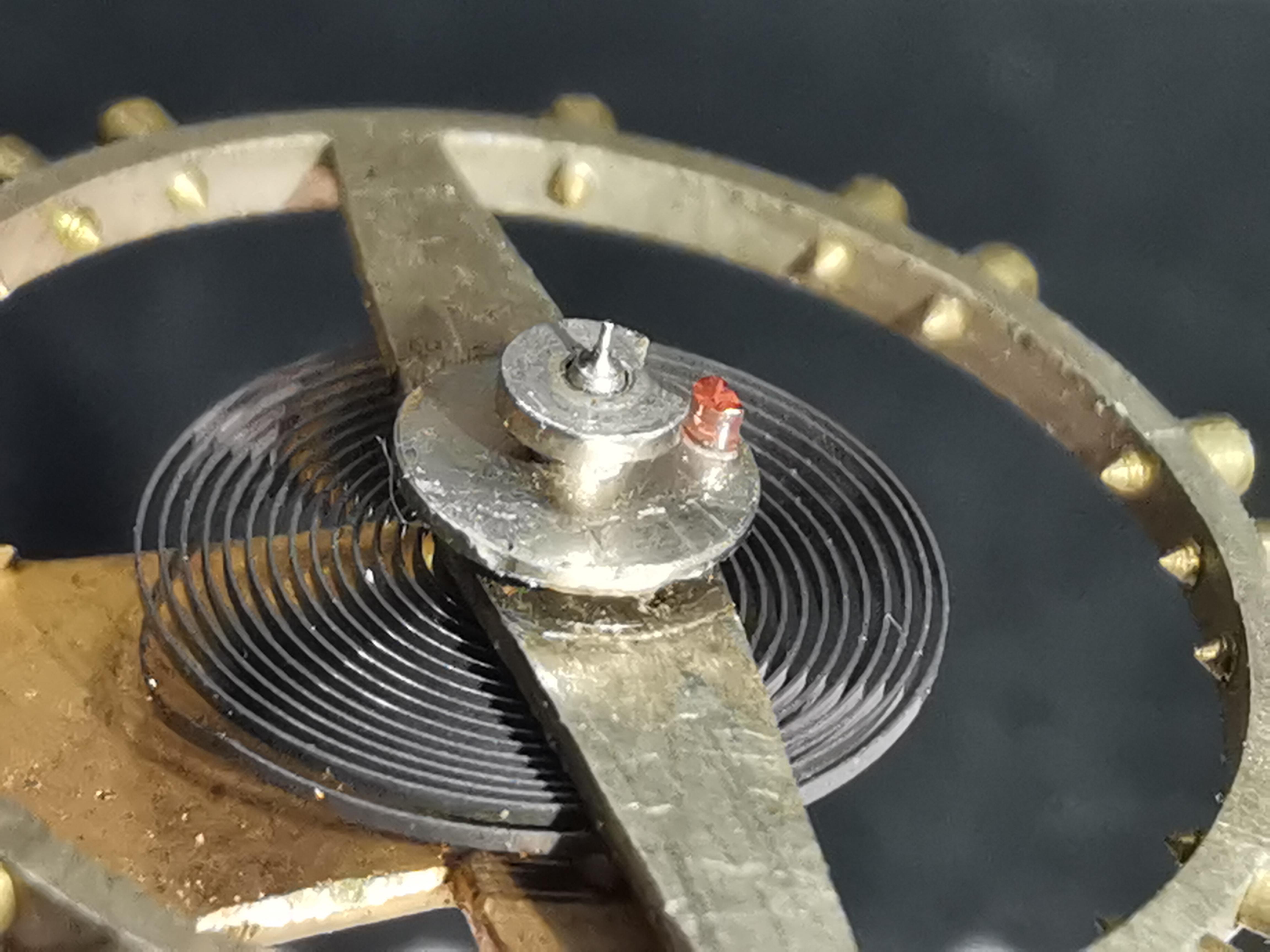

See, You give too little information. I asked many things and still have no answer. So I can only guess. Speaking of this, I red once again everything in the tread and saw something, which can be interesting.  As I understand, the old staff which has broken roller side pivot (only one broken pivot) measures 402 in lenght. One broken pivot will shorten the staff by about 30, so in every case, You original staff was no longer than 440.  As the 588 staff which is long 475 fits and even there is big axial free play, this will have to mean that the balance that was in the movement actually is not original one, but just put by the previous owner in the movement to ease selling it to You. This means that the roller is not from this movement and in such case, it is no wonder that it touches the main plate.
Do You know how to check if the roller can work together with the pallet fork correctly?
Expand
Hi there sorry if I wasn't clear in my replies...
Both pivots are broken on the old staff...see photo....so going by your experience it would add a further 30 so making the old staff 470 long... please note my measurements will have a tolerance of error.
I'm guessing this is about the same as the 588 staff which measures 477.
I don't know how to check the roller/pallet fork .

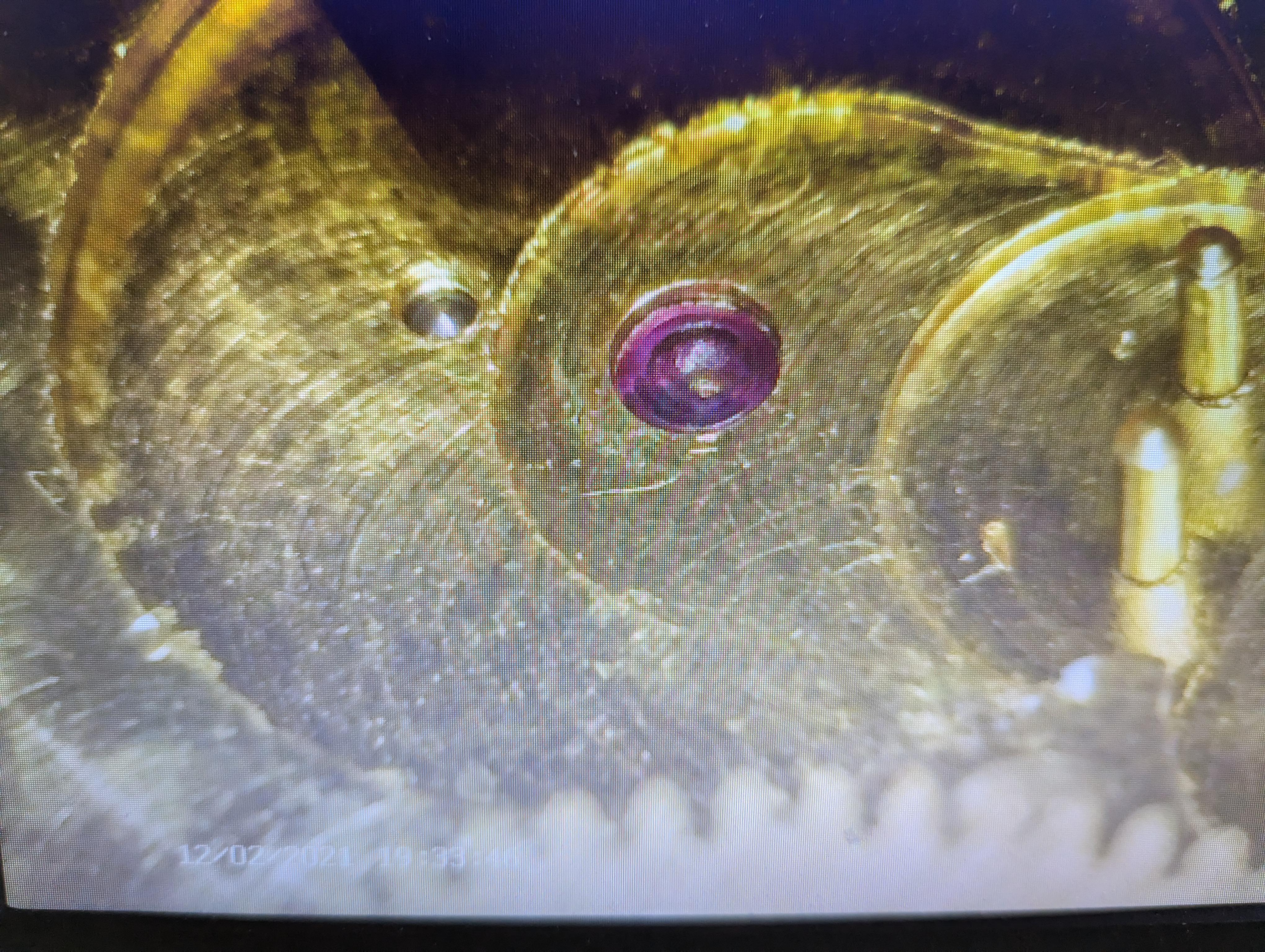

These are the best I can get with my camera phone.
Edit
Looking at your jewel compared to mine it would appear the staff has worn the hole in it after the pivot breaking.
Edited by AndyGSi
Edit
Expand
Yes I would agree....I'll take some photos later of the roller table on the balance and a better photo of the bottom jewel. ..👍👍

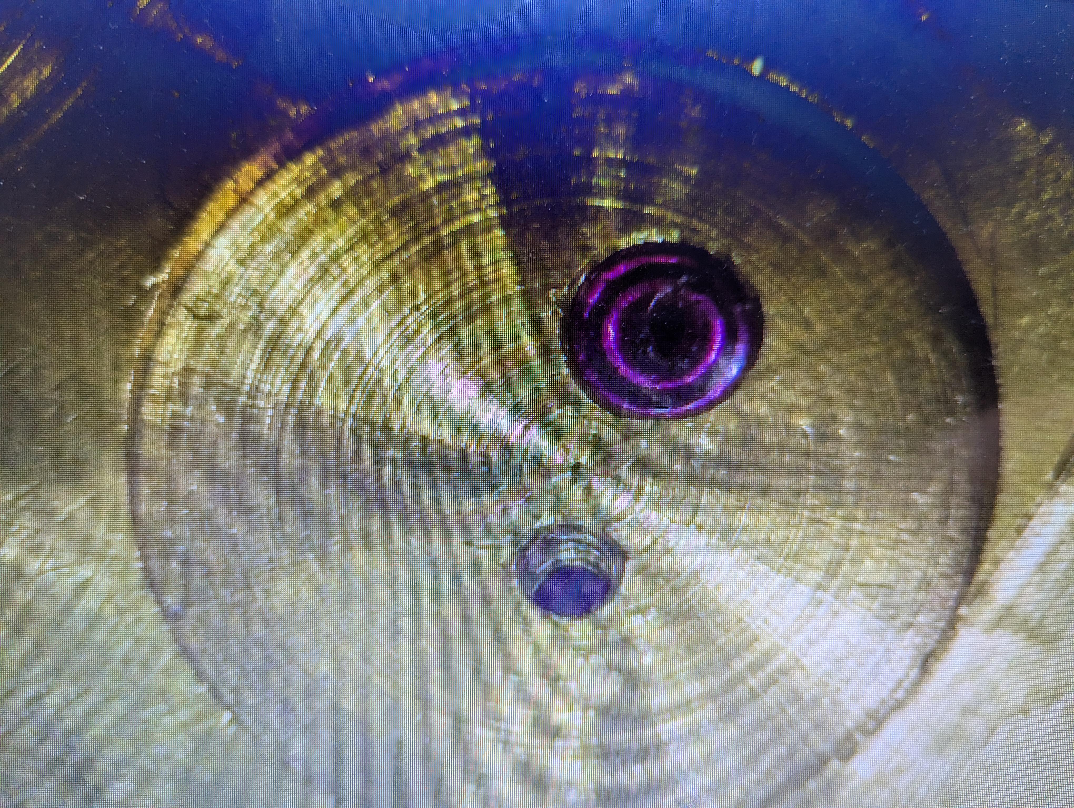

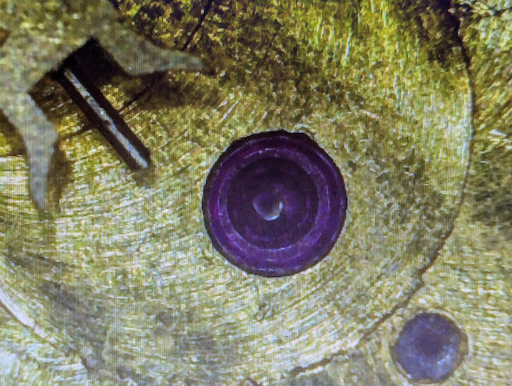

Hi all another update and some photos to answer a few questions I received...
The cap jewel plate is flat and on inspection looks perfect.
The hole jewel looks like it's been pushed a little too far away from the balance.... thoughts?
So when I have a few moments spare the hole jewel is coming out and replaced.
Expand
  The shock that broke the pivot also damaged the hole in bottom jewel, and pushed the jewel down away from the balance.
Obvious !!!   replace the jewel with new, adjust it flush level with mainplate.
