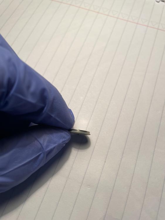

I'm having some issues with this recent restoration. I came across a new type of barrel I don't think I've seen before. It has this weird line going down the middle of it. And on top of that, I can't seem it get it to open. I think that it shouldn't be this hard and I think I'm doing it wrong. I really need help on this, I have no clue how to get it open. I also noticed that a little bit of water or something got into the mainspring barrel, because there was a little deep orange-ish rust right around the arbor and I think it creeped into the barrel. Could be why it wont come undone. Any help is appreciated.

Perhaps it’s a trick of the light but it looks like one of the barrels teeth is broken off or damaged. PS what is the caliber of the watch
This looks like a Seiko mainspring barrel, I am sure there are many you tube videos out there showing how to open those and I'm pretty sure it will be the same technique (see below about 7 mins in). @clockboy I see what you are saying, but agree it's hard to tell if its damage/dirt or a trick of the light.

Yeah, I'm almost sure that that's my fault. Some of the teeth were probably damaged when I tried to open it. The finish has worn off on some and hence the light tricks. This is a Wittnauer movement. I thought that the caliber was the D11KAS1, because thats what it says on the mainspring barrel bridge.
I got it open!
I used the video that Waggy sent. All I had to do was use a razor blade to pry it open.
But with that out of the way, is this barrel still usable?

I only took pictures from this side because the other side does light tricks. I did my best to capture all of the teeth.
