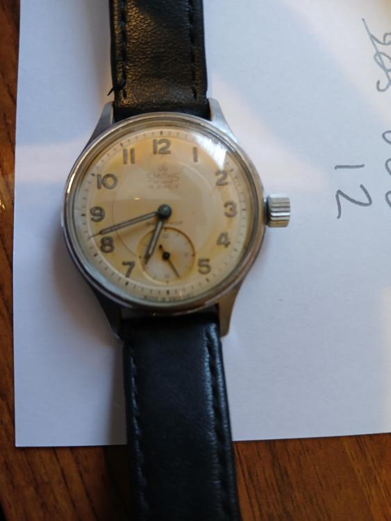

I've been asked if I could replace a crown on a watch. It is to large.
Any one any idea of the movement please? Unfortunately the photograph of the movement is blurred. New phone today and I'm not used to the camera.
Make Smiths. 15 jewel. Markings 606 and 12 underneath. Any help would be appreciated.
Special watch given to a member of the 1960 Duke of Edinburgh Greenland expedition.
Thank you
Ross, the crown has nothing to do with the movement, it has to be with the proper shape and have thread as te stem thread. So, You need to unscrew the existing crown and measure the stem thread, e.g. 0.9 or 1.2 mm. Then see if the case has tube or not, so You will know what type of crown is needed.

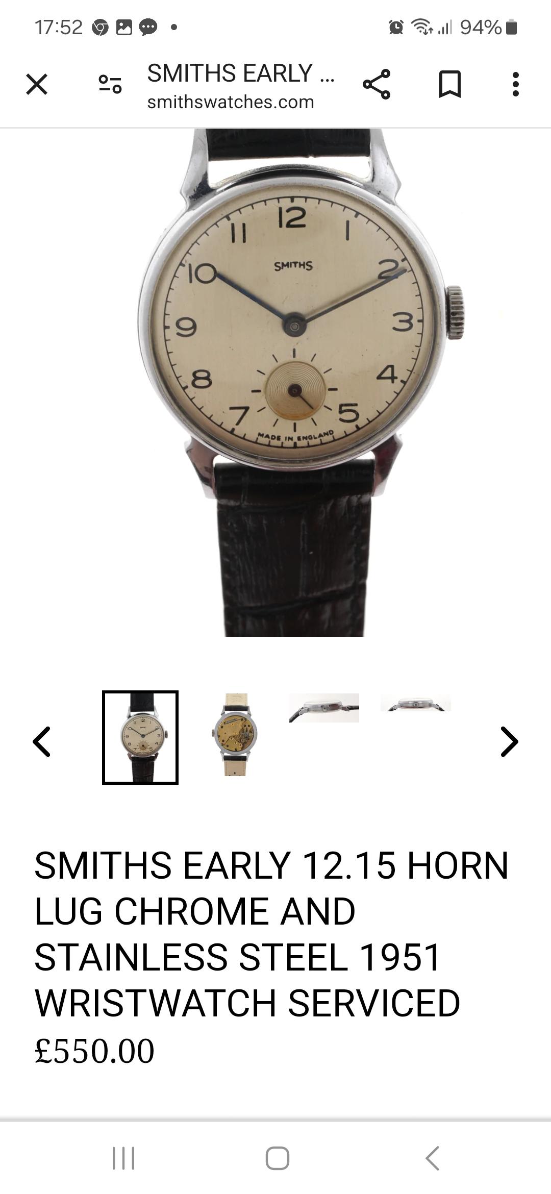

Richard. Thank you. However, 12.15 what? I see that the Stem is a u1630. I will try to obtain a smaller crown if I can locate a movement.
Here you go Ross. This is exactly what the watch is.

Good comment. I'll ask the owner. However, the watch was serviced a few years ago and he made the remark that he remembers the crown as different. Will see him next week.
As per our teaching, I opened the back with an opening tool and plastic on the back. I was appalled to see that someone had attempted to screwdriver the back to open. You can notice the mark on the photograph.

I fitted a new crown. Just a generic one from Cousins
Parts are usually quite easy to find should you have a mishap.

One thing to note Ross when ordering a crown. I have a Smiths Everest and Imperial - neither have pendant tubes, so I needed 'dustproof crowns'  https://www.cousinsuk.com/category/dustproof-watch-crowns
The section around the threaded tube is sprung loaded to form a seal against the case.
I cannot see from the pics whether yours has a pendant tube.
