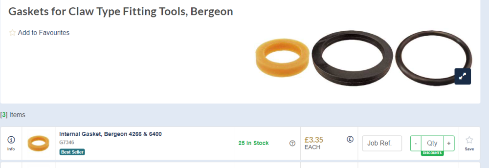

The internal rubber gasket has perished. I had the same problem. Cheap and easy to replace
It’s not a big problem to strip it, clean, lube and replace the ring. It’s the cheapest bergeon thing I’ve bought so far.
worth doing, mine works really well now
Thanks. I disassembled the tool and indeed I noticed the gasket is very tired, I just wasn't sure how big is the impact to the usability of the tool. I will order a new gasket, then.

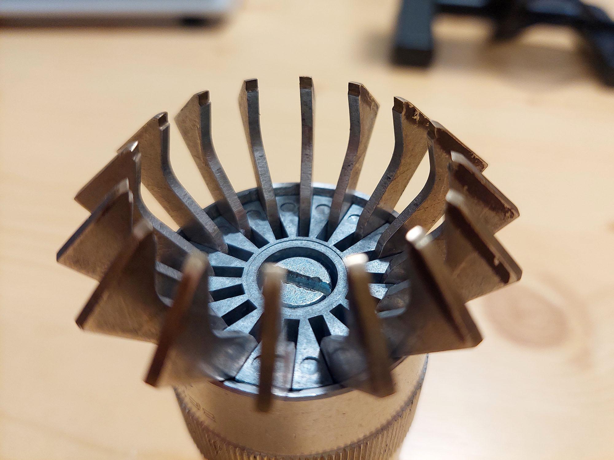

Photos would help.
Here are the pictures. I hope you can judge something from them. The last one is the poor old beater I am practicing with – not the best crystal shape for a crystal lift indeed, I reckon.

The tooth edges look ok. You don't want them so sharp that they actually cut into the crystal. Rather, the force these apply is inward towards the center point of the crystal.
The jig that #Tomh207 shown above is used to allow a space below the lift when using the lift to install the crystal. This ensures that the crystal edge will have enough exposed edge to enter the case edge.
Some crystals will have too much of a slope to allow the jig to put force towards the center without slipping off. Those crystals will usually be able to be removed by hand, pressing them out from below. If needed, a press could be used, gently, to remove the crystal. Reinstalling those crystals may require a different tool than the lift you have. #Mikepilk shows that tool above.
