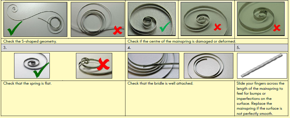

here's an example from Omega from the late 50s where they do give us a clue about solvents why they're bad.
so typically should build just wipe the spring off you might still get stuck with some form of a solvent if the prior lubrication is nasty and sticky. Although it Omega's case especially the newer version they are not worried about sticky lubrication because there shouldn't be any visible lubrication out all.

then here's Omega's recommendations if you're reusing a mainspring  then I can't always follow these recommendations like the first part the beautiful S curve. I've taken a mainspring is out of packages vintage Elgin Hamilton as they both had alloys that wouldn't set and they had beautiful back curse vintage new old stock. But modern spring is made in modern Swiss factories for pocket watches often times do not have beautiful back curves. One of them in particular basically had a curve  for the harbor and more or less went straight out with basically almost no curve at all. Brand-new unit sealed package you get a lot of quality variations. Typically have wristwatches you'll never noticed this because if it's a new spring you're just going to push it in from the ring. The typically a pocket watches they have to come out of the ring and go in either by hand which I do not prefer or with the main spring Winder as you have to get the end to catch. Then when you take the spring out that's when you make the observation of the poor quality of your spring otherwise you would never know.
