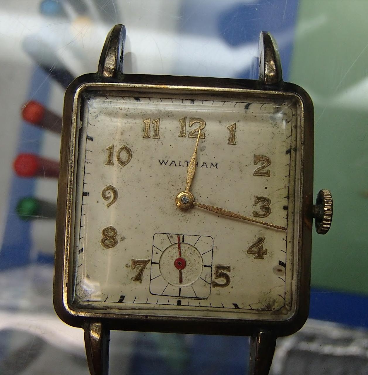

Im working on a Waltham 6/0-C M89983 watch.
Its got a broken staff and I’m in the process of replacing it.  Ive only done this once before, but never with a safety roller.
Does it matter if the safety roller and the roller table are removed at the same time, or should I remove the them separately?

I believe most lever escapement watches have a safety roller. But the definition here is a separate safety roller. It depends upon the tools you are using to remove them. I usually find I start with the roller table itself and as it's coming off it will take the safety roller with it. Well eventually it will not right away and just be careful when you put them all back together that there in alignment sometimes it's a pain to get the safety roller where it's supposed to be. Plus you also want to pay attention often times the safety roller has a side one side is a little different than the other so this pay attention that you might be lucky in that might just have a straight hole but sometimes there's an indent and know I can't remember which ways which I just remember to pay attention when taking them apart

Im using a roller table removing tool and my staking set, my first concern is having a stake that will fit inside the safety roller without getting stuck as I push the staff through it.
Then my next concern is obtaining the correct replacement staff. I’ve already purchased one, but I fully expect to have to buy several before I get the right one.

I use one of these but a good make bradux, something in my head tells me bradux is a subsidiary of bergeon. The cheap indian and chinese are not fit for the job. This lifts the roller free from the staff or at least starts its depart, instead of pushing the staff through the roller, different but same difference 🙂. The jaws need to be thin to get between the roller and the wheel and there is technique involved to stop you slicing a good staff, but worth trying to find a preference.  I also have a seperate tool that works on the same principle as your staking tool accessory but is used free hand. I prefer the Bradux.

Are You sure that the safety roller is separate? Looking at the picture, it seems to me that it is just usual double roller.
I think so, I believe I can see a line between the table and the safety roller, but I guess Ill find out when I get it apart.
OK, The safety roller is separate, and it came off really, really easily.  I don't think I pushed the staff more than .2 mm before the safety roller came loose.
I machined off the swaged staff material and then pushed out the staff. Looks like I also machined a bit of brass from the balance wheel too dang it. Not easy to do perfect.
Still learning big time, but enjoying it very much.
Bill
Edited by BillM

Update;
I have completed the re-assembly of the balance and am very pleased with the results. (First truly successful staff replacement ! )
The staking of the new staff went well as did the reinstallation of the roller table and safety roller.
I have trued up and poised the balance and then installed the hair spring. It took me a few tries, but I finley got the roller jewel perfectly aligned between the banking pins.
The forth wheel/ small seconds pinion was slightly bent and I was able to straighten it out, but we shall see how well.
Re-assembly of the movement is waiting on the new mainspring.
Bill
